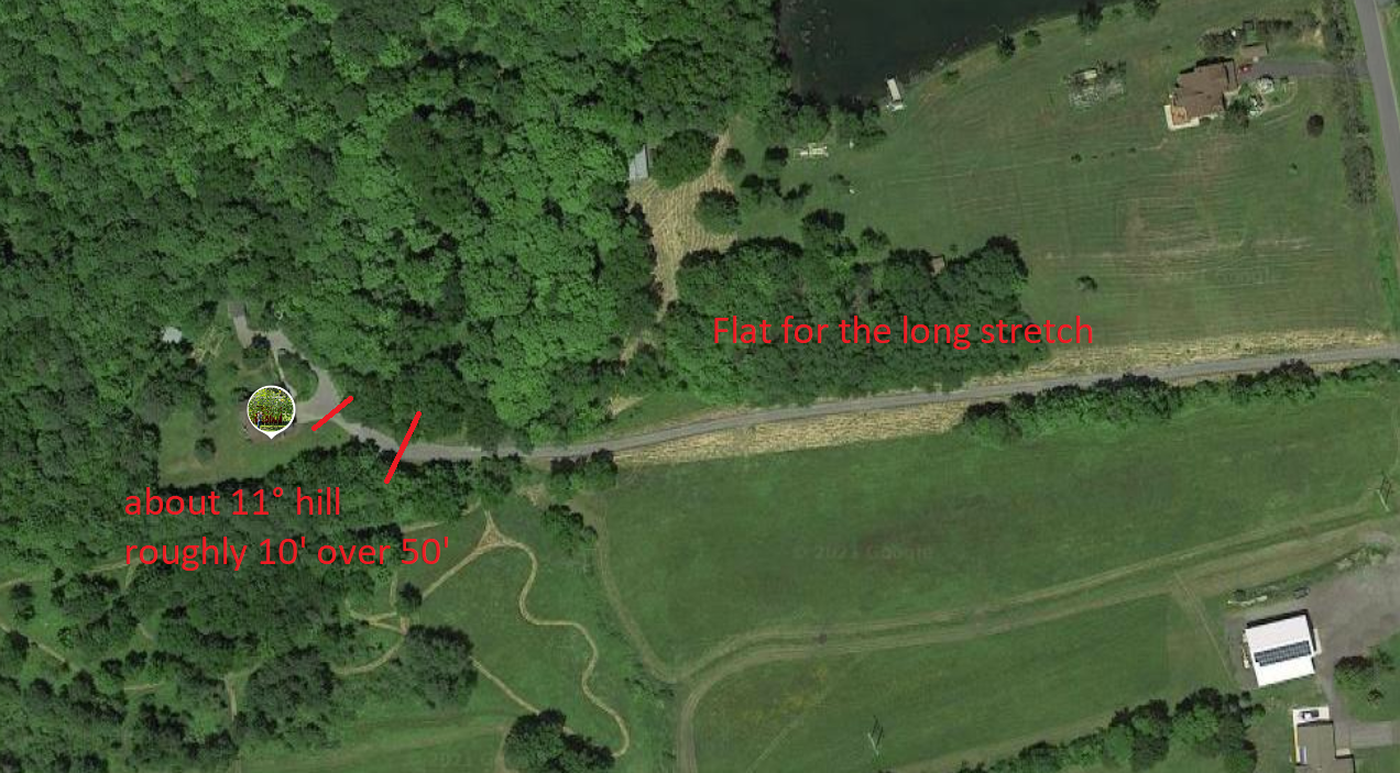

I just bought a house with a 600' long gravel driveway near Albany, NY. I'm looking for a used tractor that will be utilized for snowblowing, general loader use, and a box blade for the driveway maintenance. It's seeming like even a glorified lawn tractor would handle the snow blowing and probably our loader use. Though, i'm having a tough time determining how much tractor hp/weight would be needed for handling the box blade. There is a single hill that is roughly a 10° grade which may increase the size needs? The former owner had a new holland TC33, though i'm questioning if one that large is truly necessary for the tasks at hand.
Anyone have any tips on how to size a tractor for a box blade? I'm not too concerned about blade width/passes, biggest concern is simply being able to pull the rippers without losing traction. Just arbitrarily picking a brand here, but would the kubota bx subCompact line be capable or would the compact B line be necessary?
Here's an aerial, though not sure it has much bearing, but i suppose it makes the post more fun?

Using the rippers probably drives you into 35 hp diesel arena, or more. I've got a 32 hp Kubota which moves gravel just fine with a 5' box, but with the rippers, I can only allow 2 of them into the soil at a time, and have to use 4 wheel drive.

How much snow do you get there at one time? I’d probably be more worried about clearing snow and not taking all day. A BX in theory could perform your task but I think you’ll be disappointed if you don’t get something bigger.
