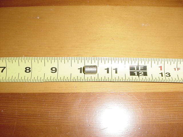

I gave my RTV a bath yesterday. Once the mud was gone, I found a couple things I didn't like. Found a bolt on the floor in the cab area. Seems to be one that holds some of the plastic on. Haven't found where it goes but not a concern yet.
What I did find in the engine compartment, I didn't like.
The nut on the linkage that controls the vertical movement of the shifter (e.g. going from M to H range) was missing. Not sure what would have happened when the linkage actually disconnected.
Laying on top of the transmission, I found a small cylindrical steel barrel (picture attached). There's no holes or anything on it. I can't figure out what it goes to. Can anyone help identify what this is and or where it goes? The dealer installed the speedometer, otherwise, the engine hasn't been touched (other than checking fluid levels).
Thanks
Brian

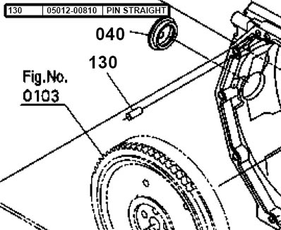

I'm no Kubota mechanic but looking in the trusty parts manual the pin you attached a photo of looks like an alignment pin used between the front case and the engine. I've attached a copy of the illustration in the parts manual. If it is I don't think it could have fallen out once the engine was installed - maybe it slipped out when the engine was being connected to the case at the factory or, more likely, it's just an extra one that landed there during assembly on the line. I had a few new cars with extra nuts and bolts floating around that were dropped during assembly and weren't picked up.

Thanks for the info. I was hoping that it (as well as the bolt and washer I found in the cab) were extra parts.
