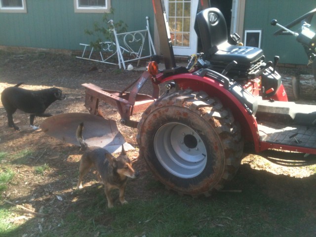

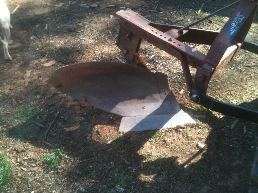

I used one last year with the Mahindra 28. It was used with my old 8n, the Mahindra pulled it fine. Not sure at what size it is but it looks rather large in comparison with the tractor. here are some pic's to give you an idea.
I will note that this tool would lay over so much material, my tractor would bottom out with one tire in the newly formed ditch. The 8n never bottomed out due to it's larger wheels/tires. The low center of gravity is an asset on my Mahindra for all other work, but when plowing - expect the underside to get dirty.
Maybe a little smaller plow would be good for you because your tractor sits closer to the ground, "a good thing".
