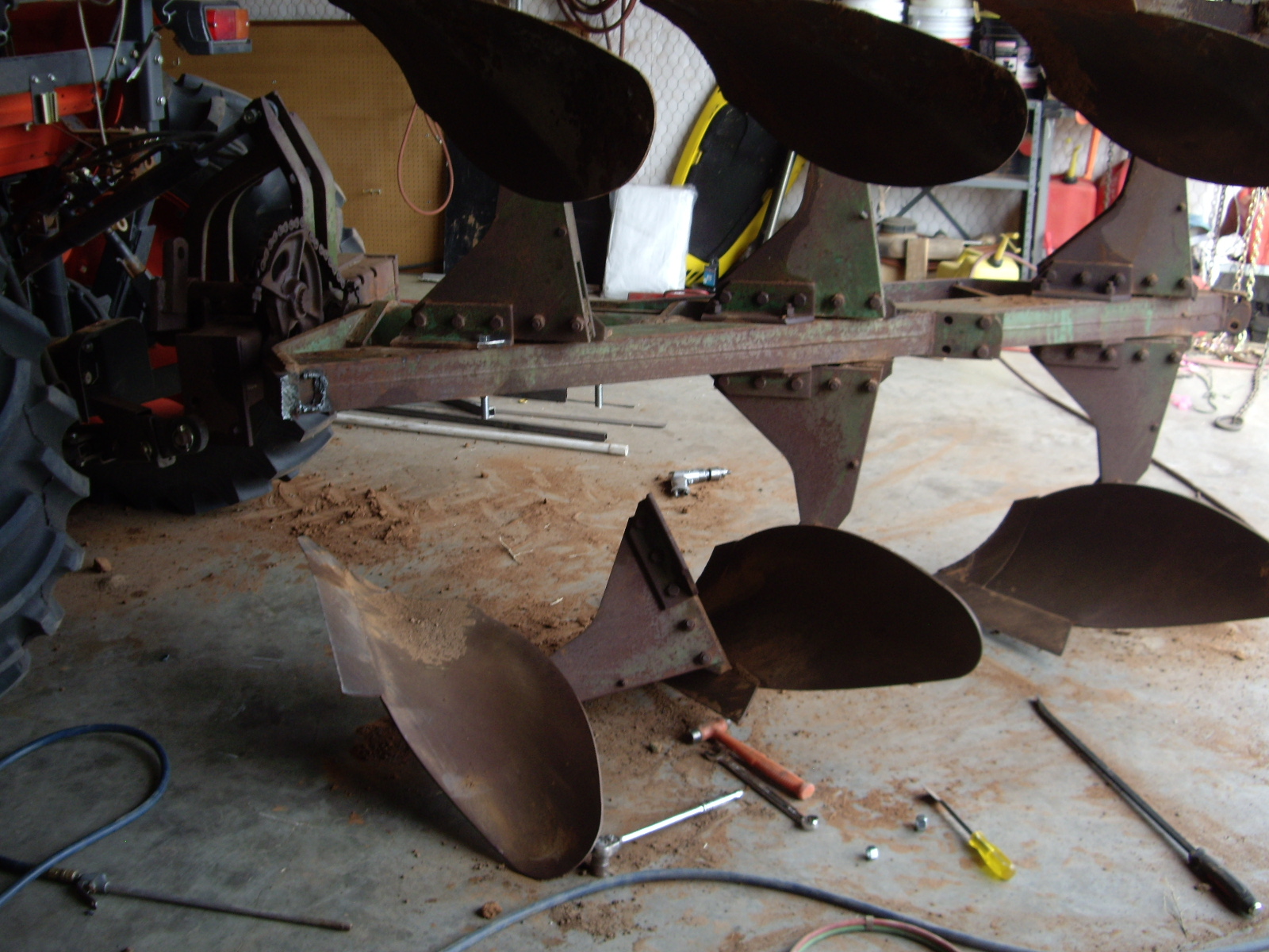

More pics. I thing the oliver rollover is going to work.

A few smashed fingers and a new blood blister, two new holes in my head and one mashed toe and and soon to be obtained new 3x8 hydraulic cylinder and I think I'll be good to go.

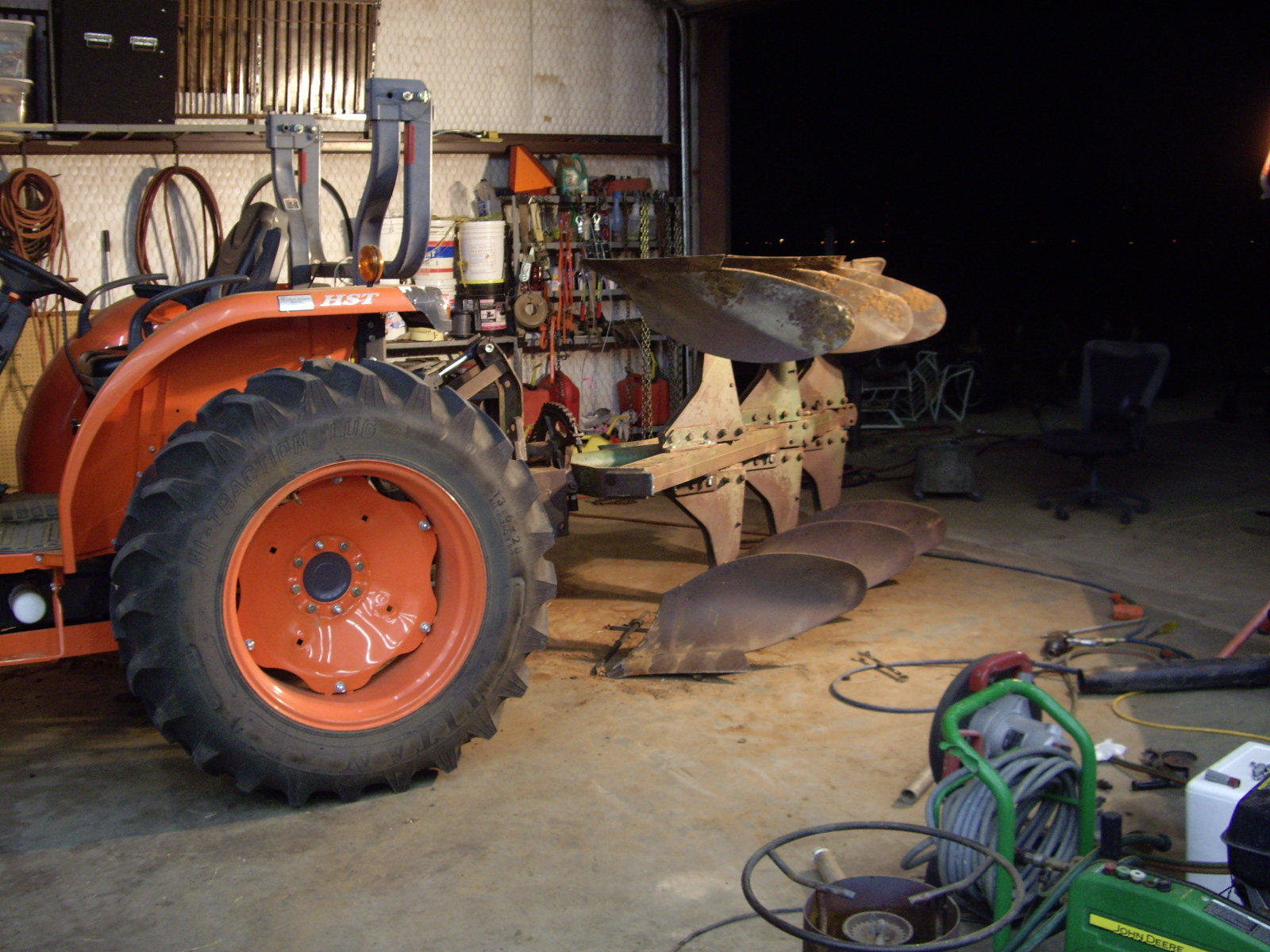

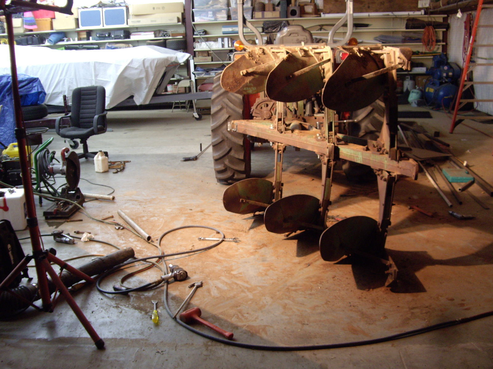

I moved the front bottoms 8 inches toward the center of the plow, the middle bottom 4 inches and left the rear where it was. The plow is now set up at 14 inches and my tire spacing is going to work out. I need to drill 4 more holes and am finished. The factory holes would only allow 4 inches toward center on the front bottom and the middle bottom was not adjustable. It is now. :) Of course I need new shares and shins but that's the easy part. I have found a source.
