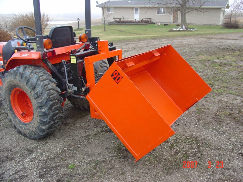

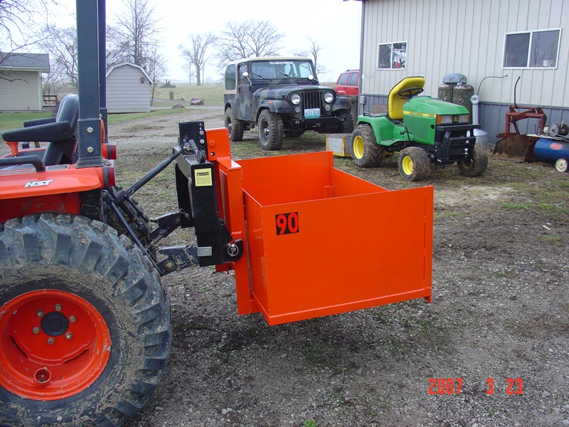

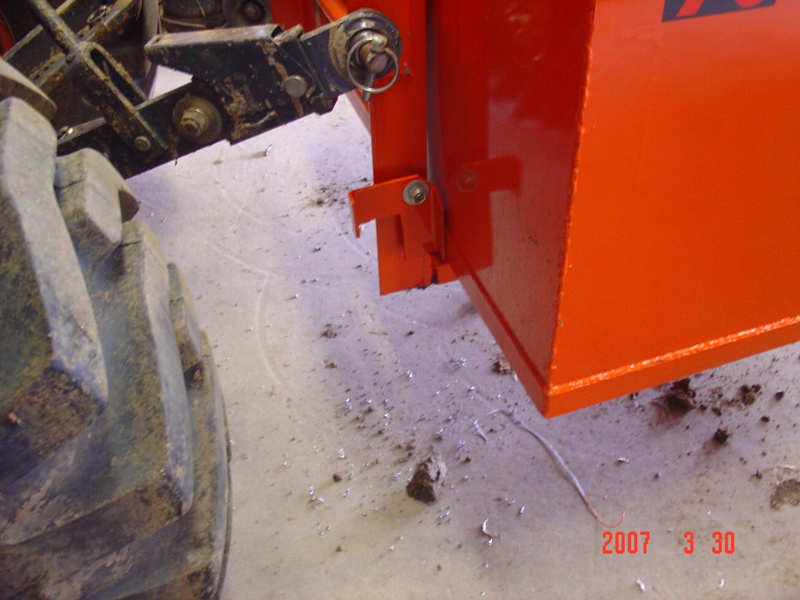

I built a Tote Box that could also serve as Ballast. It doesn't weigh 400 lbs though. I'm guessing 140 lbs. Is latched to prevent accidental dumps. Could be filled with kids, or whatever for ballast!!! ;)
