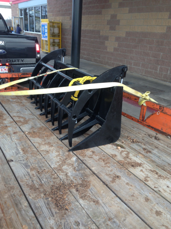

   / Most widely used grapple design? #4
I don't see one thing I can't do with my rake style grapple . I have grabbed brush , whole trees , demoed a old house , can grab leaves , and haven't grabbed rocks yet but see no reason , have grabbed scrap iron , grabbed whole trees out the ground . Can even grab a round roll of hay . Even grabbed a old ski boat with it . Heck it does everything I want ..
It will be the same style I will buy or make for my L3800 also .

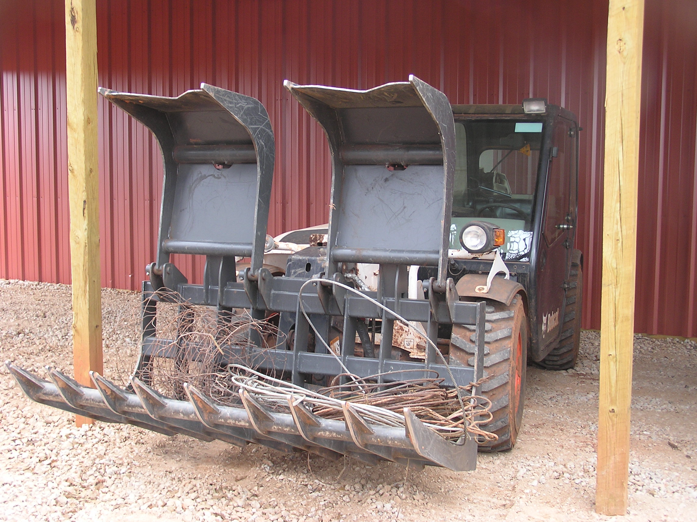

   / Most widely used grapple design? #5
I have the heavier duty version of what ford an has. it is a compromise; it can't hold quite as much, it is a single lid (depending on who you ask that could be a good or bad thing) it rakes, it lifts, it takes a beating, it can grab enough to keep me happy

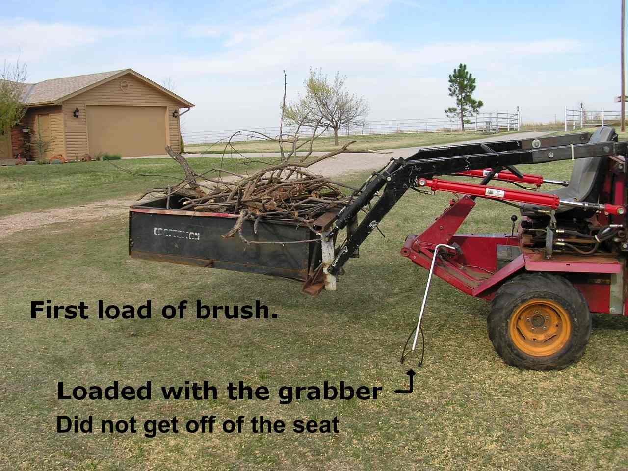

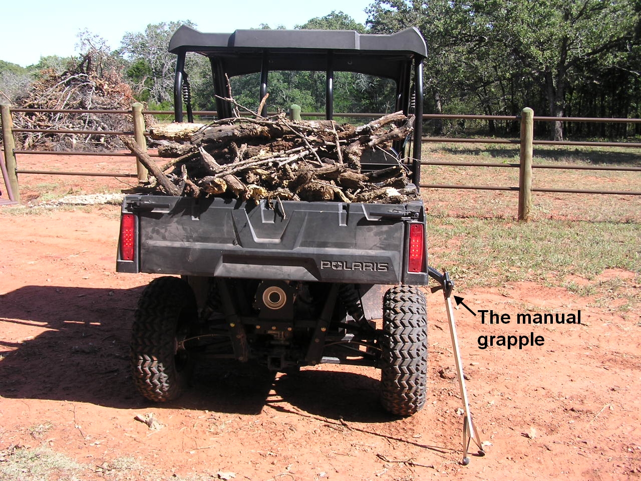

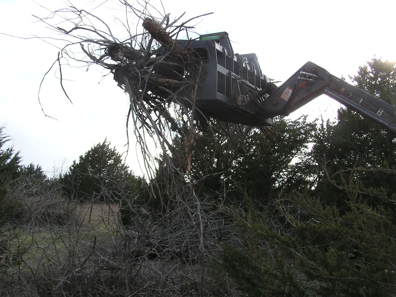

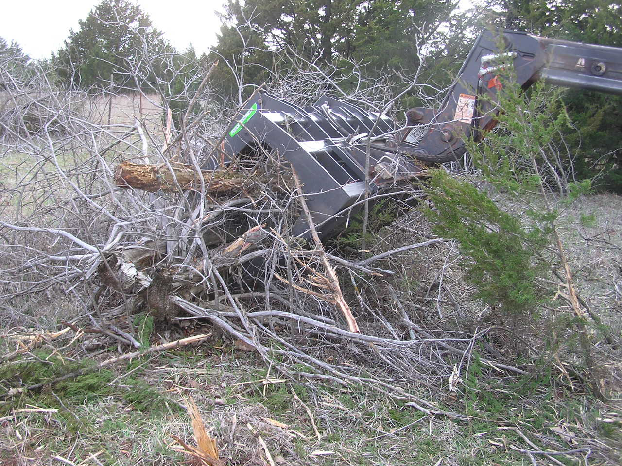

This is my Manual Two Tine Grapple. :D
I have had a rake style, but I like this style better, because it will carry stuff.
And pick up more brush.
It has a big bite.
View attachment 368699 View attachment 368692
That manual 2 tine grapple is pretty sweet! :thumbsup:
