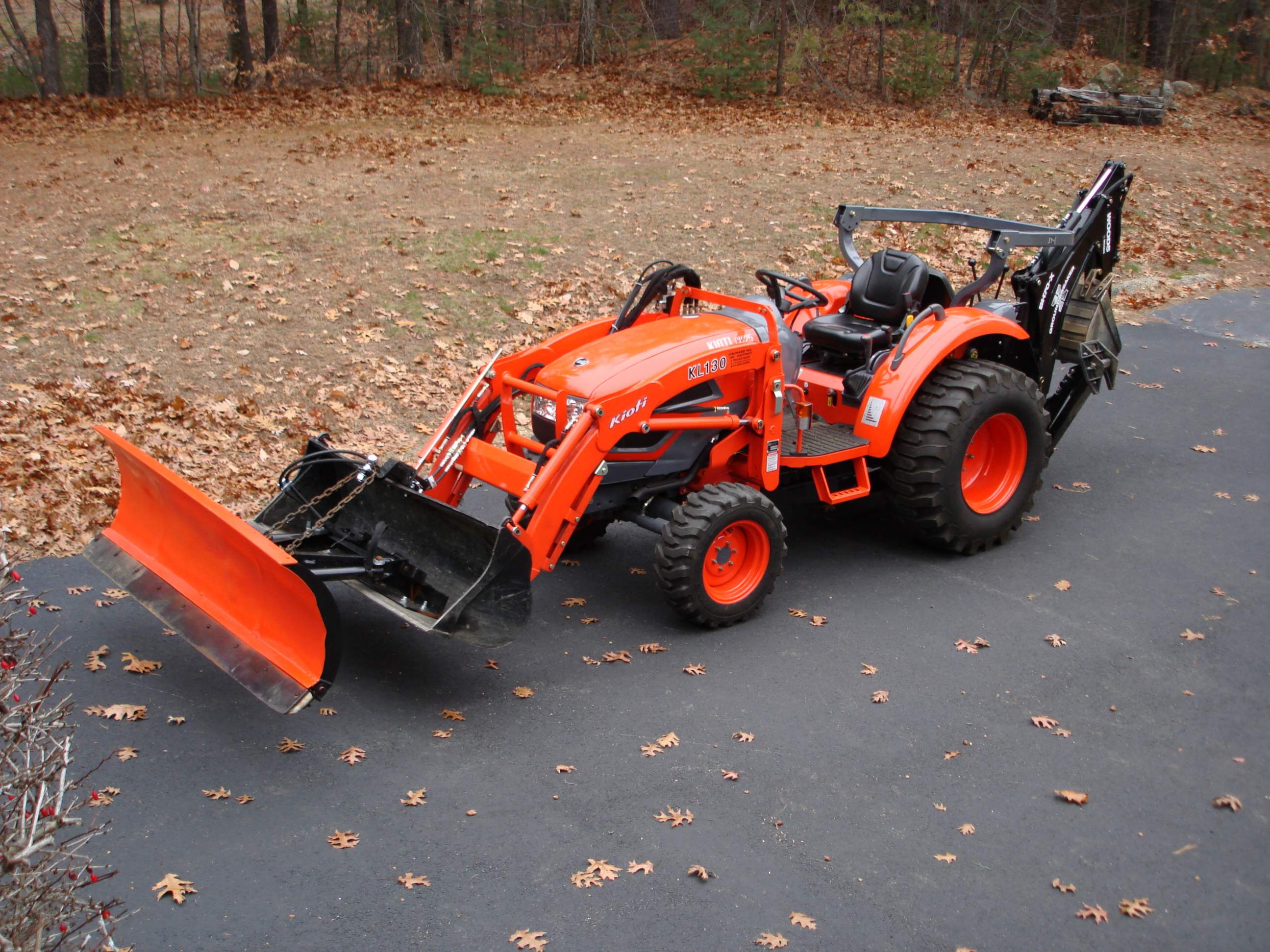

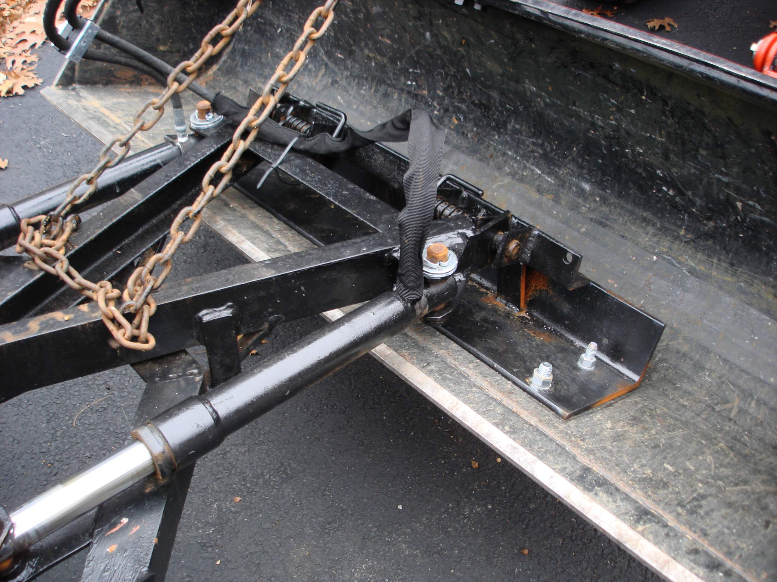

I did a quick job last year and it worked out great. Welded part of a plow frame to angle and bolted onto bottom of bucket. Great at knocking down tall snow banks.

This is exactly what I was thinking about. Where did you splice into the hydraulics to run the angle on the blade?
GREAT PICTURES!!!
   / Mounting Plow Blade to Bucket #8
JoelD
I control the angle of the blade from a diverter valve from W.R. Long ( Valve Kits ) that I purchased for my Grapple. If I was to do this over....and I intend to, I would have mounted the bracket closer to the front of the bucket. The further back you go the more you have to mess with the bucket location so as not to get too close to the driveway. So far I have been very happy with the results.
   / Mounting Plow Blade to Bucket #9
GREAT PICTURES!!!
Joel, do you have rear remotes on your tractor, like to run your backhoe.. if so, couldn't you use them? Certainly would be cheaper than a diverter valve.
