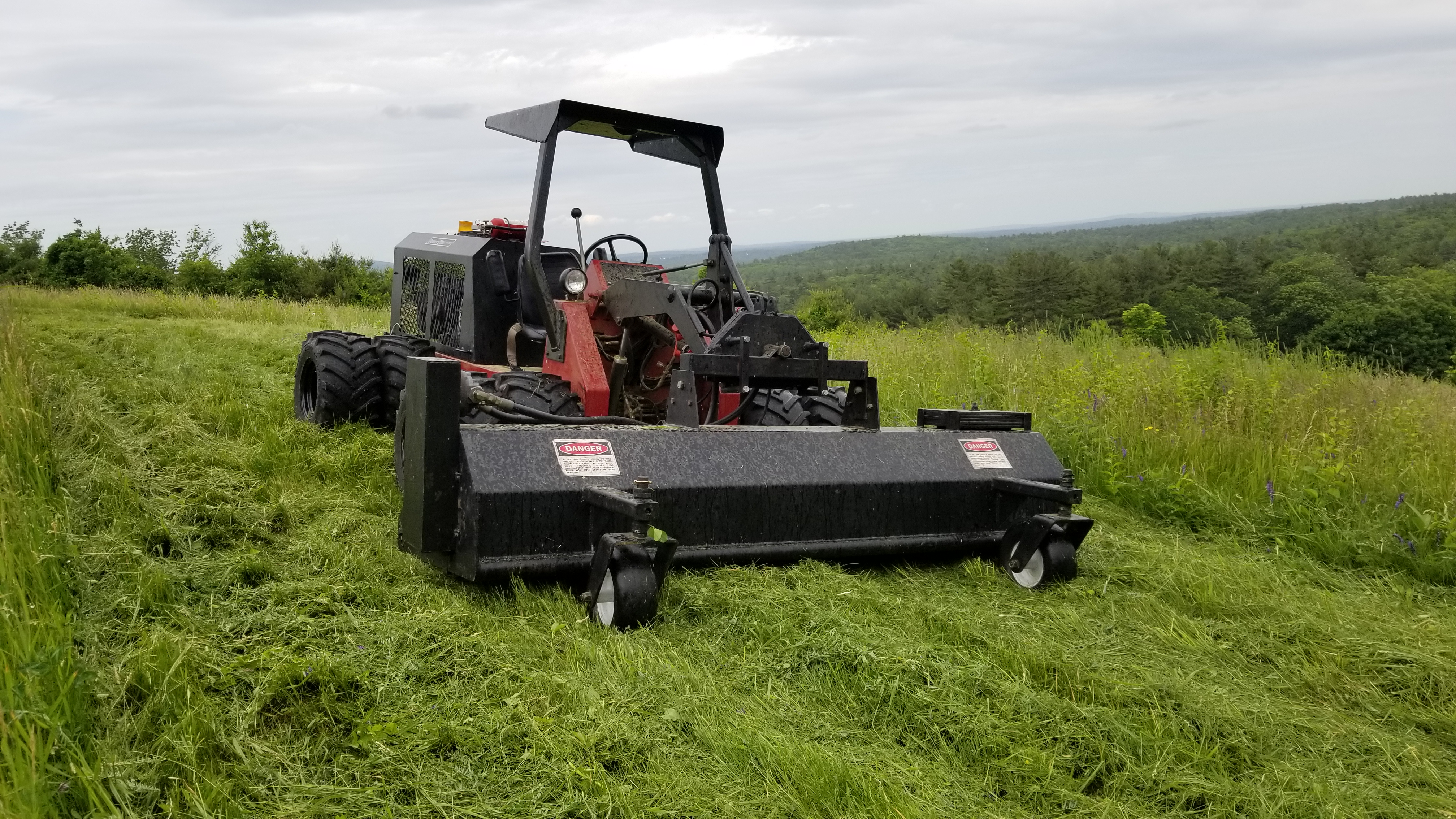

The cut in that pic is a strong 6". That is a 96" flail running off of the hydraulic PTO. The Power-Trac has a 65hp Deutz, and the hydraulic PTO sees about 40hp. I would figure that if I can push that around on the slopes then 50hp on flat ground and 10" narrower shouldn't be a real problem.
How tall is the field when you start? My rotary cutter can't clear the long length material fast enough and bogs it down, the flail mower just eats it all. If I was starting out at 8" and mowing to a finish cut, the rotary might be faster. But taking a 2+' field down, I'll keep using the flail.
