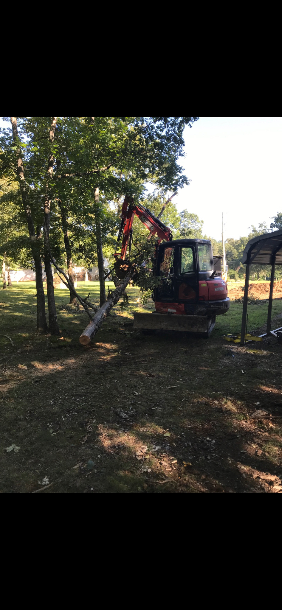

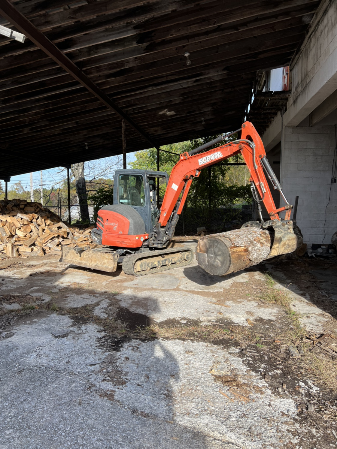

A mini excavator is actually decent for moving logs. It drives slow is the main downside but it can carry logs sideways which is nice when your trail isn’t very wide. Sure a tractor could drag it but that gets dirt in the bark and scars the ground. You can also pull a trailer and load it with the mini x to help with the low travel speed. I assume he doesn’t literally mean lifting stuff over peoples head. Not very many machines are rated for that. But a mini x is actually good at lifting stuff. You’d need a pretty big tractor to match what my KX-040 can lift. My L3800 can’t come close. Road maintenance definitely isn’t a minis strong point. I guess if you got a Kubota 40 with a 6 way blade you could do it.
