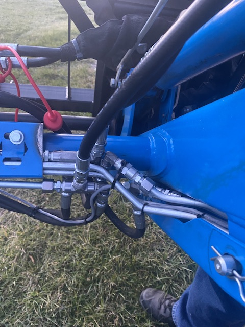

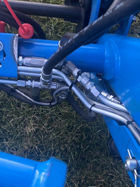

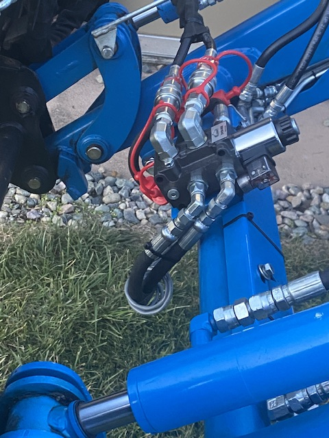

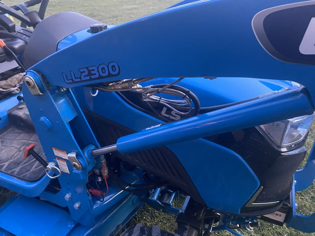

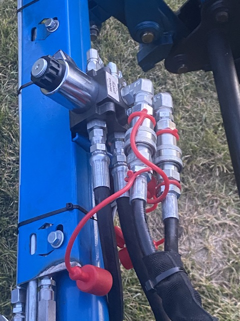

Purchased a summit diverter valve. Under 325 usd delivered. Just mounted on loader. Working on plumbing it up. Spent another 200 usd on Parker HP fittings to connect #6 JIC connection fittings. That cost was including 2- 24” and 2- 26” hoses made with female fittings. Next week plan to connect electric connections. Kit included joy stick and wiring also.
