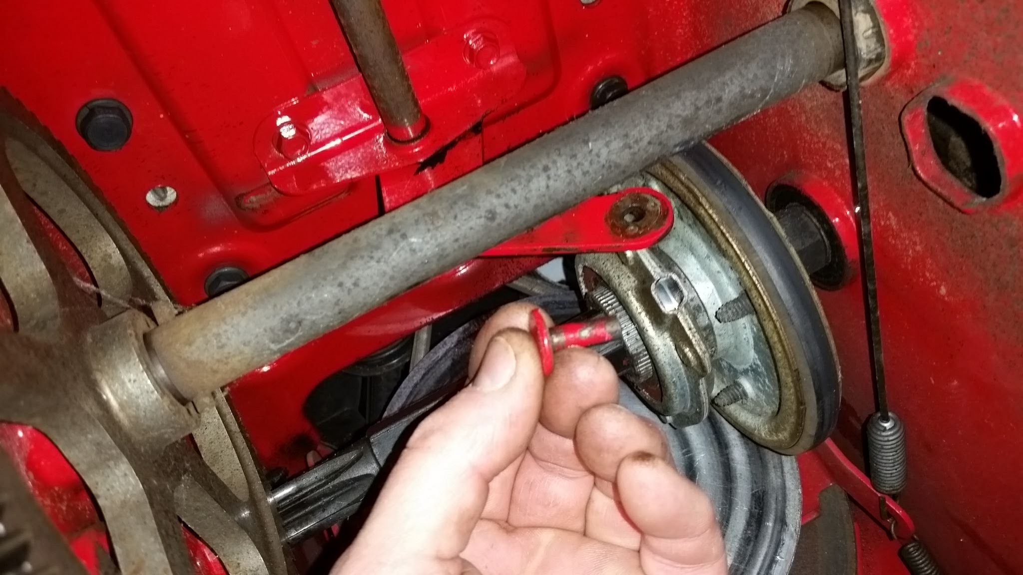

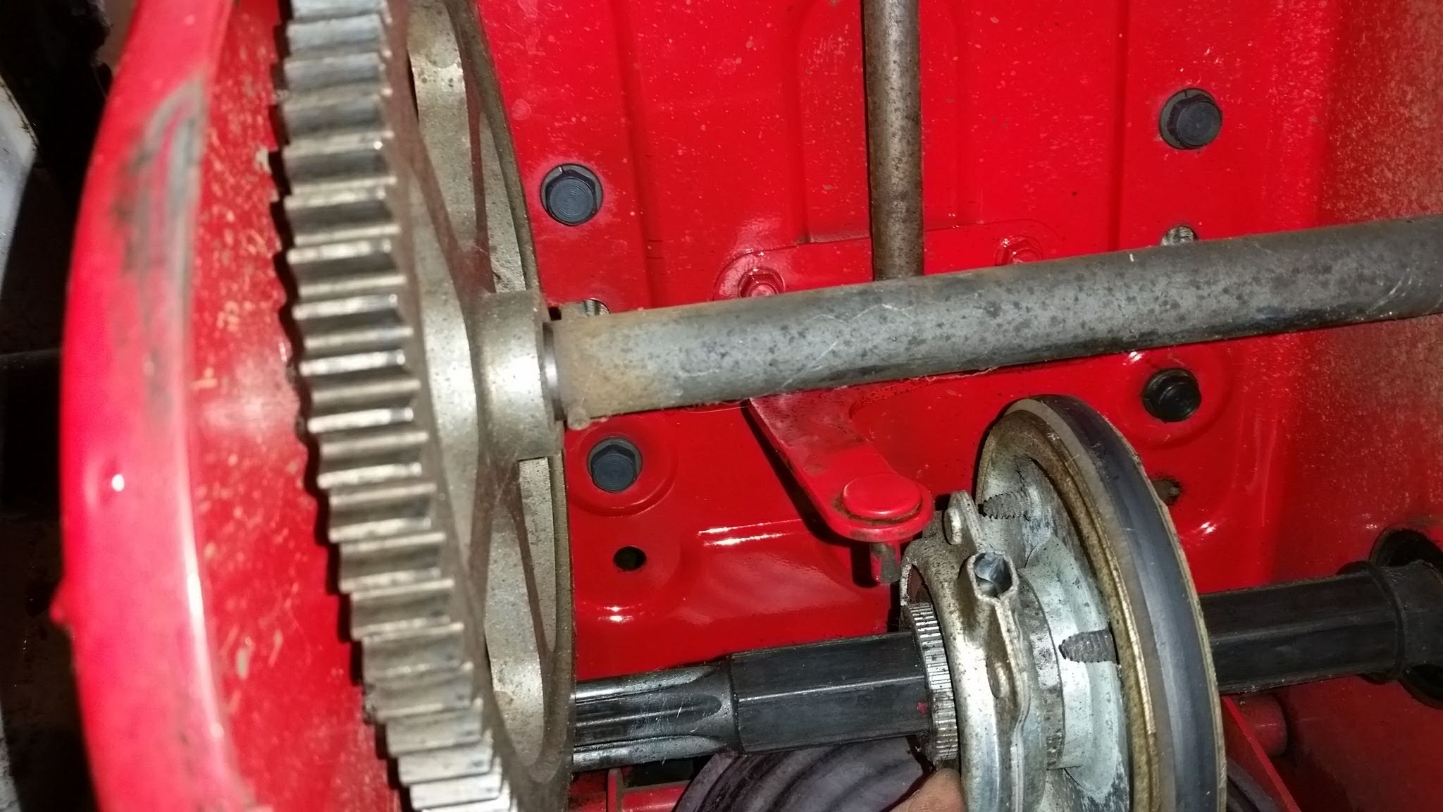

My snow thrower was stuck in high gear. I opened it up and found that the pin going to the friction wheel assembly had come out. I put it back in and it came out again. There doesn't appear to be any way to connect it to the shift arm assembly Am I missing something?

I've not worked on blowers in sometime. I could look it up and see if the pin is serviced w/ the arm. Looks likely. Post the model number from the chassis tag if so. Could you cheat and use a bolt and a nut instead of the pin?
   / MTD Snow thrower Friction wheel pin #3
View attachment 579880View attachment 579879
I have a similar blower Need to look at it - but
The factory may have press fit or spot welded the pin and it may have failed.
I would probably reinsert it through the arm and into the recess in the drive wheel housing assembly and tack weld it to the arm in a couple places.
Just checked and it appears to be a press fit.
So if you have a welder that would be the 1st choice
if not maybe some jb weld where it press fits

Thanks, I poured over the parts lists in the manual but couldn't find it. the model # is 31AS640F352.
I'll have to look to see if a bolt and nut would work but I think the nut might get in the way.

Thanks for taking the time to look at yours. I will probably try to weld it. I am hoping that I can remove the arm to do it because of the gas. I do have some JB Weld. Is that stuff really strong enough for something like this?
   / MTD Snow thrower Friction wheel pin #6
Yeah welding would be the thing. You could pop the whole engine off easy enough if you were concerned about the fuel. Dunno how easily the arm would come out. JB could very well hold as you have the surface area of the head for it to grab- provided the friction wheel assy always glides easily on the shaft. 684-04243 is the PN

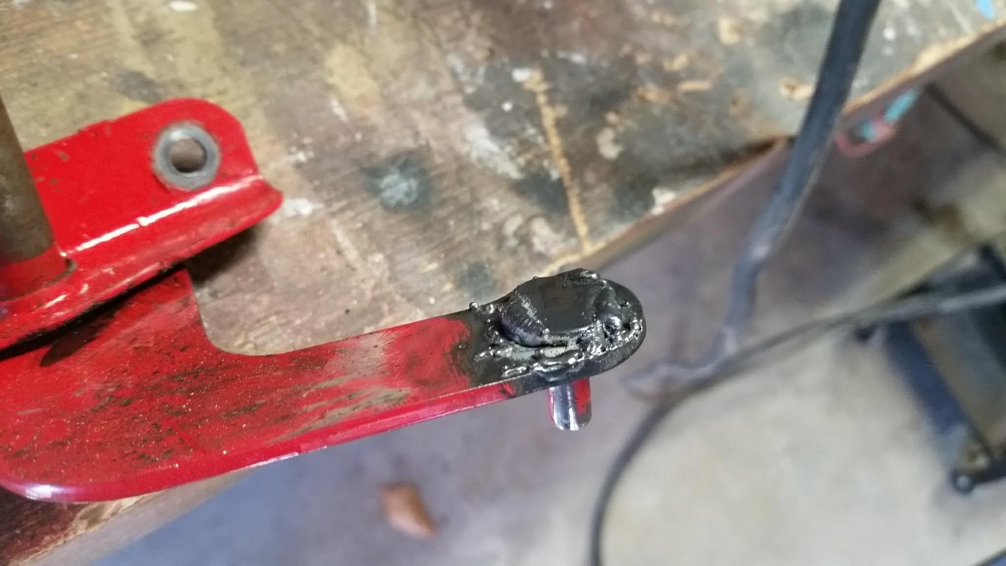

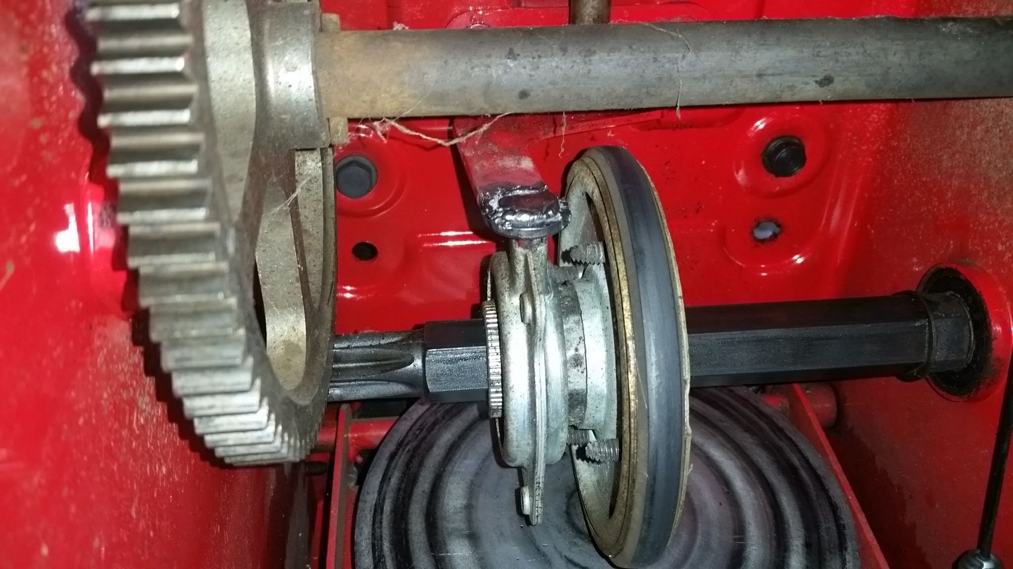

I got the pin welded. It isn't pretty but it works.
