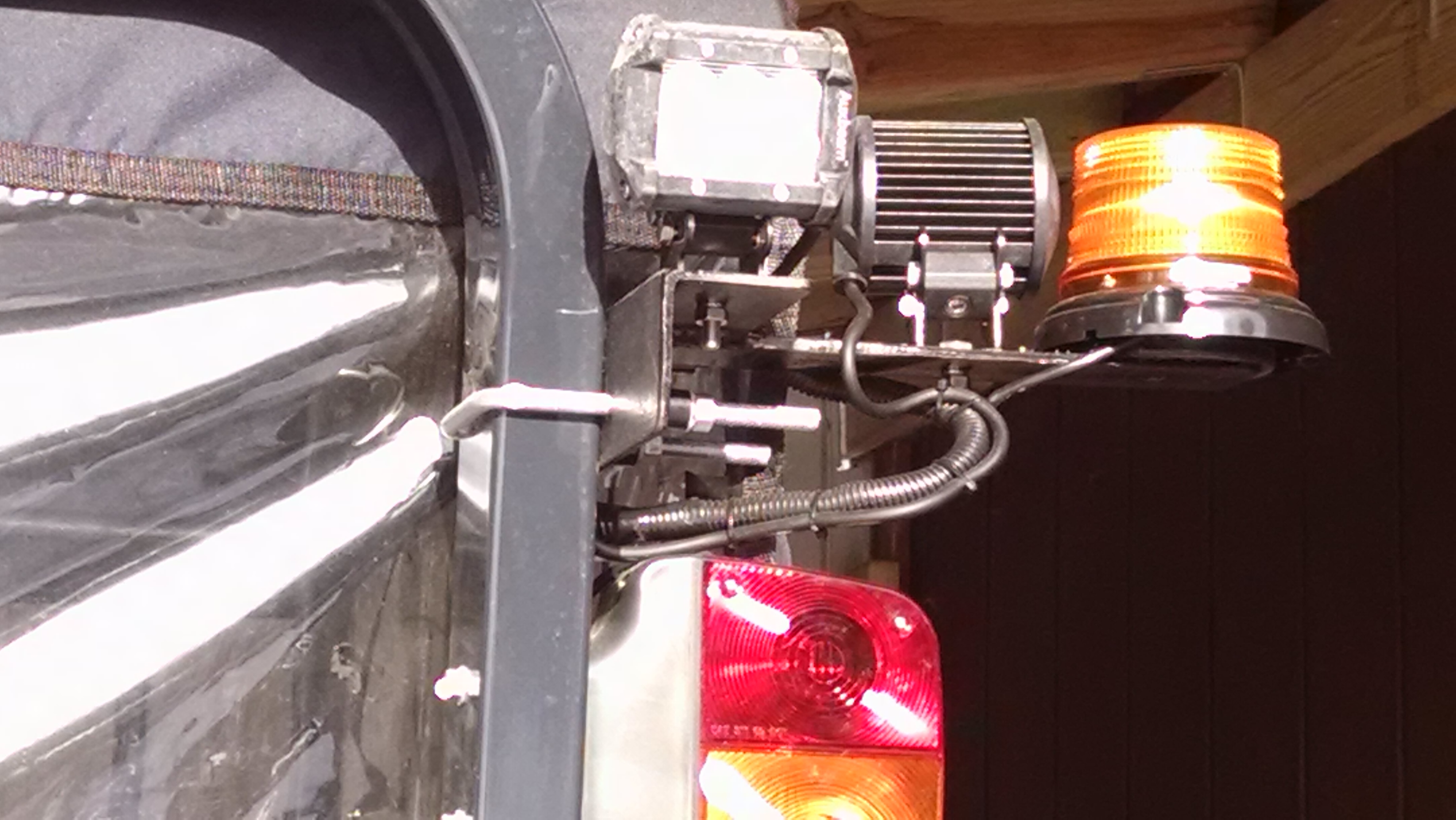

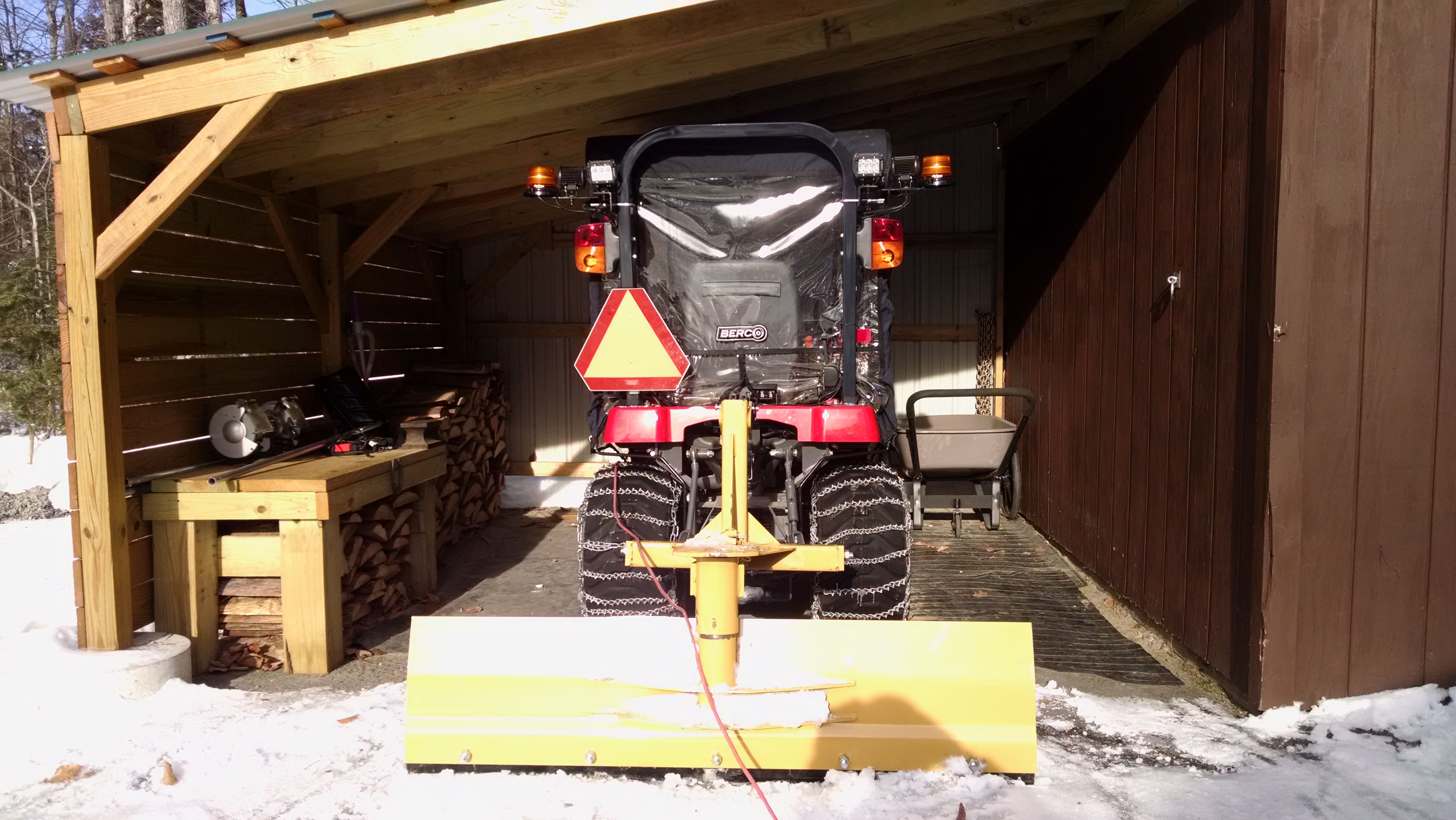

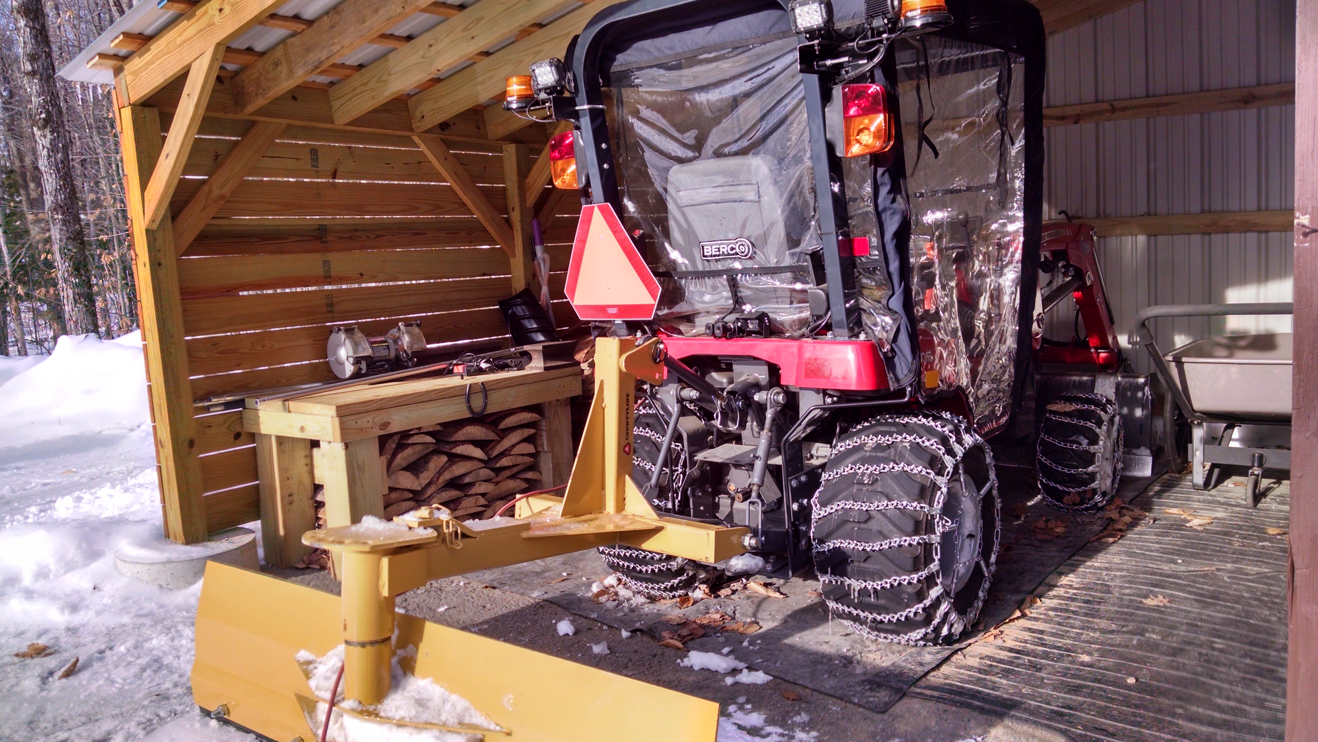

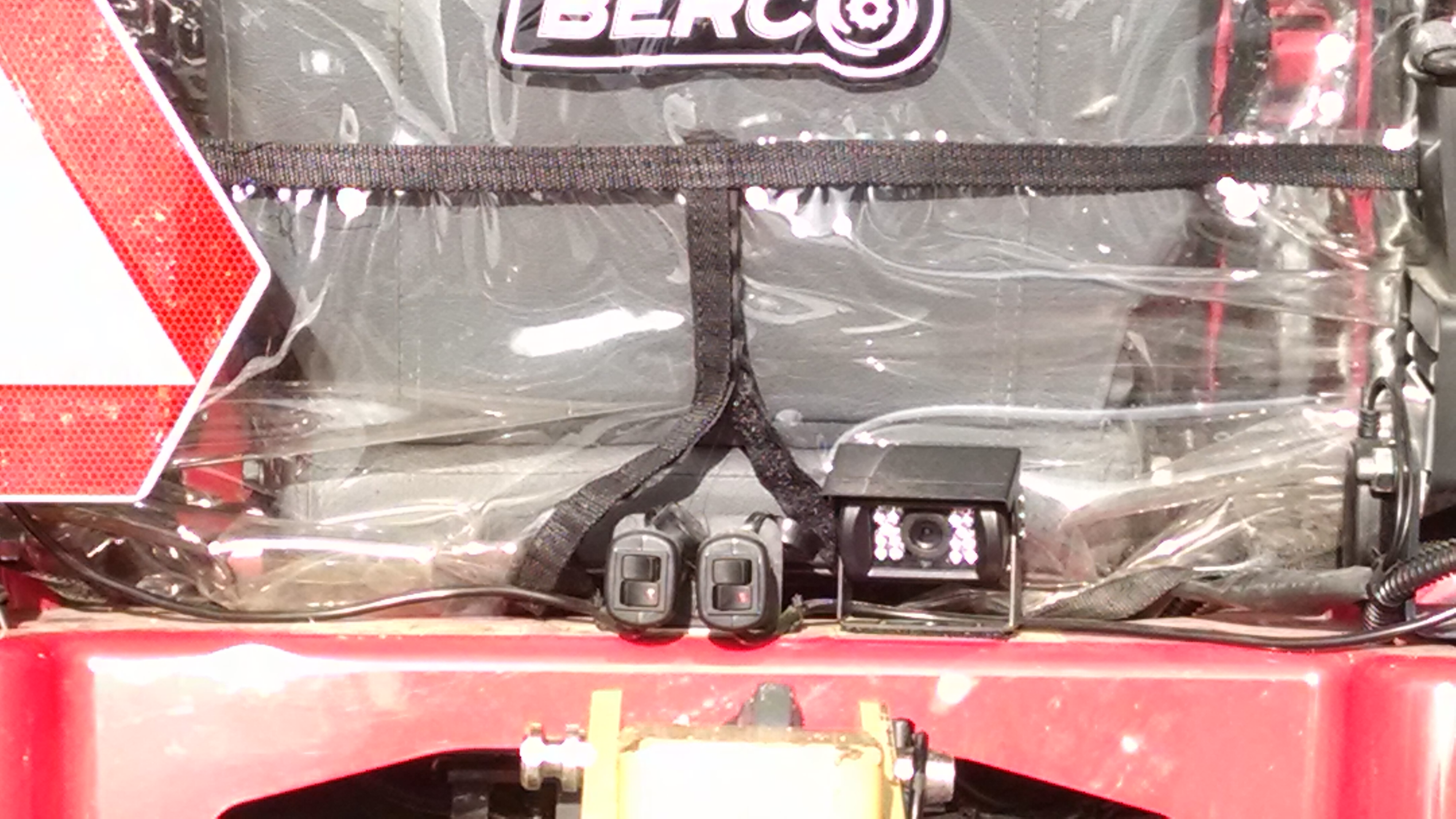

I installed all LED lighting, a wireless backup camera with an 8 inch screen, 2 Abrams class 1 LED strobes, and a Bercomac cab.. I added chains to the front this year for better steering, works great..
This is the first year I use a back blade for snow removal and I like the combination of the FEL and the blade in my situation it works great..

Looks good. I've never heard of a Bercomac cab, but I like it. I bet the chains make it unstoppable.
Edit: I looked it up the Bercomac cab and never found a price, you mind sharing a rough idea of what you paid for it?
   / My GC1705 In It's Snow Suit.
Thanks, yes the chains make it really nice, I have to move snow out of my fenced in back yard so I need them in there.. The Berco cab is made in Canada and for $299.00 you can't beat it, keeps me out of the wind and has very good visibility, taking it off for the summer takes five minutes..

Do you have spacers on your rear wheels for the chain clearance?
   / My GC1705 In It's Snow Suit. #9
I didn't put them on my 2600, but I did flip the rear tires from left to right. That moved each of them out 1.5" due to the offset (if I'm remembering the thread details correctly) for a little more stability, and would have given the chains a bit more clearance.
