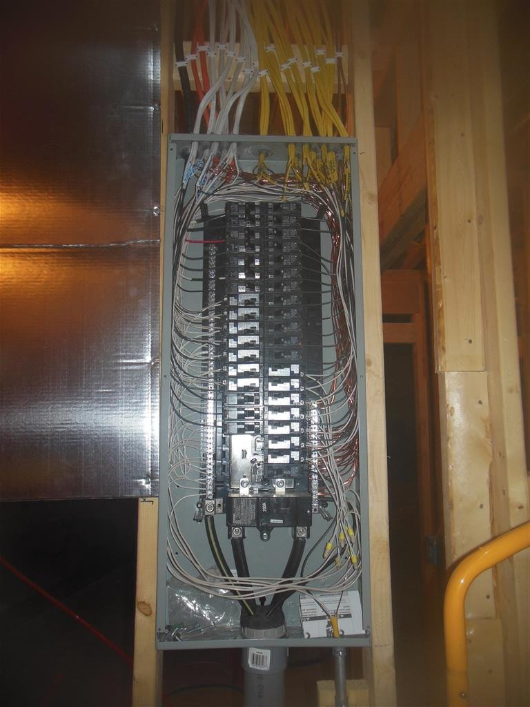

I believe it’s 20 amp circuit, but outlets themselves can be 15A rated if multiple, unless a dedicated 20A load. For my fridge, I had to put in a single outlet, not a duplex. I haven’t looked at a code book in several years.
It looks nice recessed in a wall, but it’s hell trying to add circuits later. I have moved circuits many times in my panel since I built.
And the heavy circuits are closer to the main.
I cringe just thinking of the work to install the service entrance wiring to that panel.
Laying out the wires neatly into the panel in an art. Mine looks crappy.

I'm not 100% sure, but in residential work, isn't it code for ALL outlets to be only 15 amps now? Or maybe that is just bedrooms, etc?
I won't pretend to have kept current with the code since it became less important to me (in other words - my house is done!) but I have not heard of that limit. Residential has been allowed 15A rated devices (receptacles, GFCI's etc) on a 120V 20A circuit for a long time. A lot also depends on what version your state or locality has adopted. Few places seem to jump on the new code the minute it comes out so most places are behind at least one version, and new ones come out every 3 years. My first question when starting my permit was what version of NEC are we using now? I think it was 2 or 3 behind.
Just for giggles here was my panel when I was done with it. 200A 40 space. Actually I see there are a couple spaces there. It was all full when I was totally done, but I must have been waiting for a couple things when I got to this point. Mains fed from bottom, so I flipped it.

Dstig, that panel is impressive.
I am supposed to have an electrician at the house tomorrow. If he wants me to, I’ll cut a piece of osb, cover the hole and surface mount it. Wont take long.
Use a nice sheet of plywood instead of OSB. Make it big enough so you can staple the wires to the plywood.

The electrician came to look things over this morning. He will be back friday to do some install work to bring the power into the house. The disconnect and transfer switch.
I have to re run some of my wiring. I have too much for the boxes I am using. Some of it he wants me to redo in 14 instead of 12.
I am pulling the box back out and surface mounting it. Always so fun to redo stuff. It’s the Inexperienced builder tax.

... Some of it he wants me to redo in 14 instead of 12.
Why would anybody want you to remove a bigger wire that's already in place for a smaller wire that cannot handle as much power?
You can never go wrong with a bigger wire, it's just more expensive, but if it's already in place, you can easily run a 15 amp breaker on 12 gauge wire.
