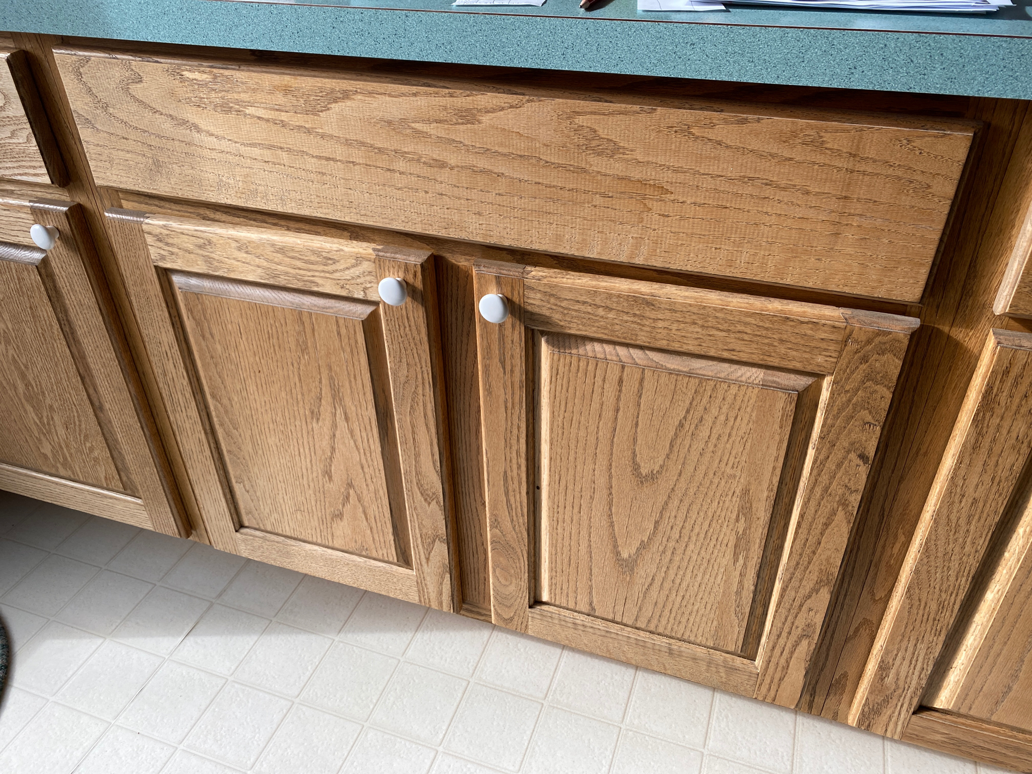

I made all my kitchen cabinets, including the raised panel fronts. Base boxes are 3/4” veneer, wall cabinets are 1/2” veneer. All sides recessed 1/4” into each other. Solid oak fronts and doors.
I’d show the whole kitchen but too messy.

Buckeye - did you sand those? I can still see the planer marks in the false front at the sink. I've never been able to get away without sanding even for cope and stick doors as there always seems to be some slight mismatch that would bug me down the road.
