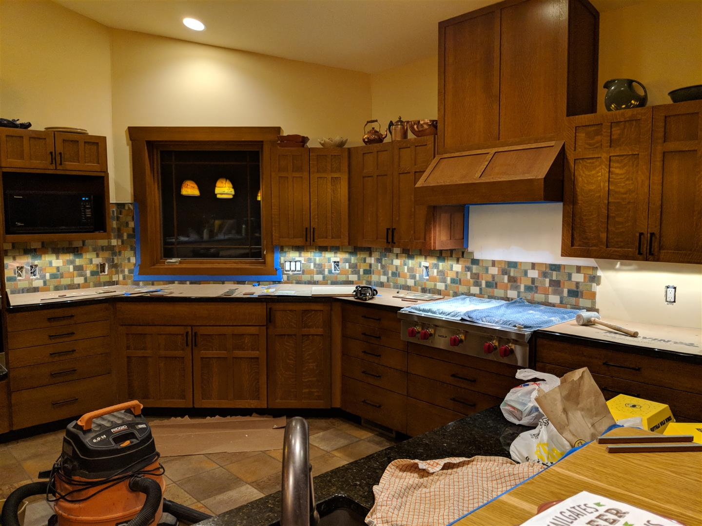

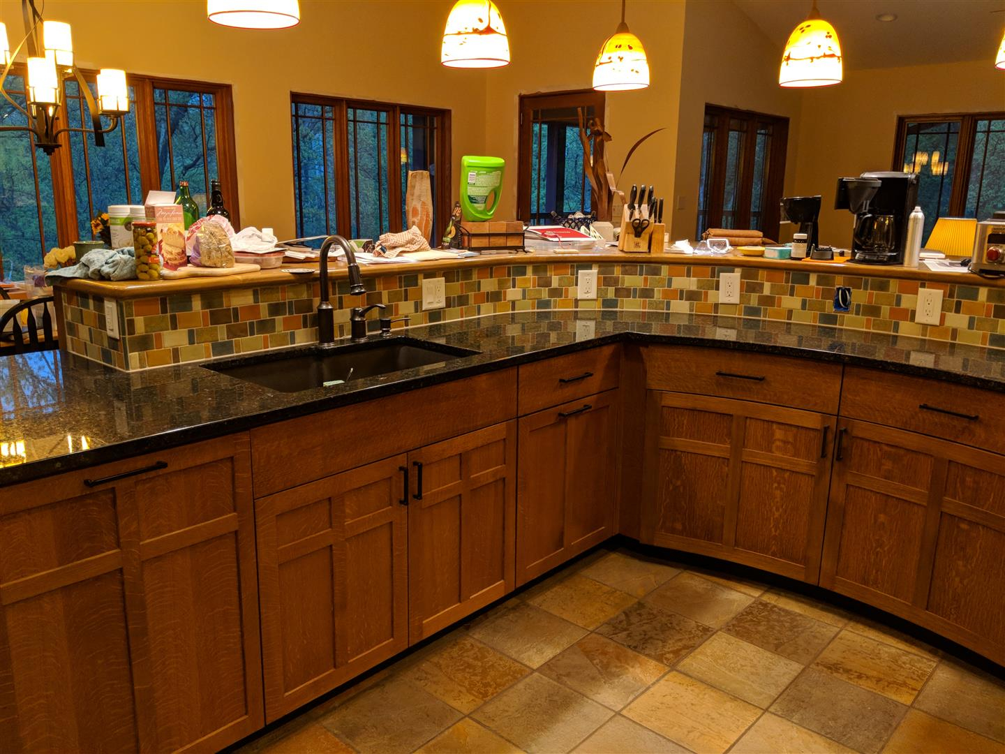

I build similar to how Buckeye described. I use prefinished maple 3/4" cabinet ply for the cases for base units and 1/2" cabinet ply for uppers of the same species as the finish wood to match. Frame and panel doors and here I did flat front drawers, but those can be frame and panel too.
Buckeye - did you sand those? I can still see the planer marks in the false front at the sink. I've never been able to get away without sanding even for cope and stick doors as there always seems to be some slight mismatch that would bug me down the road.
Here's a shot
I luv those windows allowing the views to the outside ! One tool i don't have is a drum sander which would make sanding those panels look more smooth.

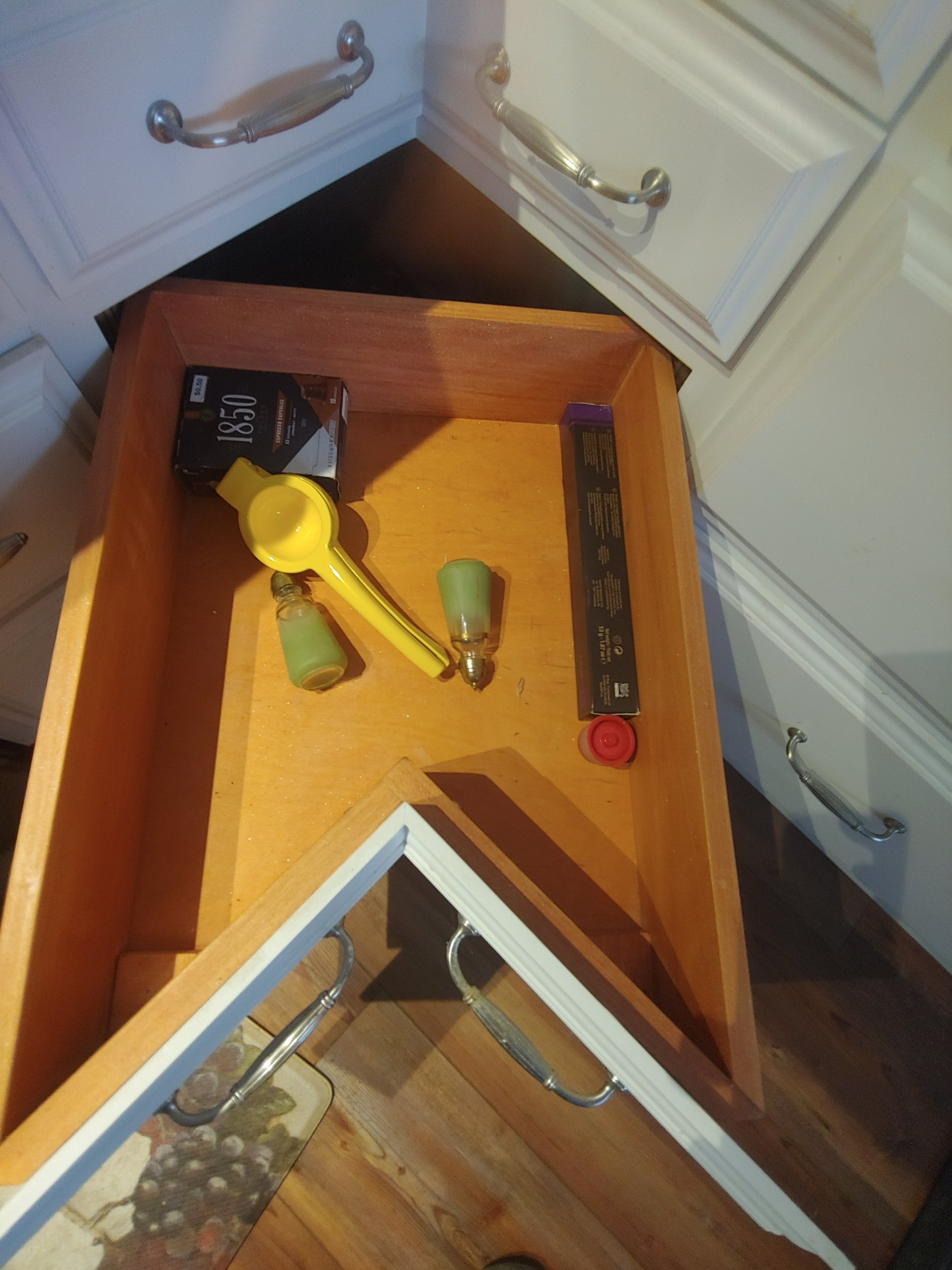

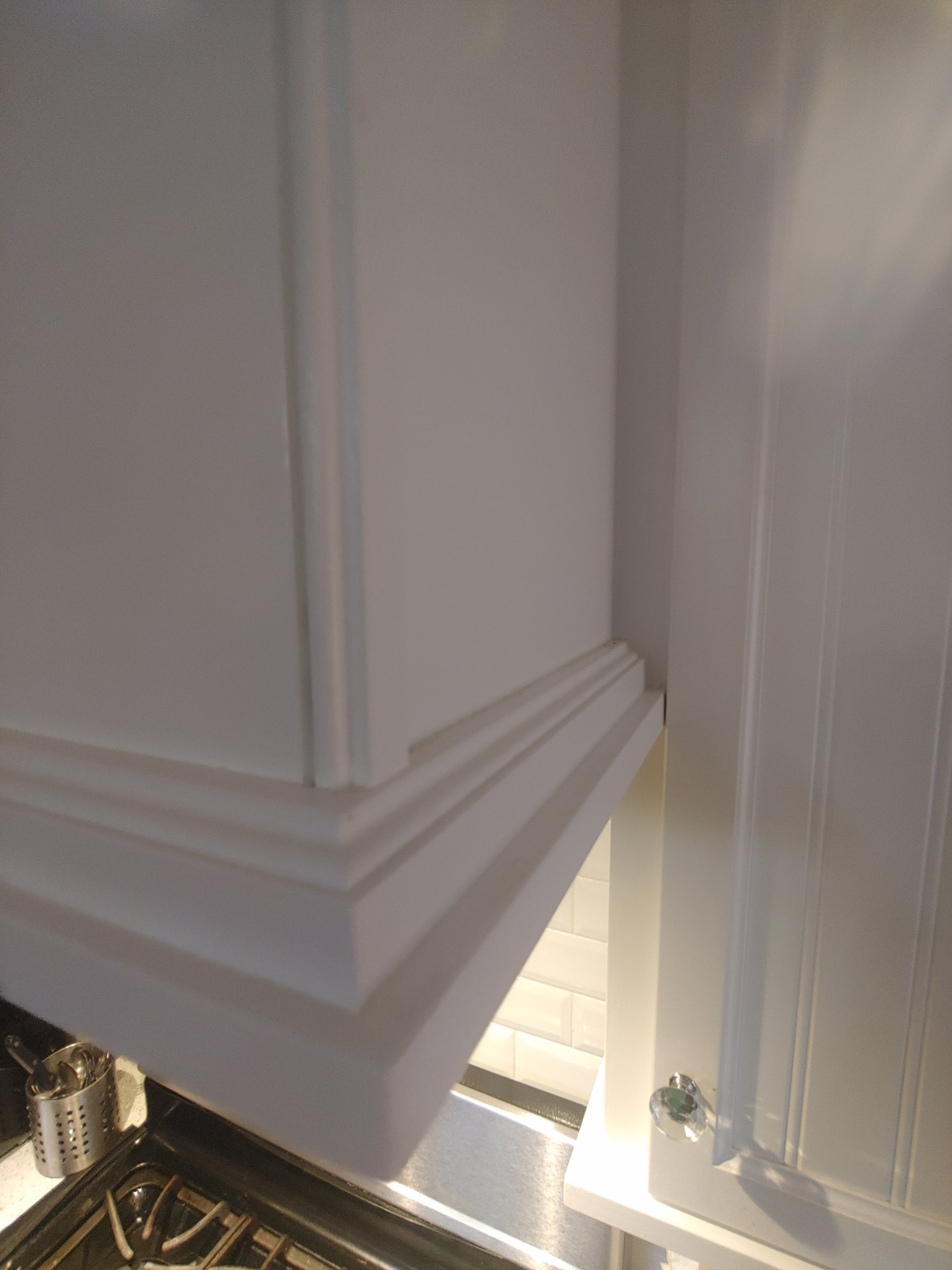

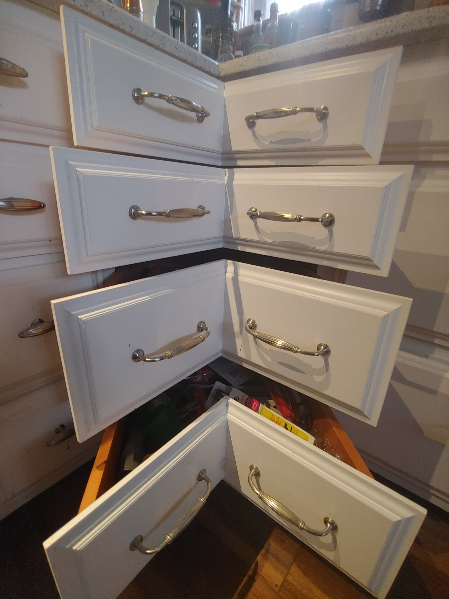

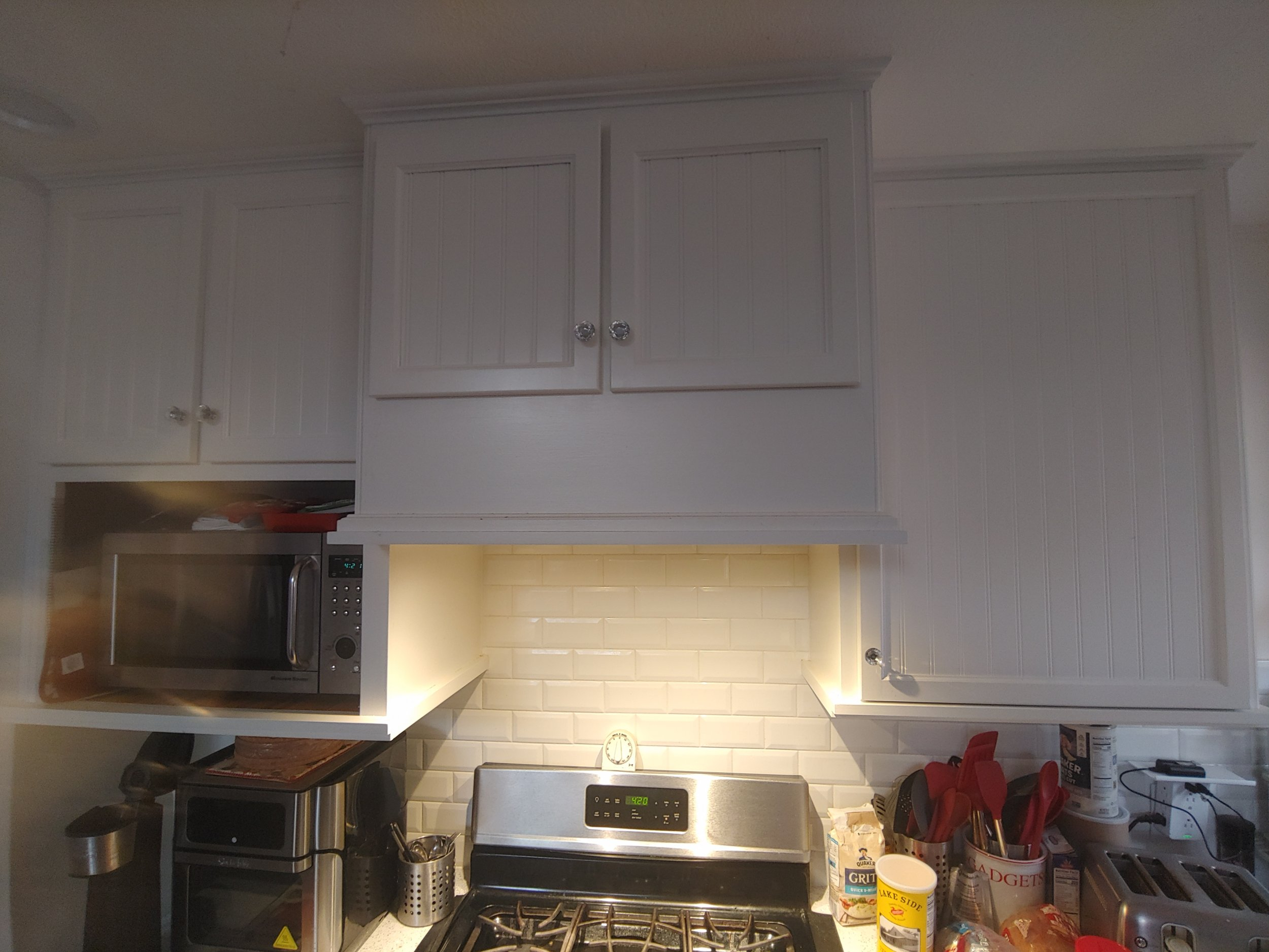

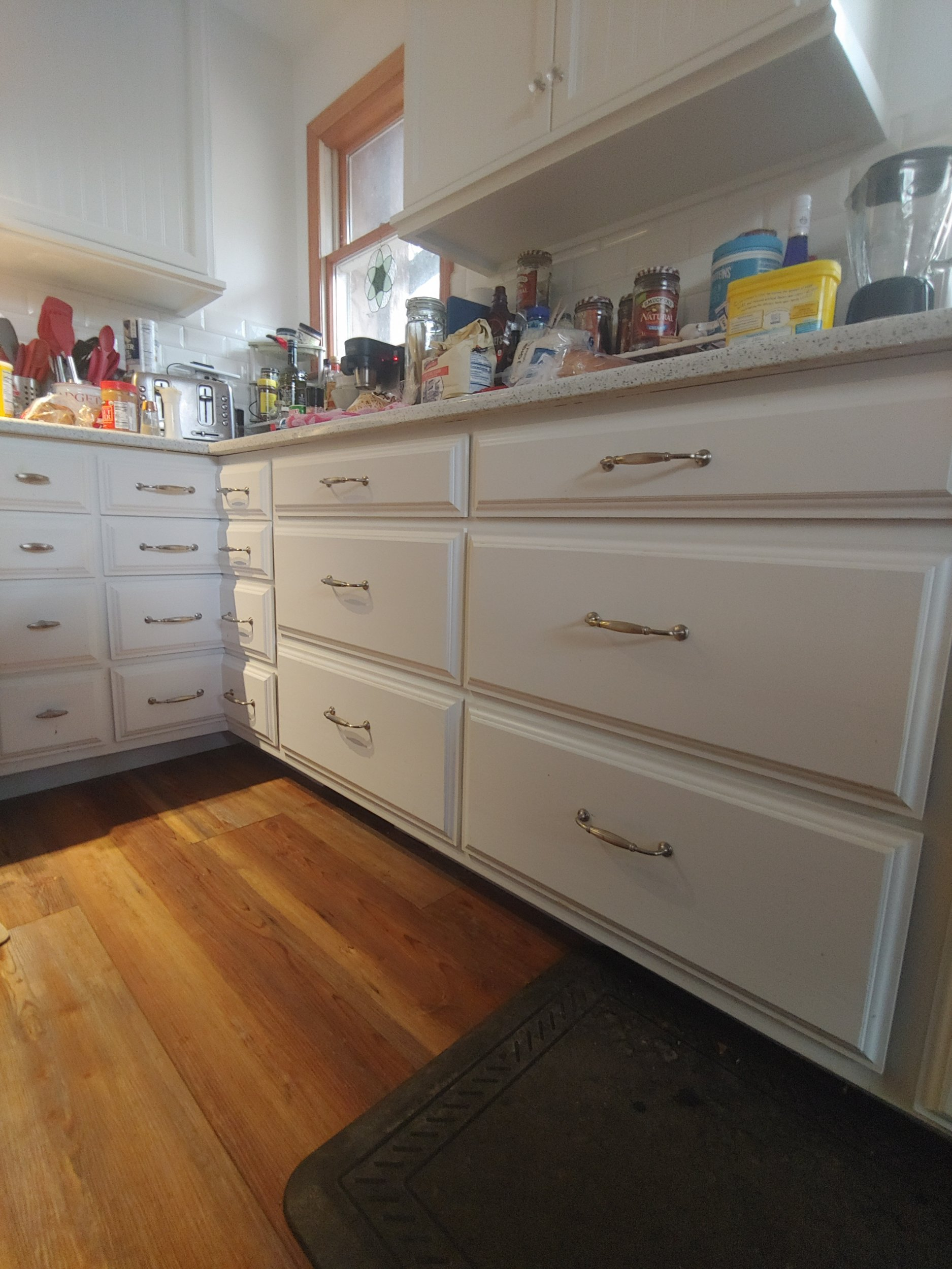

First time i ever built painted cabinets, but thats what the DW wanted. I have tried many different corner cabinets and found this design at a kitchen store. Man, what a challenge it was figuring out all the angles. Really like the way they turned out. You will always have wasted space. Just never liked having to open a door first to get to things.
   / My Industrial Cabin Build
#3,850
That is a very good looking kitchen
