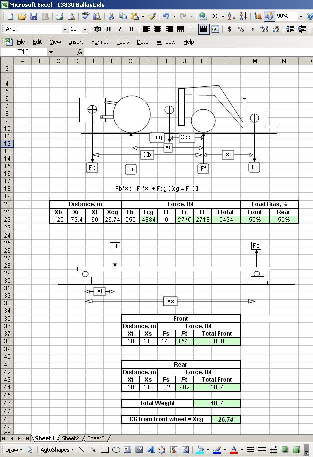

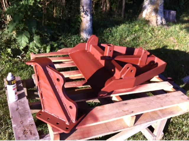

Thought I would share my latest attachment design.
I wanted a skidding hitch that also served as a trailer mover and ballast box. Nothing of this type was on the market so I developed one. My tractor, L3830 Kubota, does not have filled tires. So I determined how much ballast I needed by developing an axle loading equation in excel. :teacher: Here's a screen shot.
I determined wheel loading using a bathroom scale and long beam. :laughing: Worked great and is accurate enough for my purposes! :thumbsup:
To achieve 50/50 loading with loader empty, I need 550lbs of ballast at the 3 point.
I'll share pics of the hitch when time allows...

That's cool how you used excel to figure it out.
   / My log skidding/ballast hitch project
Yeah Excel makes the number crunching easy! Just gotta make sure I have my theory right. :reading:

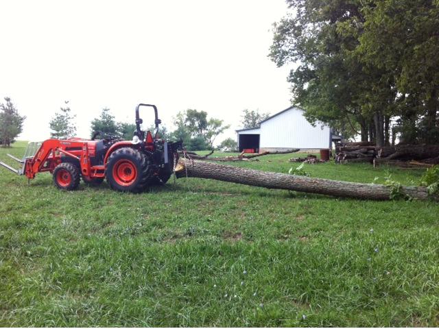

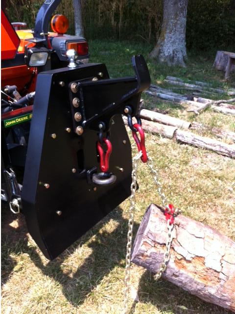

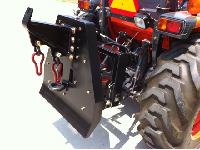

Here's the pics.
Notice the use of choker chains and grab links. This is a great way to choke logs.

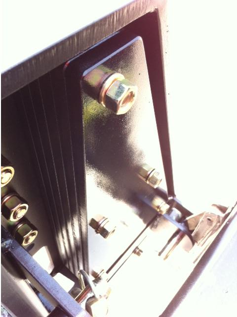

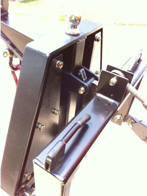

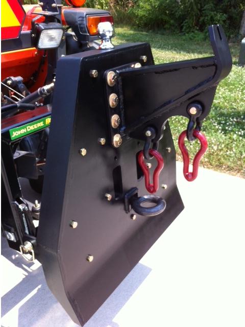

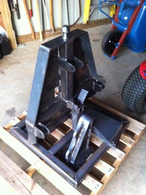

The hitch is ballast is visible in a couple pictures. Laser cut steel 1/2" plate. It looks small but this hitch weighs in at around 550 lbs. :blacksmith:
Also note is it compatible with my iMatch JD quick hitch.

Nice work!
   / My log skidding/ballast hitch project #9
Great idea, Superb craftsmanship. Many of us can't justify a $4k farmi for the amount of logging that we do.
   / My log skidding/ballast hitch project #10
It looks very nice. I like that it is qh compatible.
