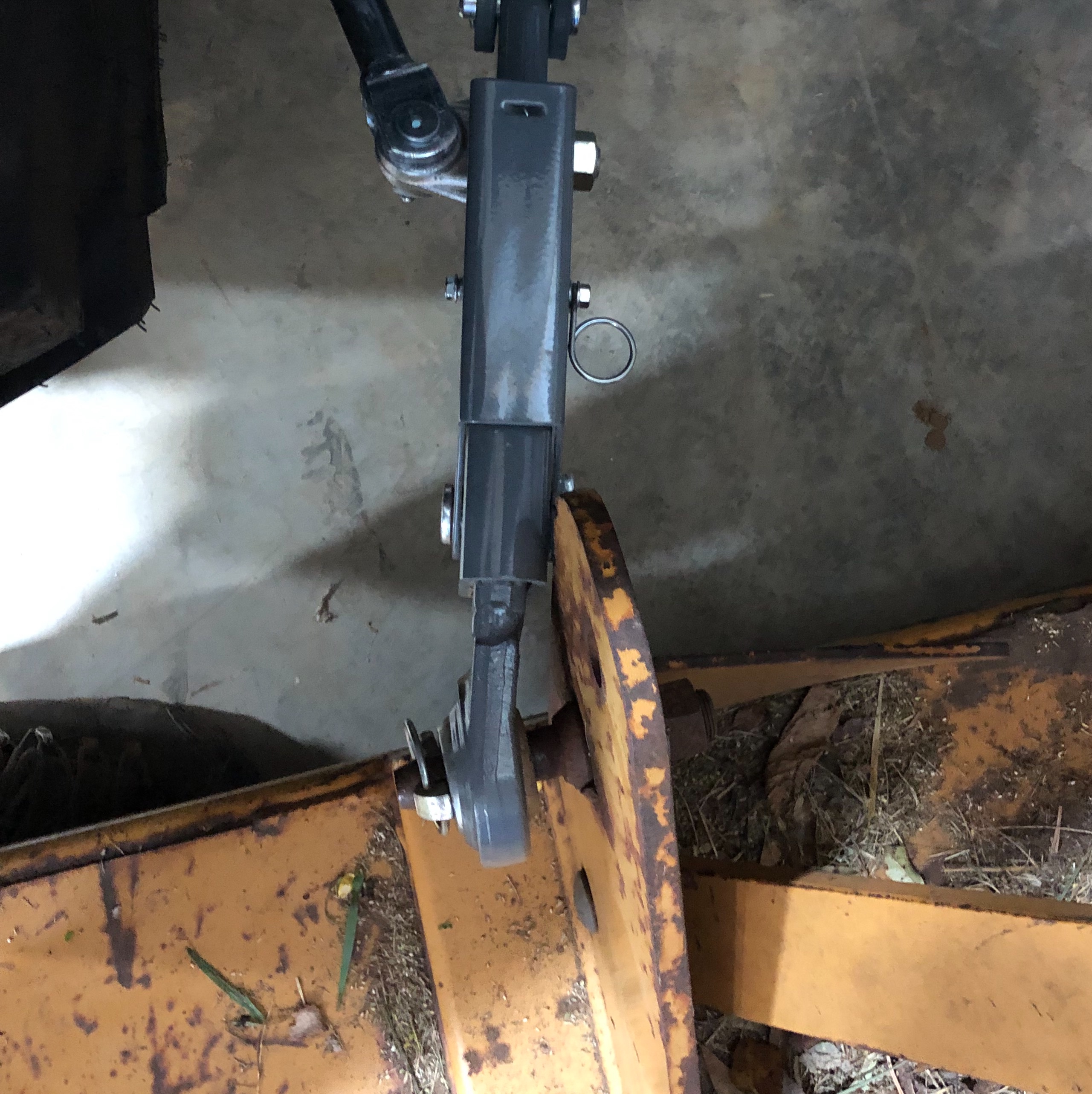

Aug 30, 2019 / My new 1760m #1 C ccollins New member Joined Oct 2, 2009 Messages 1 Location Carrollton,Ga Tractor MF255, MF1760m My 1760m was delivered today. It is the shuttle shift version. I put two hours on the tractor before dark. I do have one issue that I need help with. I have a 6 ft woods bush hog and it rubs the lift arms when it痴 hooked up. Last edited: Aug 30, 2019

Aug 31, 2019 / My new 1760m #2 A Agvg Elite Member Joined May 25, 2013 Messages 3,184 Location Norway Tractor Mf135, Ursus C-355, David Brown 995 Loosen the bolt and put on the other way so it is on the out side of the bracket?
Aug 31, 2019 / My new 1760m #3 Wagtail Super Star Member Top Poster Of Month Joined Jan 15, 2013 Messages 13,956 Location St Helens, Tasmania, Australia Tractor JD 4105 / JD Z355E (48" deck) G'day Mate and welcome to TBN from Downunder. As a temporary fix, I agree with Agvg. Long-term, I'd consider a 3PH 'quick-hitch' which would eliminate the rubbing. Enjoy the site and congratulations on the new MF.

Sep 1, 2019 / My new 1760m #7 TSO Elite Member Joined Apr 7, 2012 Messages 4,442 Location SouthEast Michigan Tractor Massey 1652 HST Cab Congrats, nice machine! Move the lift pins to the inside of the brushhog brackets.
Sep 3, 2019 / My new 1760m #8 JWR Elite Member Joined Apr 19, 2011 Messages 4,138 Location So MD / WV Tractor MF 2660 LP, 3 Kubota B2150, Kubota BX2200, MH Pacer, Gravely 5660, etc. Agvg said: Loosen the bolt and put on the other way so it is on the out side of the bracket? Click to expand... Or maybe use the UPPER hole in the bush hog ? I do not like the quick hitch adapters myself.
