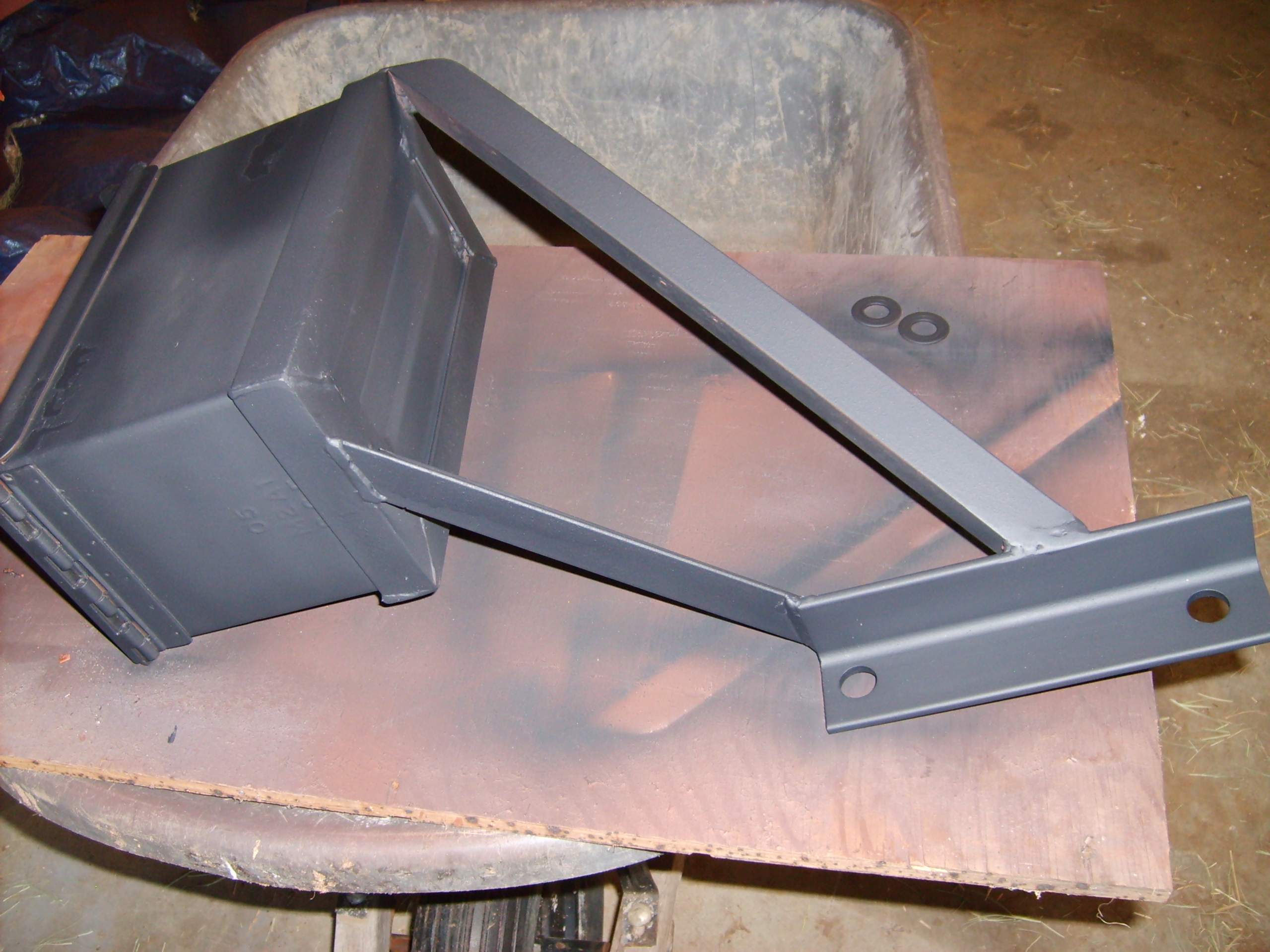

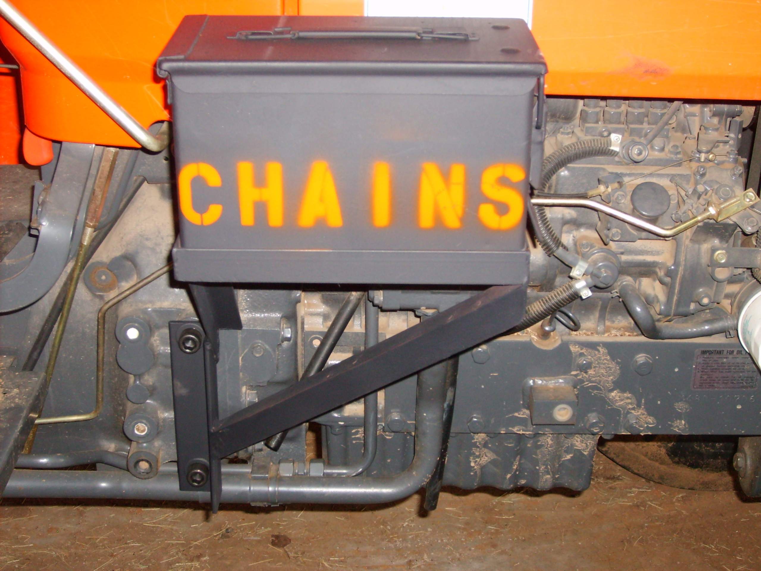

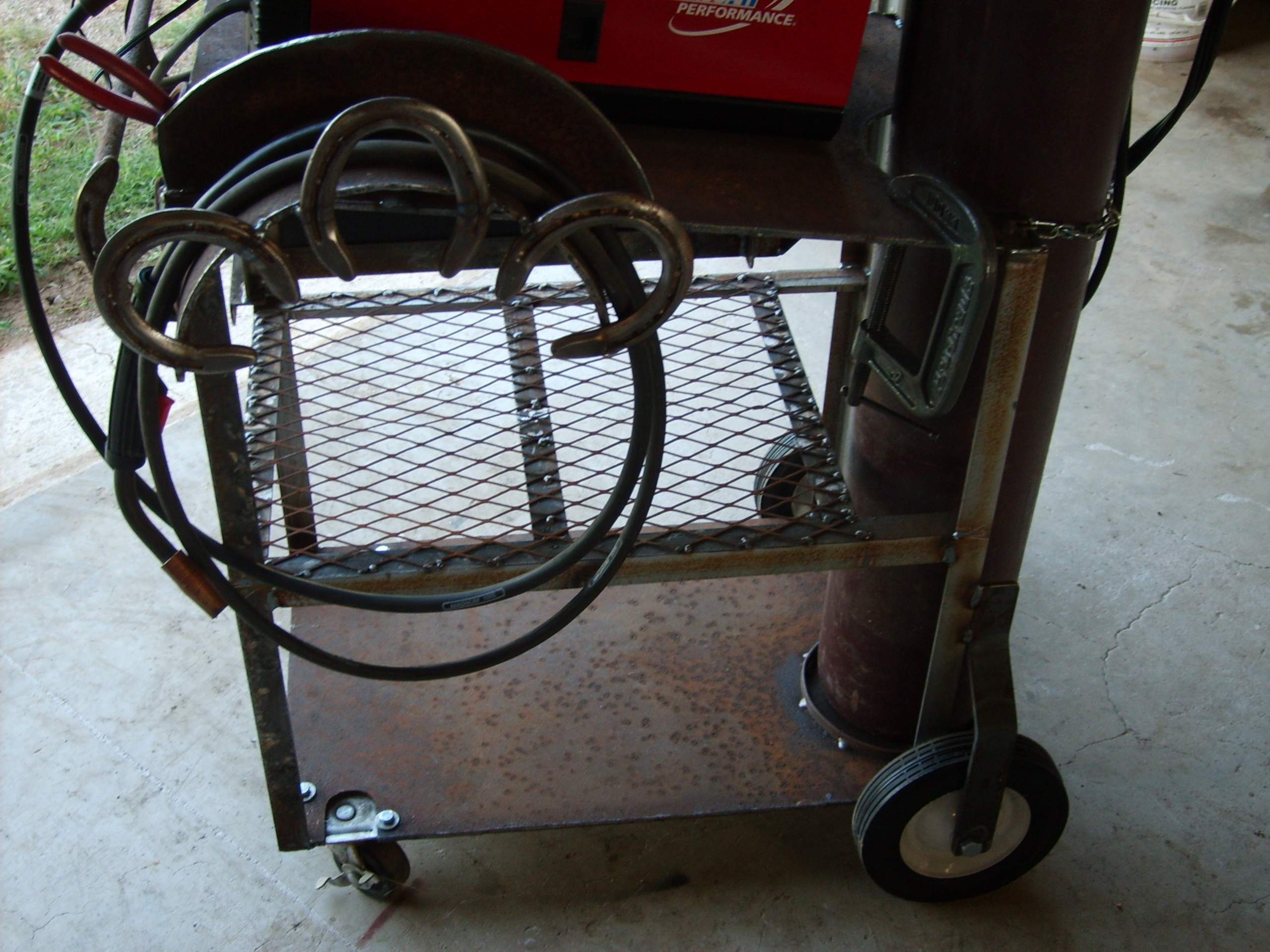

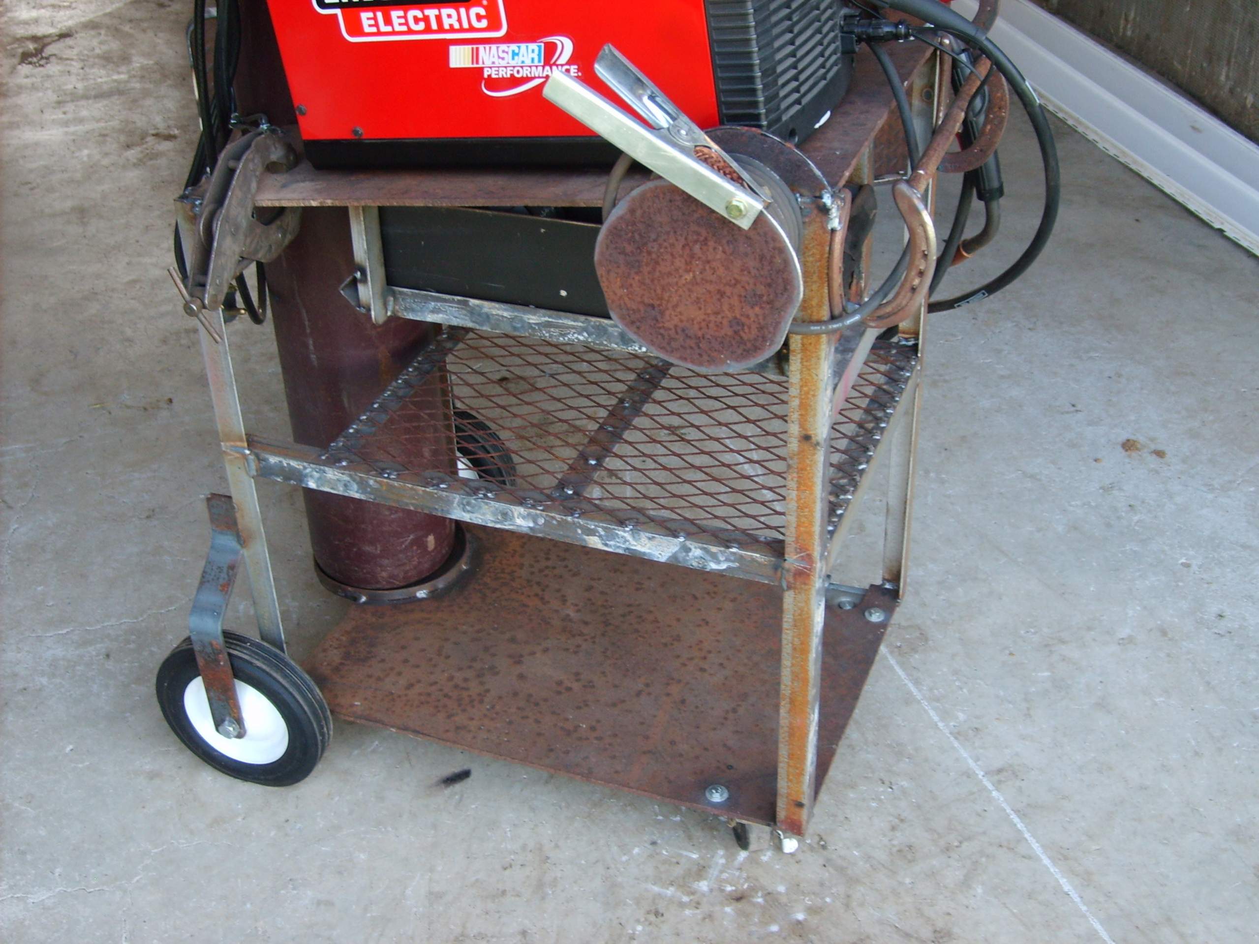

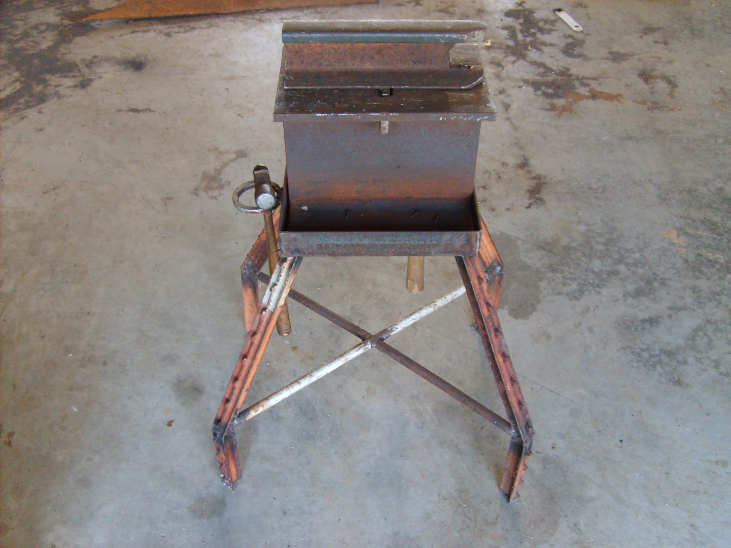

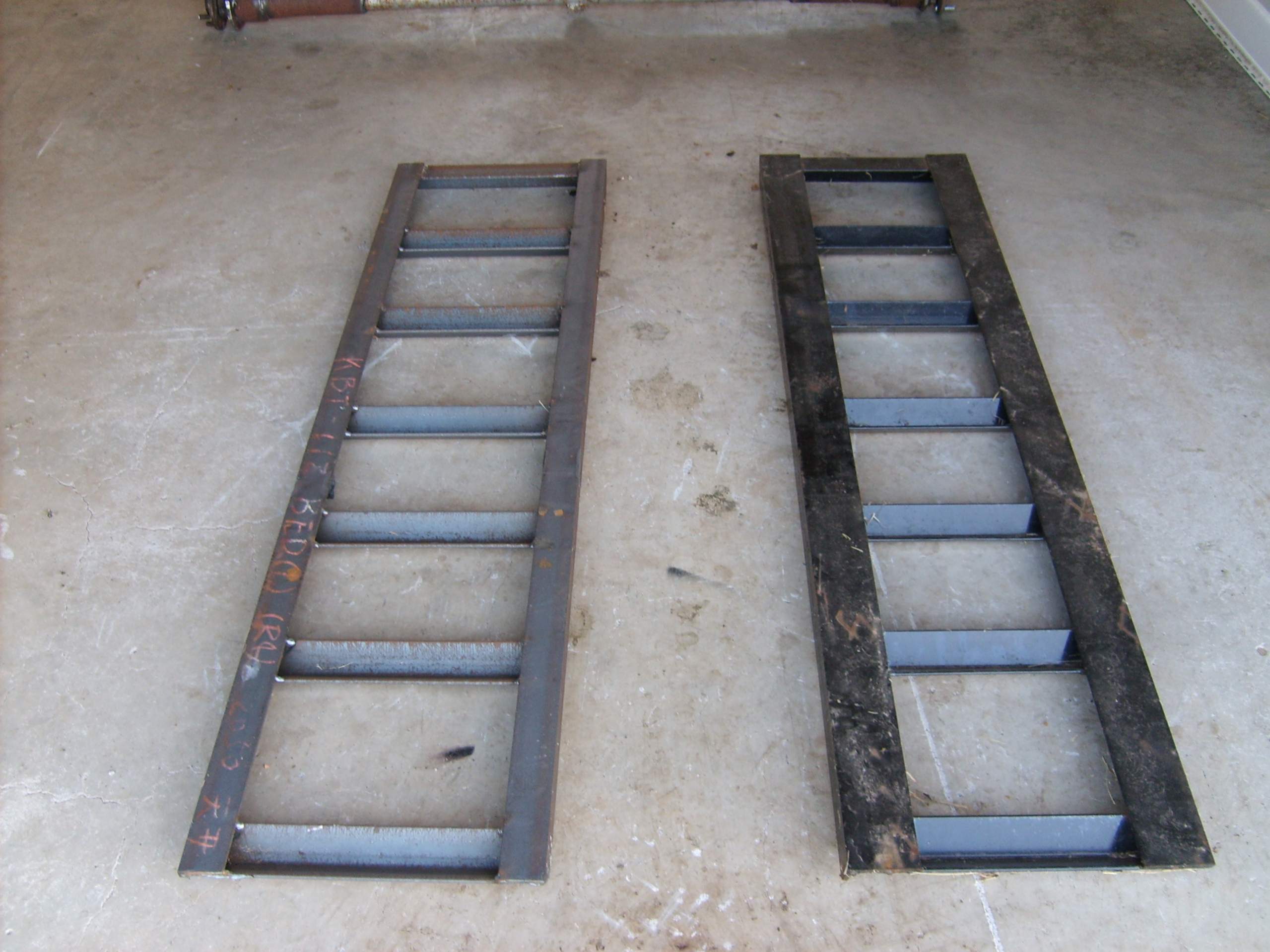

I would start with fabricating a cart or welding table. Some smaller projects could be tools to assist you while welding. I wouldn't discount your welders capability. I've got the similar welder in a Lincoln and with the right approach and know how you can do most of the 3 pt. attachments as well. When you get to thicker steel then beveled joints and multiple passes will help. All this will be shown to you by the guy that's going to teach you. What you might consider if you don't have a shop with a cement floor is an "all terrain" wheeled cart. Pnuematic tires will help there. I've included some pics of some of my stuff. Pardon the "lack of paint".:D

Nice!! I like the recycled horse shoe element! Stylish.
Hey, thanks Harold! Yes, with 5 horses we end up with a few shoes. I try to find ways to use them when I can. I look forward to seeing some of your projects that you decide to do. You've really got a nice welder there. Once you get going with it you'll be suprised what all you can do with it.:thumbsup:
