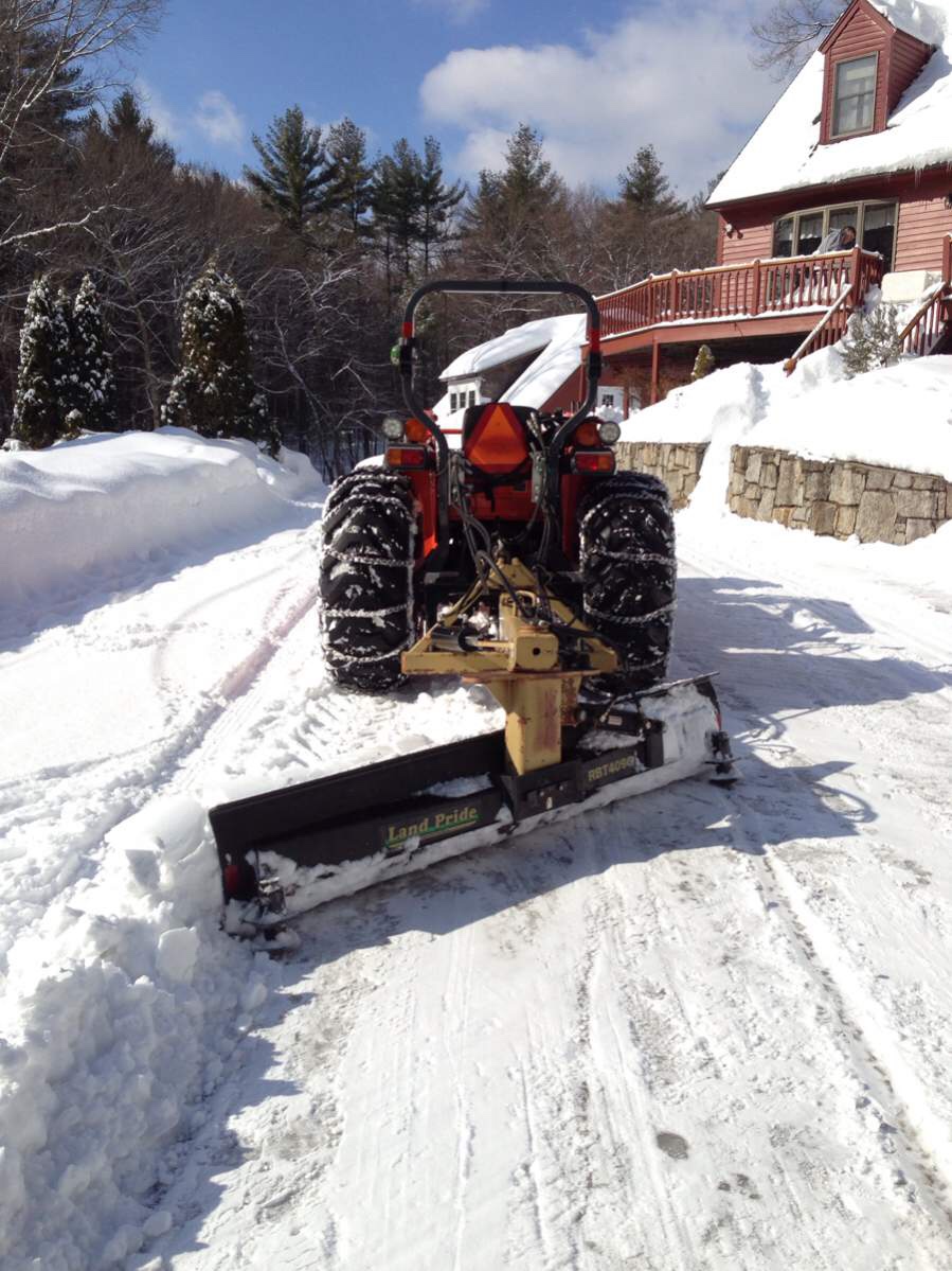

I thought I would ask if there are any tricks to set up for snow plowing such as offset, top link setting to have the shoes flat or tilted someway. I will have chains on all four wheels and plan to spray the blade so snow wont stick to it. I have already learned not to let the 3pt down all the way, but just soft set and hold so it wont go deeper. Is there a magical setting on blade rotation too?
Thanks
   / My new wepon RBT 3584 rea blade #25
Why do you say you've already learned not to,let the 3 point down all the way?
What i do, is set my skid shoes so when my blade is level to the ground the cutting edge is just a hair above the ground, leaving a small 1/2" gap or so.
Then, once the height of the skidshoes is set (I leave it there all winter) I put my top link in float, and adjust the height of my 3 point hitch to match the cut I want. If I lower the 3 point hitch, the cutting edge will scrape the ground clean, but if I raise the height of the 3 point hitch, the cutting edge will be maybe an inch above the ground, leaving some snow behind.
By floating the top link with the skidshoes set, I'm simply varying the angle, and height, of the blade when I raise and lower the hitch.
Sometimes I'll have the hitch all the way lowered. Is this not recommended?
#26
Thanks - that is what I was thinking of doing, but unfortunately I cant put the top link in float. Where I learned my first lesson was I was grading in a soft spot in the drive and when I had the 3pt too low the shoes dug in right with the blade. On the second try I lowered with the 3 point to where the shoes just hit the ground firmly (shoes set as you mentioned) and locked the height in - worked great.
Thanks again for the help

For snow I set the top link short so the blade edge is about vertical to minimize digging in. $1500 was a steal.
