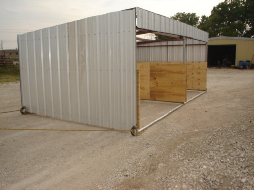

For some time now I've been working on a system to enable someone with minimal construction skills to build their own shop-shed-barn with only a cordless drill and a metal saw, skill, sawsall, portaband, chop, etc.
So last week I started building a portable loafing shed using prototype parts.
Two caveats, one the base was welded up since this is a portable shed twelve by twenty one. But everything above the skids and uprights is put together with my system. The second of course is I'll not going to have any closeups of the connectors since we're in the process of doing the legaleze to protect the idea.
I would like some feedback though if you have any. This project here would be the actual cost of materials purchased plus about four hundred for all the connectors, drawings, DVD-VHS tape etc. Only four pieces comprise the the system. As of now we're looking at a twenty four foot clear span max. So that means with this system one can build a twenty four by however long one's pocket book will stretch.
Here's a shot of it without the roof (waiting on the sheets to be cut by the supplier) being towed by my skid steer.

That looks pretty impressive. How is the expected cost (per sq.ft. ?) compared to 'conventional' (whatever that is)?
It looks light-weight, and wonder how you tie it down for the Texas wind? Or isn't it a problem?

This shed will be put in a pasture. One side will be a horse stall and the other will be a tack-feed room. The advantages of a portable is the closed side can be moved around to face the weather, north in the winter, south in the summer, etc.
There is also the advantage that one can relocate the shed as required to avoid destroying an area, share the wealth from a fertilization standpoint one might say.

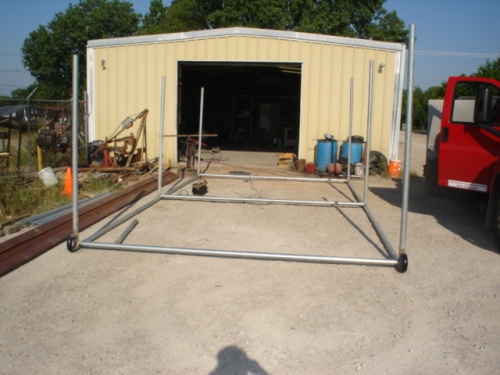

The screw and connector concept works great but I haven't figured out how to keep the saftey of the one eight pipe turns and the rigidity required for towing without welding. However I can envision a kit where one could have a weldor come in have that part welded up in a couple of hours. The notched fittings and one eighties would be provided.
Here's what it looks like when it's ready for the system.
It's the same situation as far as the system is concerned as if the six posts were set in concrete for a dirt floored shed. Or if they were set in concrete on a slab or just bolted down. Once the posts are standing it's ready for the system.

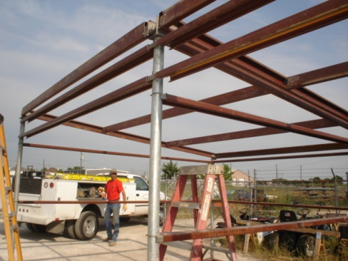

Here's a shot of the framing. Again, this is all put together with self tapping screws, no welds.

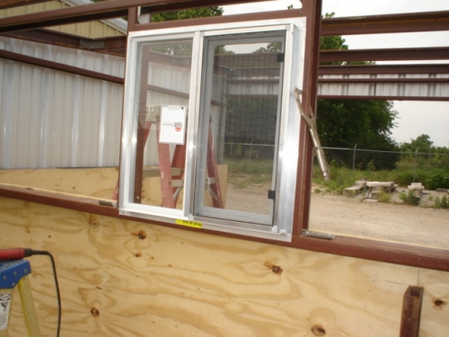

One of the drawbacks of conventional steel framed metal buildings is one needs to use conventional lumber framing methods to build an inside wall. With this system the same framing that holds the outside skin also can hold the inside wall. There's room for using conventional insulation and wiring etc.
Framing in a window or a door is really simple too.
