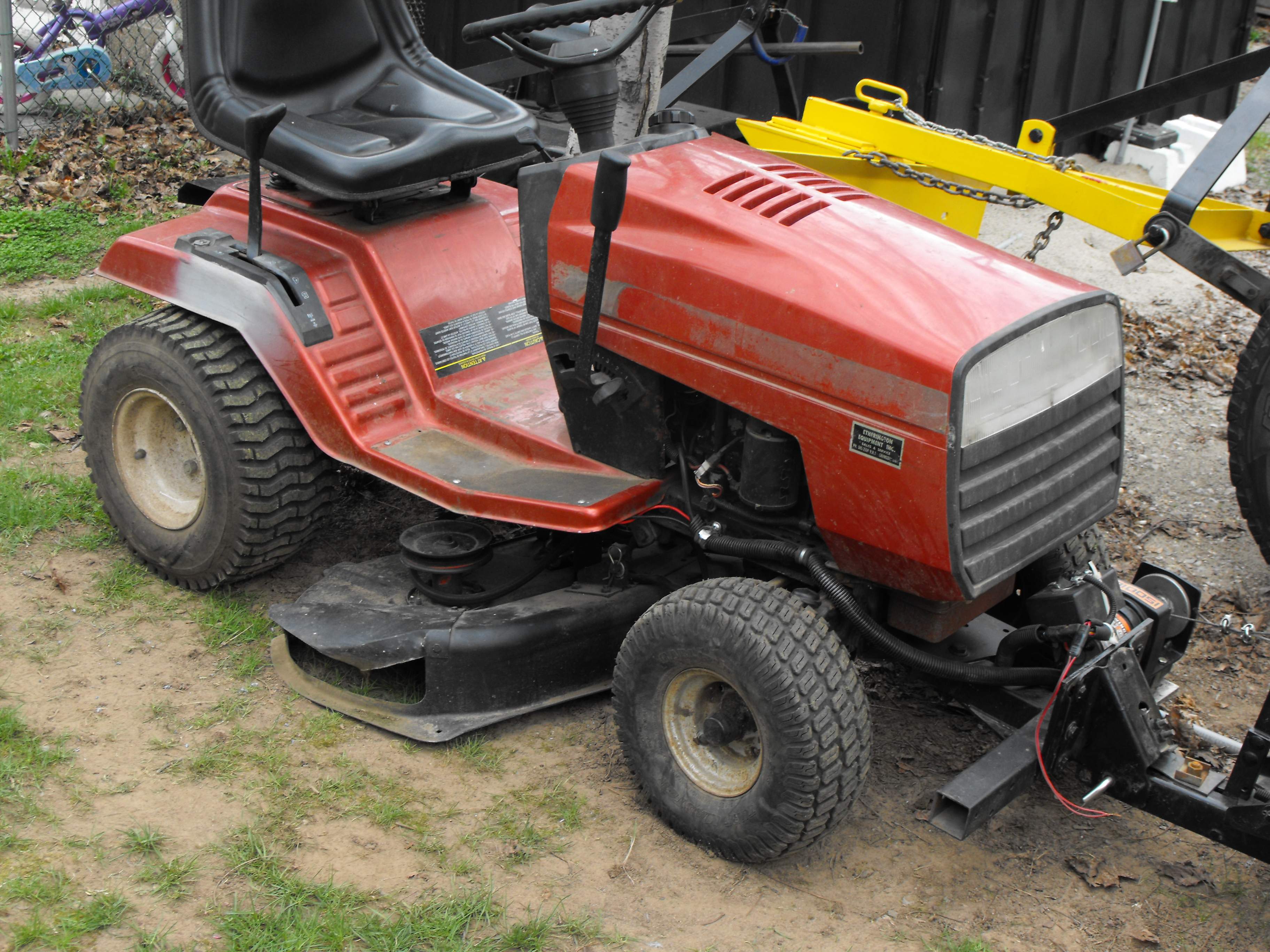

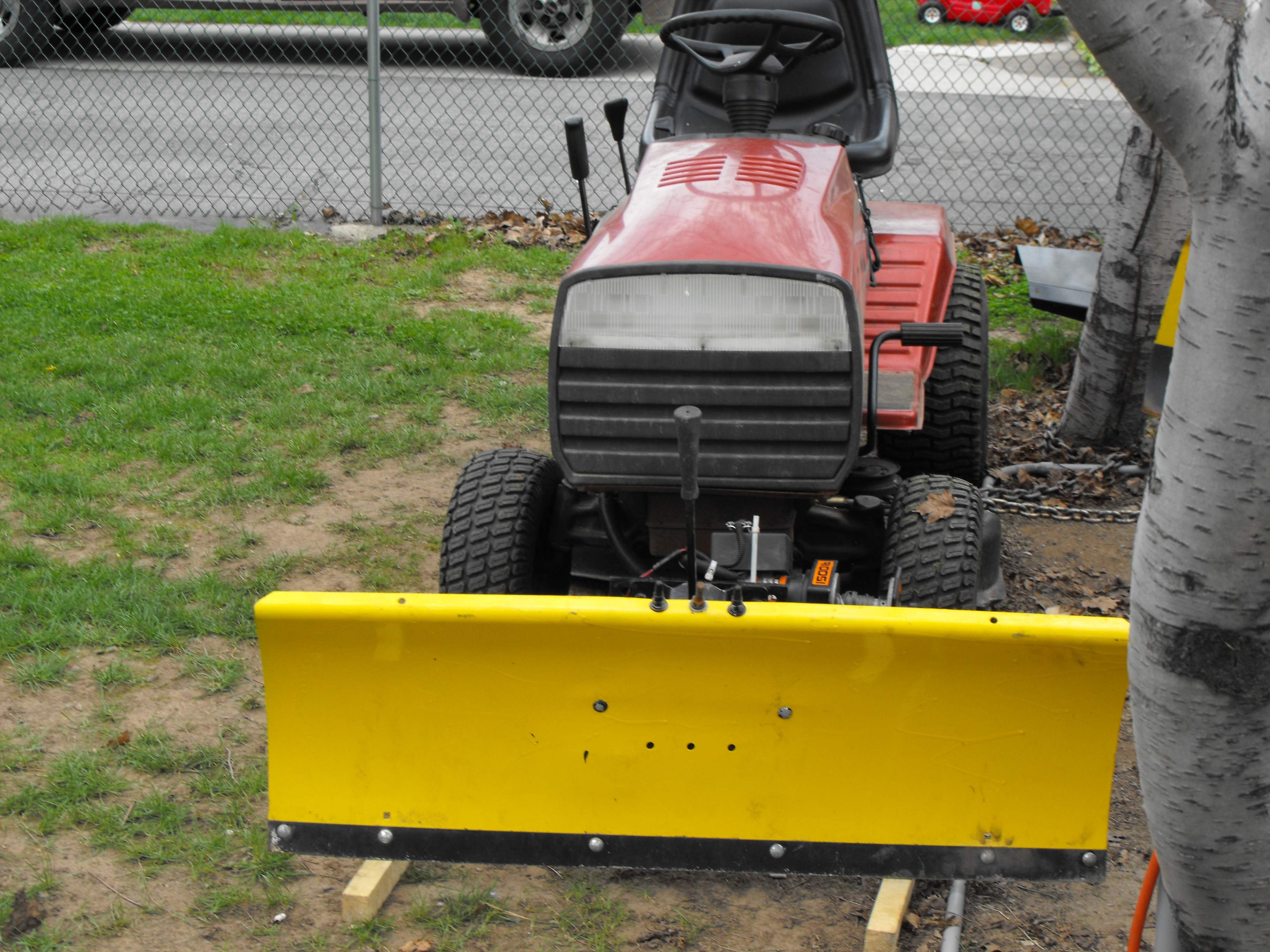

David!....do you plan on installin' a lift/angle cylinders on that Great lookin' heavy duty plough?....I agree... it's lookin' real good everytime I see your tracked machine....nothin' wrong with paintin' it green neither.....my favorite color... I really always liked John Deere green/yellow....I'm not too sure you would use their two tone yellow trim...but....
would sure look good on that nice old plough of yours....of the two I previously owned and have since sold....the 48" graderblade was red and black and my first bought used little Craftsman 42" snowblade was painted black...I repainted them both usin' a rustproof gloss yellow and trimed the wear bars with the same rustproof gloss black.....one thing about the color change... most people noticed me comin' and stepped out my way...sometimes I had to honk the horn for the elderly.:D keep up the good work.
"David" your doin' a fine job as always..first pic is the 42" Craftsman and in the second pic you can see a bit the 48" heavy duty graderblade..I didn't think it be nessessary at the time to use grey primer.... so a little red is shinin' through in some places.... to you and your family.... please take care....Ampa<> :thumbsup:

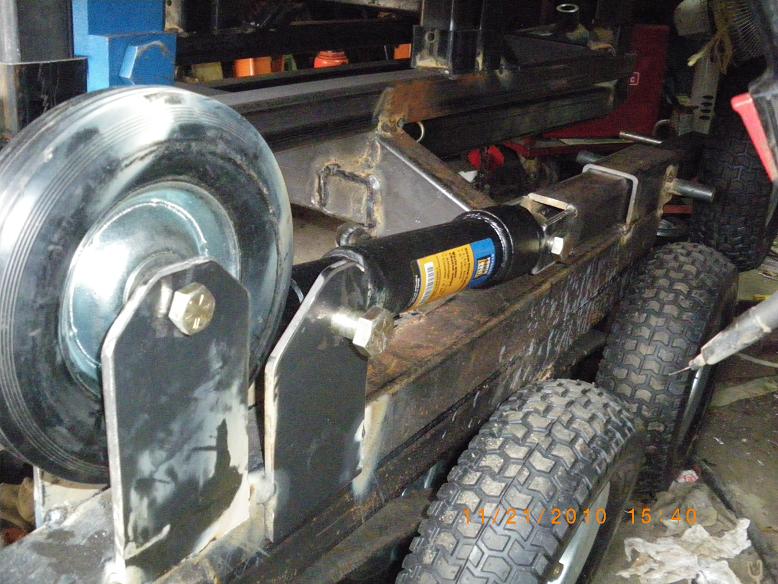

With the tracked dumper, I have ditched the spring track tensioners and may try usings small hydraulic cylinders filled with grease. Pump them up to tighten the track.
You'll still probably want some type of spring release on the tensioners, otherwise when a rock or something gets up into the track it won't have any flex, which inturn could cause major issues.

The front and rear road wheels are spring suspended, as well the tires are air filled so they should allow for some flex. My target speed is in the 5-8mph range so hopefully it will hold together. I picked up two 6inch stroke snow plow cyinders to use as track tensioners. ($31 ea)

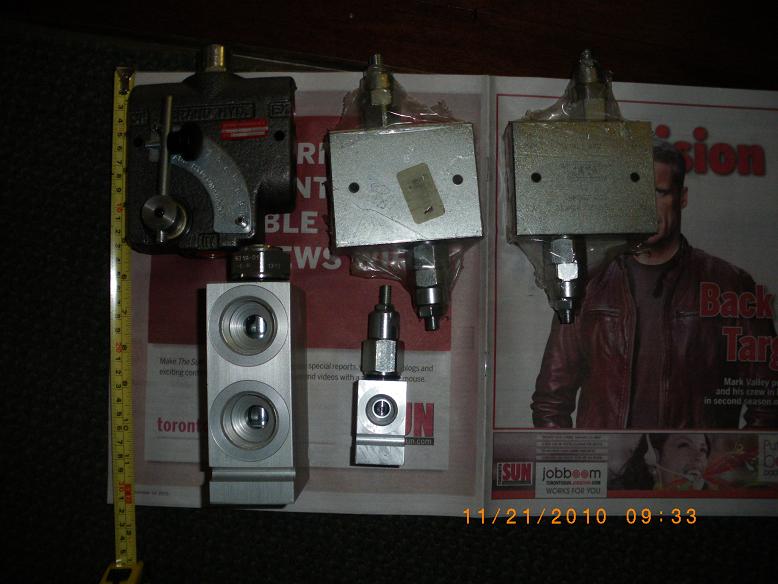

Managed to spend a few hours in the garage today as well as spend $600 on some Pressure relief and directional control valves. I supersized everything in case I find a bigger engine and can crank the pump up more down the road. I installed the snowplow cylinders to tension the track.
