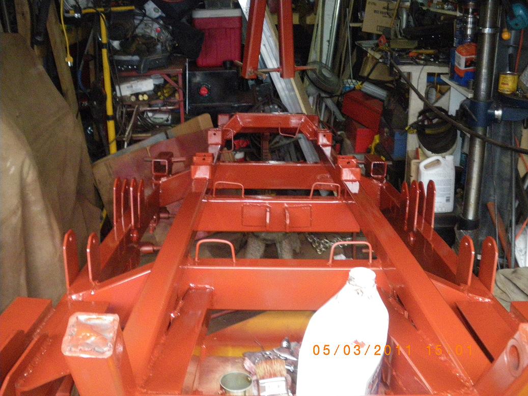

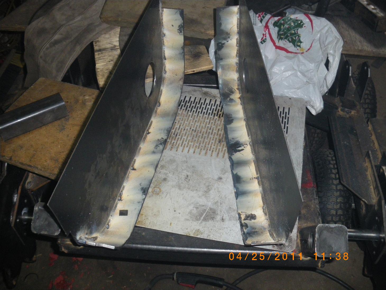

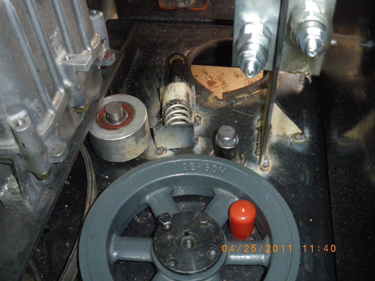

Anyway, here is a shot of my homemade belt tentioner for the double belts that will drive the pump. As well, now that I am running reduction gearing for the track motors, I built chain guards. Finally have the main welding completed and have primed the frame. Not easy manuvering when working out of a shoebox. I can't believe its May and still only +7 C 45F. Not to mention its raining.
I should be able to start buying hydraulic hoses in two weeks if I can keep motivated.

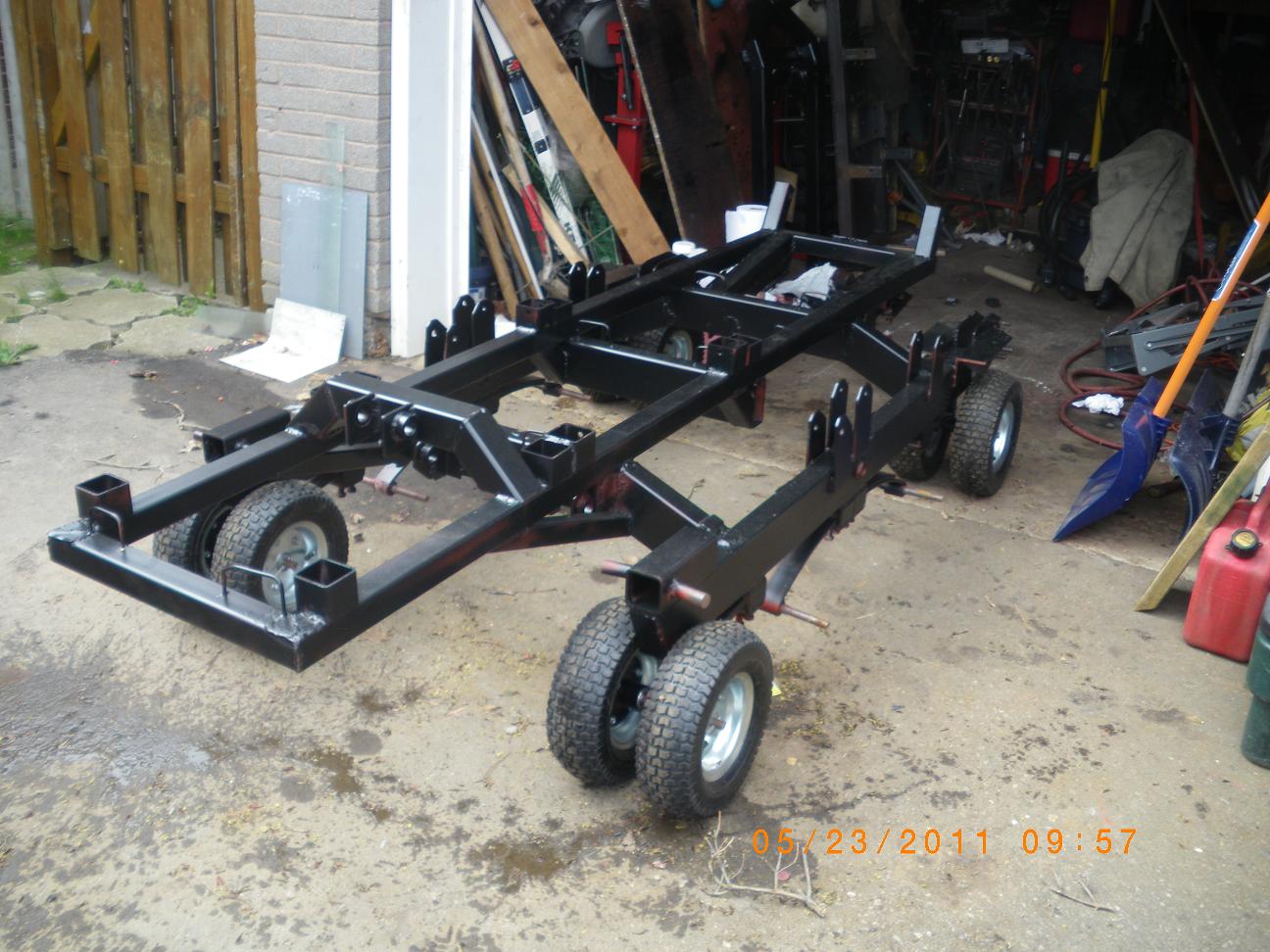

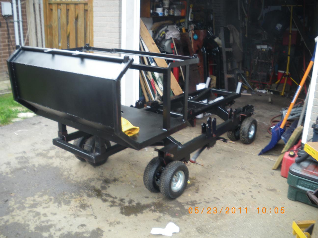

I am slowly putting this thing together. Working in a shoe box means continuously moving things around which will get harder and harder as i start adding weight to the machine. Here is a shot of the frame painted and then the cab installed. Bringing the machine outside shows all the spots I missed with paint. Oh well, I am sure to have lots of touch ups as I go.
