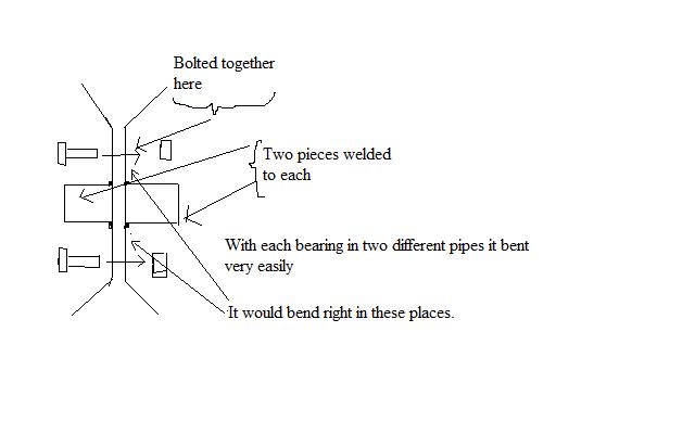

David Devuono, you might want to be careful of those wheels. I got some of those type a while ago for a wagon with two 55gal drums of water on it. After I put it together I tested it by hand with some water(not full). If I turned, the side pressure bent the hub. My wheels were rated at 340# apiece or something. I am not saying that the wheels you got are built like the way mine were but mine looked exactly the same. I did also have the bearings slide because they were not seated against anything. On mine the hub is made of two pieces of sheet metal with a short section of pipe welded on each, in which the bearings are pressed. With it just bolted together it tends to bend. I will try to upload a drawing what I am talking about. I am just telling my experience with those type of tires. If your tires won't get any side stress it may not be a problem or yours might be built better. I also thought that it the tire got low or had a lot of weight the hub could cut the sidewall near the bead.
I just thought I warn you because I'd hate to see that machine fail from weak wheels.

David Devuono, you might want to be careful of those wheels. I got some of those type a while ago for a wagon with two 55gal drums of water on it. After I put it together I tested it by hand with some water(not full). If I turned, the side pressure bent the hub. My wheels were rated at 340# apiece or something.Tucker Stevens
How many of the tires did you use, I aggree they are a compromise but with 16 of them on the ground they will only need to support 65lbs each. The bearings will need to be changed to double sealed bearings at $3 a piece x 2 per wheel but I plan to run it with stock bearings for the first year. I am going to change out the bearings on the tires that tension the track first as they will have 140 lbs a piece on them.

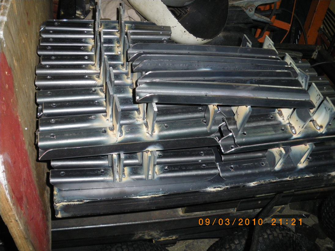

I am not too concerned with sideways slipping. In fact I am working each track pad so that it is streamlined in the sideways position to aid in turning. Each of the 120 trackpads is taking about 20-25 minutes each to build, not including painting. I need about two more good days to complete the tracks.
   / My Ride-on Tracked dumper #67

Hello,
I had just four wheels on the cart and they were returned.
Due to the quantity of wheels you have bearing the weight, the wheels may not be a problem.
I'd just thought I'd make known my experience so someone else didn't need to make the same mistake.
Changing the bearings sounds like a good idea.

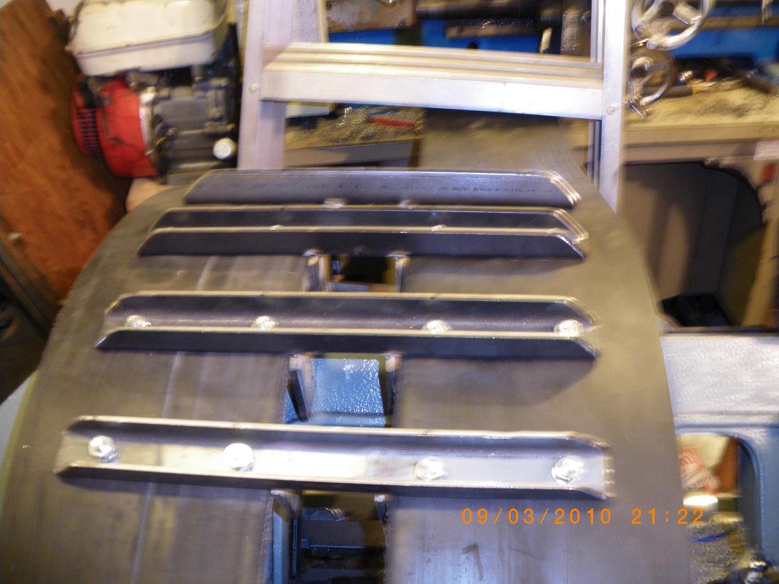

I think my problem with the wheels will be, due to not being solid the track guides may try to ride up on the wheels, especially is a wheel should loose some air. I will be using at least three different items to keep the tracks on. 1- Central track guides on the Grousers run between the wheels, 2-metal guides to keep the track guides aligned at the drive gear and 3-outboard bumpers to restrict sideways movement.
#70
A shot of some 60 track plates I made up on the weekend. Also a shot of a track mock up I am using to shape my drive gears. This side will be contacting the ground. I have come to the realization that I need the gear teeth to come to a point to ensure the track will engage even with some debris in the tracks
