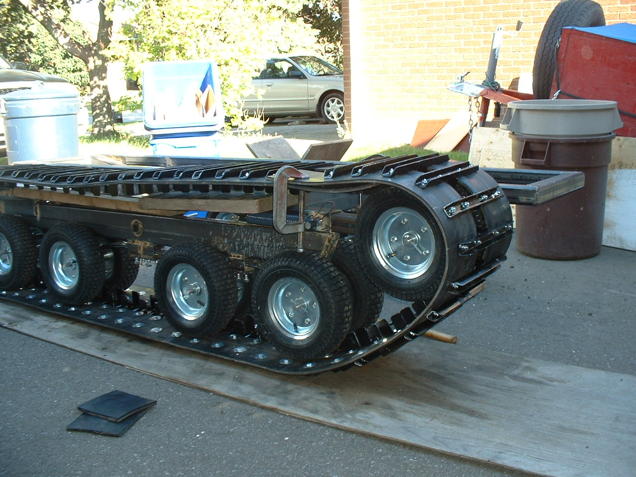

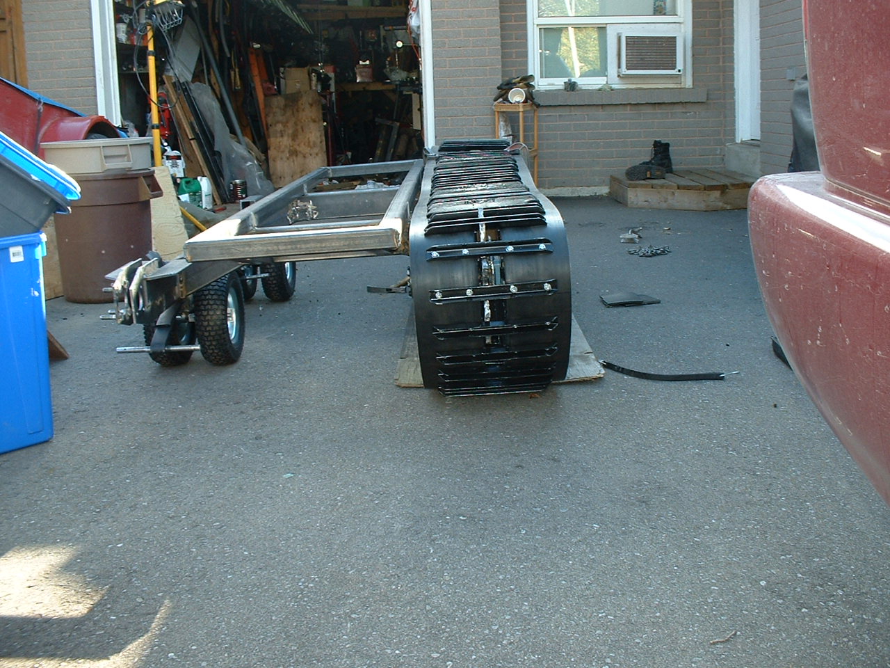

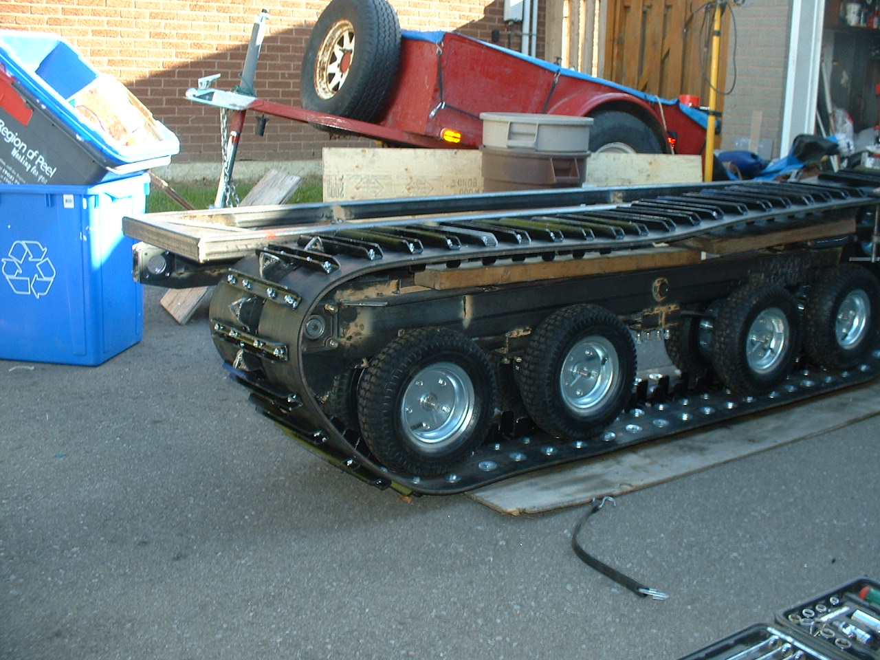

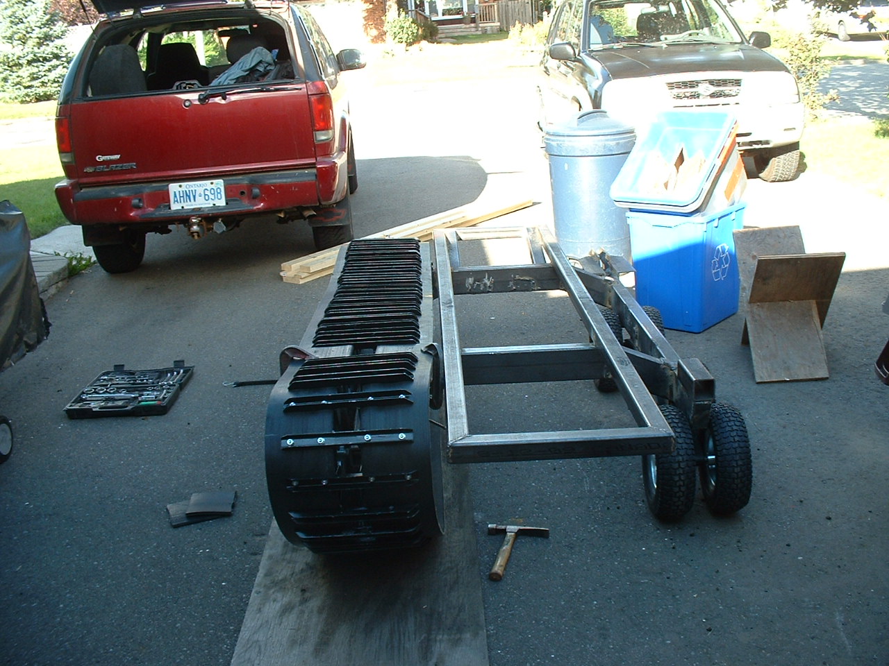

Worked my but off the last couple of days to get a track on and see how things will fit. The track weights approx 150 lbs depending on how strong or weak I am this week. Its, if nothing else, going to look good on those tracks. I have a weeks vacation coming up so look for more progress in a couple weeks.

   / My Ride-on Tracked dumper #77
That is going to be one mean machine! I'm excited to see the progress. Thanks for keeping us all posted on the project.
   / My Ride-on Tracked dumper #78
that is so cool! it definatly takes a lot of dedication to do that. Excelent job! :thumbsup::thumbsup::thumbsup::thumbsup::thumbsup::thumbsup:
   / My Ride-on Tracked dumper #79
Look good nothing......
......it's going to look awsome on those tracks! Nice job.:thumbsup::thumbsup: My hat is off to you sir.
