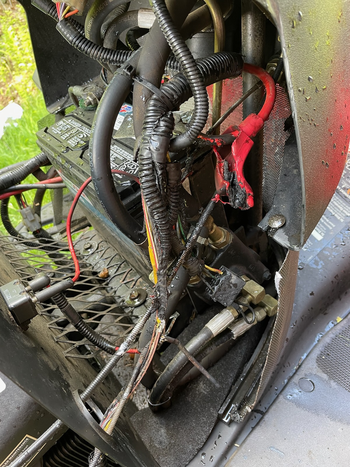

So my wife called from our place up north- she took the legacy out for the first time this spring and said it went on fire around battery compartment- Any ideas as I am not up there- thks

Yep, look like a cable. possible a throttle cable came in contact with the battery positive terminal. See attached.
The arrow points to a bare cable.

Suggest removing the battery so there's no power to any wires whose insulation is compromised.

thks- so if I replace postitve cable and make sure it does not contact anything I should be good>>

A thorough look over is needed especially if this machine is parked indoors.

It looks like bare copper wires and melted insulation in the bottom of the picture as well. You're gonna have to inspect it all closely. But get that battery out of there before you continue.

I would agree. Will need extensive inspection and repair of the wiring harness. Or wiring harness replacement since there is a high possibility that there is damage from shorted circuits in other parts of the mower at this point.

Yep, new wire harness and reroute that metal throttle cable elsewhere away from the positive terminal for sure.

I don't see the need to replace the harness. Just inspect the wires and connecters. Splice and cover wires that are damaged and replace sections that are burned away.
