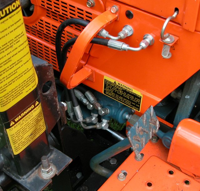

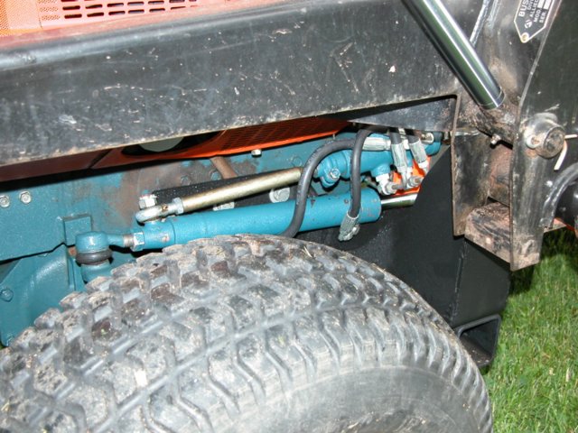

I've got an '86 or '87 B8200 gear tractor, bought used with 500 hours about ten years ago... delivered just after a blizzard that taught me how to use it (my first/only real tractor) and the loader, to remove 750' of 3' snow in order to clear our lane and get it "home". It also taught me I needed power steering, and I got lucky and found a Kubota USA aftermarket old new stock PS kit ($700 from a dealer via Ebay) that would have been an easy install except that the Bush Hog loader bracket was in the way, so I had to cut and reinforce that. It plumbed into the hydraulic block, no problem, and doesn't interfere with the other hydraulics, really. I could send pictures of my tractor if you need help in figuring out how to put it all back together. Since Kubota sourced the PS kit here in the US, with only brackets etc. made for the particular tractor, I would think any good fabricators could do the same.
For my needs, it's a great little machine.
