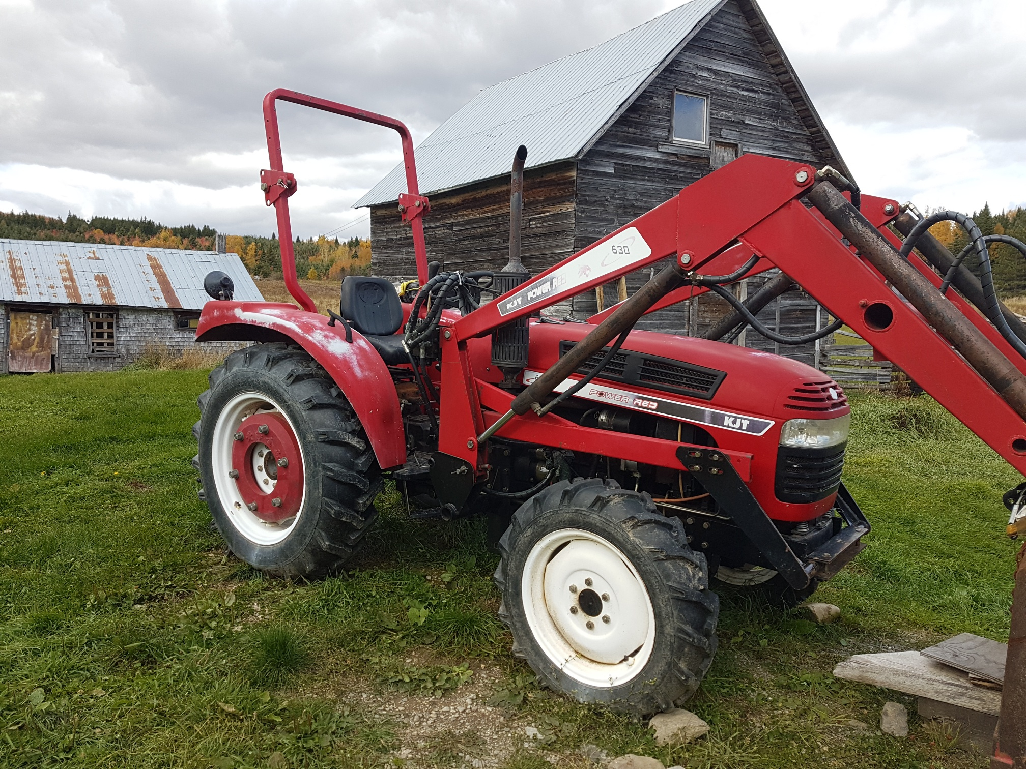

Hi, I want to help a friend who owns a KJT 6030 chinese tractor (2006 I think). Supposed to be 60HP. He needs a new hydraulic pump but I can't find anything about this tractor online!! A website listing pretty much all chinese tractor has KJT in there but no link or information.
It looks like a Jinma 604 like the one in this link but can't find much informations on this one neither:
[Hot Item] Tracteur (JINMA 604(4 RM))

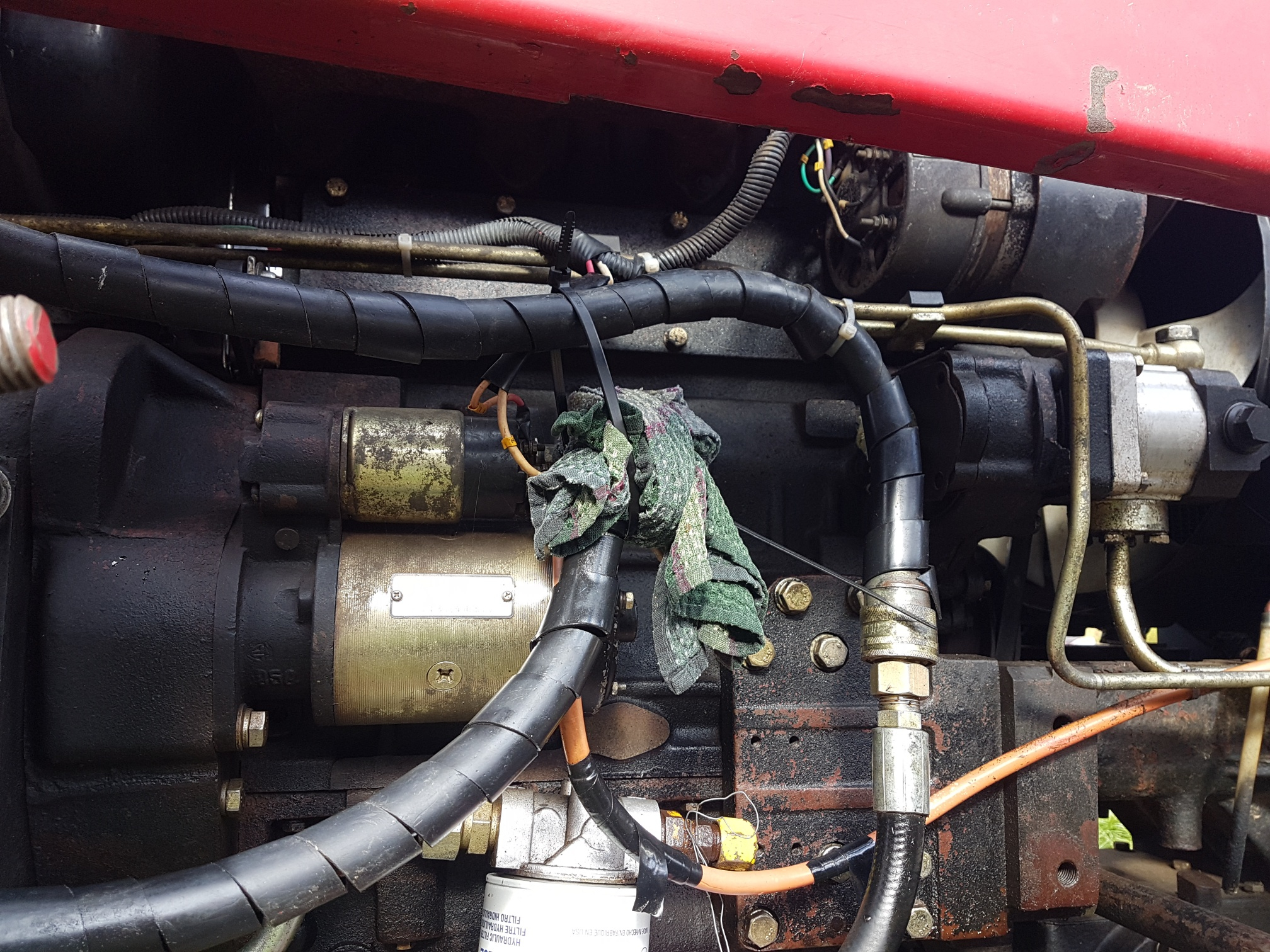

So here are some pics of my friend's 60HP KJT tractor. The hydraulic pump isn't there (he took it to a shop to get it checked and the moron there lost it!) Hope we can get informations here to find a new pump and get this thing running again.

That would be the first 60 HP three cylinder engine I've seen. 40 HP tops. It looks just like my 30 HP TY395 engine.

For all practical purposes that looks like a Jinma tractor all right. A lot like my 2006 284, only bigger with more stylized hood and fenders. Jinma made tractors for a lot of different "brands" and there were differences between all of them but the base tractor was the same. Jinma made their own up through the 500 series that indeed were listed at 65 HP.
The 630 on the loader decal is just the number of the loader. Is there a number on the hood decal? In the pictures of both sides it is blocked from the view by the loader arms. Even so it may not be much use because the name KJT is not listed here: List of Tractors built by Jinma for other companies

At any rate, all is not lost, just more difficult. You can measure the bolt pattern where the pump mounts. Then you can determine what was on the drive end of the pump. Was it a gear, at tab or some other design. Then you can measure from the mounting face to the point where the pump engages the drive. You want to be as accurate as possible with your measurements. Use metric. If possible watch the drive gear and turn the engine with a wrench in the direction it normally runs. What way does the drive turn?
This much info should narrow the search greatly. There may be other things like pump size and adapters needed to get to the hose fittings left on the tractor.

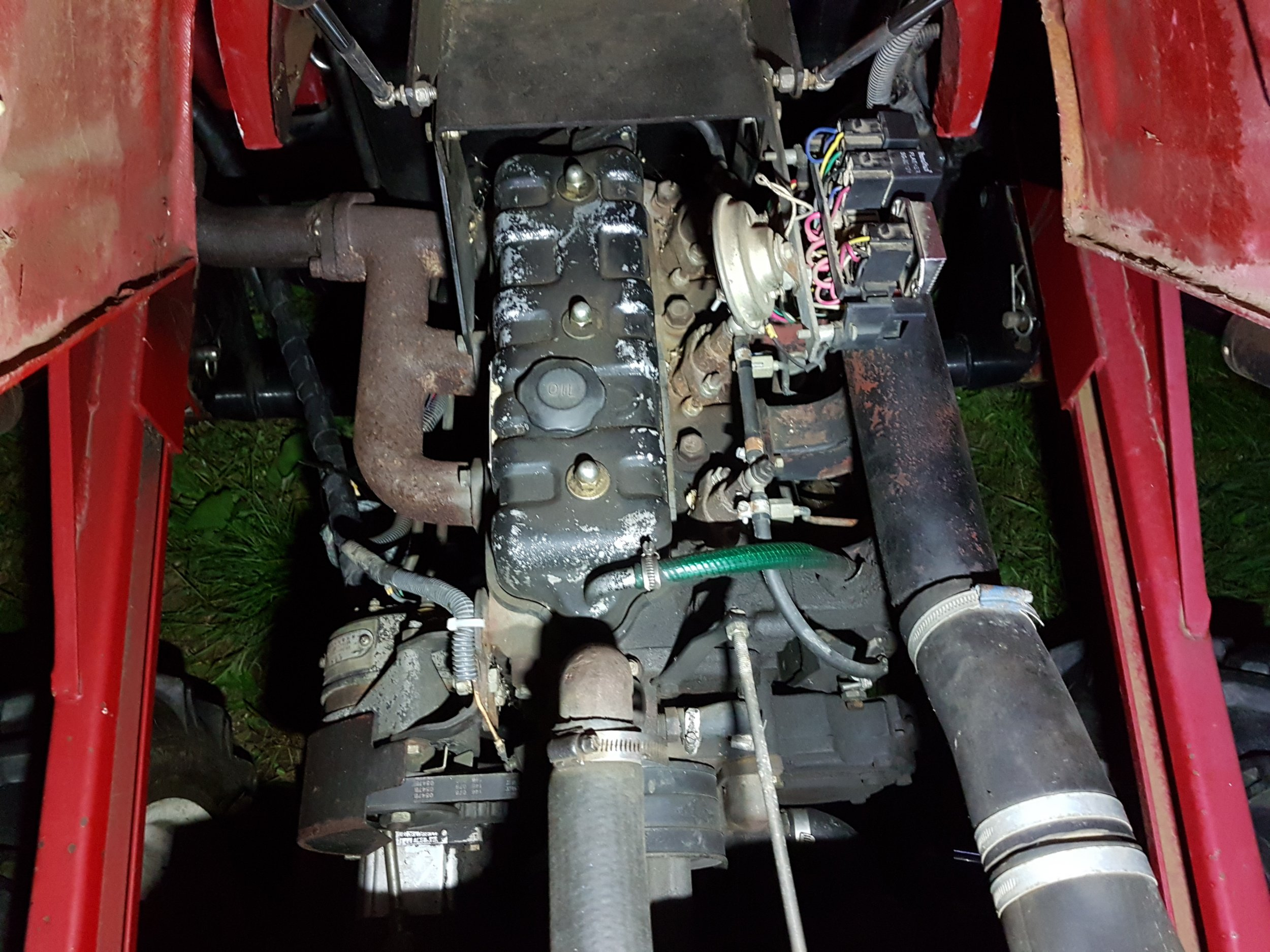

Thanks! Bob's information about the TY395 engine, the Tang drive and the links for the hydraulic pumps helped me a lot. And Piper184 was right, it looks like a Jinma 284 (same logo on tranny and seat) and some of them pretty much have the same hood. But from the pics I saw, they look smaller than the KJT 6030. That KJT has the size to be a 60HP tractor but you're right, this 3 cylinders engine (which should be 1.5L) isn't big enough to be 60HP. 40HP is a good guess.

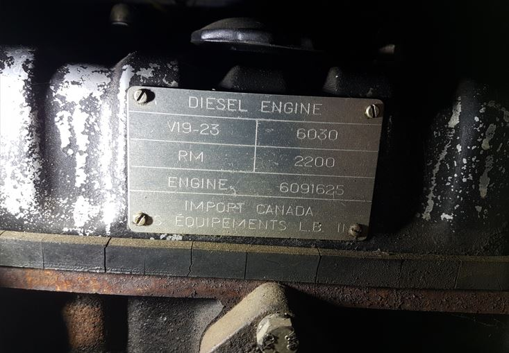

Here is the plate on the engine. I haven't found anything with the informations on it so I forgot about showing it here.

Unfortunately that's not the engine builders nameplate. The importer replaced it with their own nameplate, or placed their own over it. Doesn't seem legal to me though because it doesn't state engine specifics for environmental purposes, for one thing.

Yeah, good idea. Maybe they put this plate over the engine nameplate so I'll take this plate off to see if there's something behind it next time I'm going there.
Maybe they tried to hide the fact that this tractor is only 30 or 40HP and they where just telling BS or letting people think it has more HP because it is quite big.

A typical Chinese engine nameplate will look similar to this:
In this instance, 65 kW = 88.3 HP.

Here is my engine data plate. Not much use except for comparison. Bob is right, at least here in the US I think removing a plate with EPA info is a no-no. At any rate they are supposed to be riveted or welded on, not held on with screws. My guess is the importer did this and the original is long gone. And anyone who does this is not going to freely share the info they removed.
When I was looking for a tractor there were several "importers" that would take your money up front, then when they had enough orders for a container full would send the $ to China. Then everybody waited until a ship showed up somewhere with that container. Then you had to arrange someone to go get your crate out of the box and get it too you. That was too risky for me and several of the importers seemed to be kinda shady to deal with. I was really relieved when I found a dealer that had tractors in the crate on the ground and was willing to ship it without putting it together first. Saved me enough that I could afford the shipping and I got to put it together.
