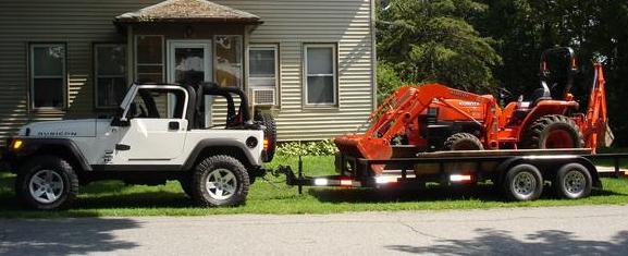

I tow my L3400 with backhoe with my Jeep Wrangler Rubicon. Place thr tractor on the trailer so you only have about 350 lbs of tongue weight. That will keep your headlights from shooting in the air.
With trailer brakes and knowing your limitations you should be fine. Power have never been a problem and this tows better than my Dodge Dakota with a v8 in it. Go figure.
Trailer brakes are a must! Drive Slow! Remember what you have back there and be aware of your surroundings. Like driving a rig, your not going to corner fast, stop fast etc but it doesnt mean you cant be safe.
