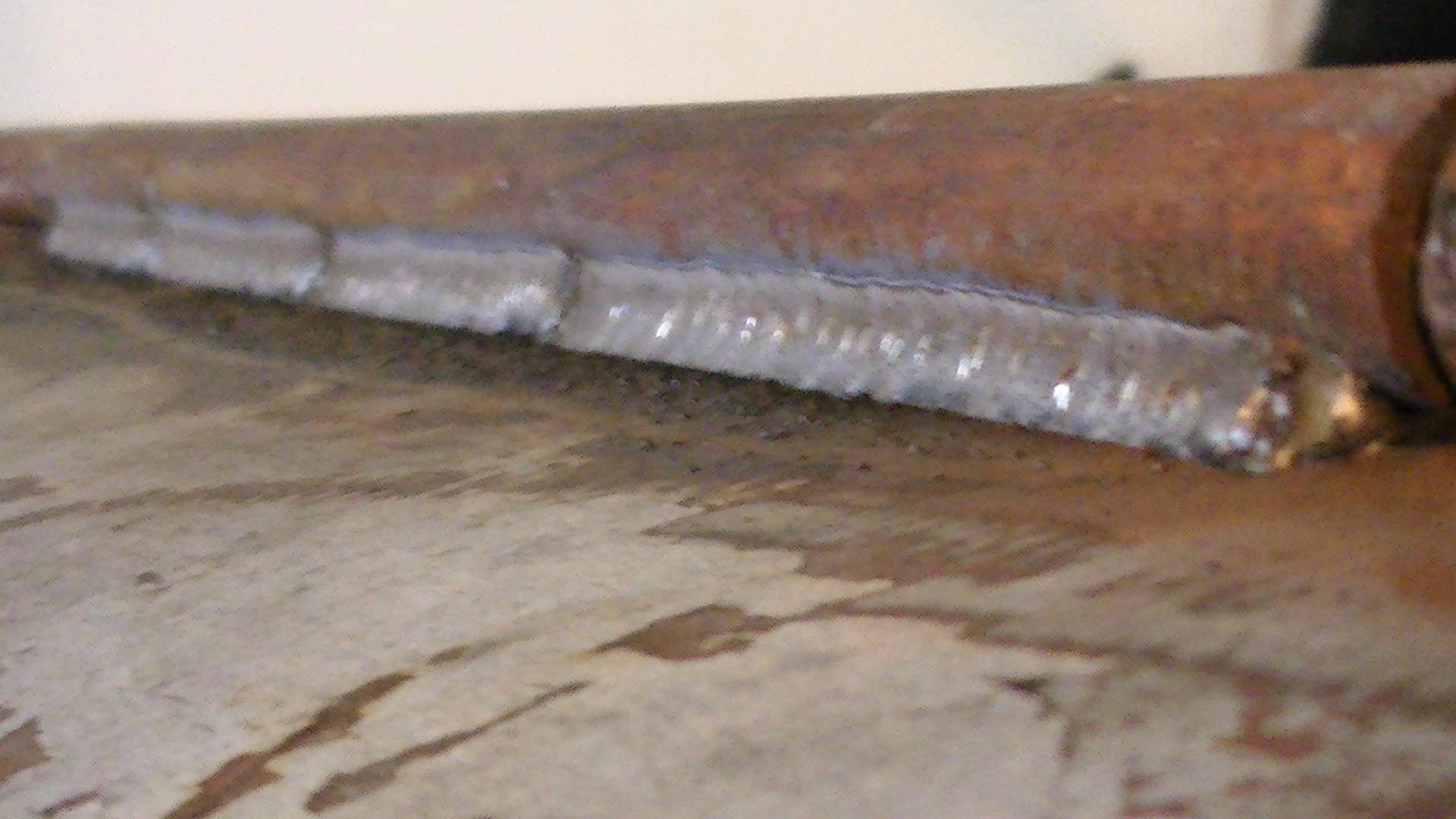

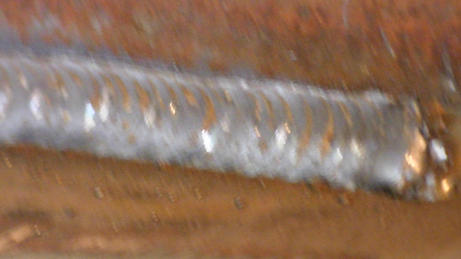

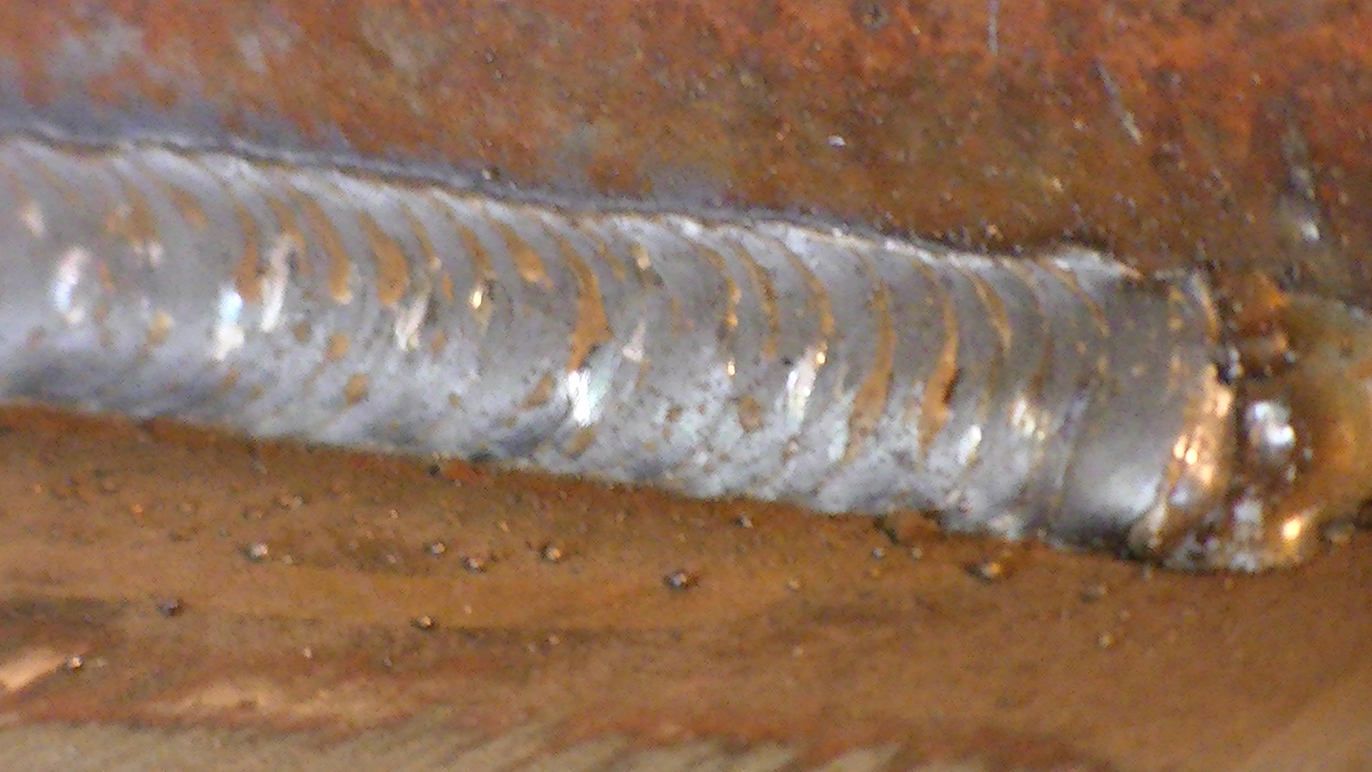

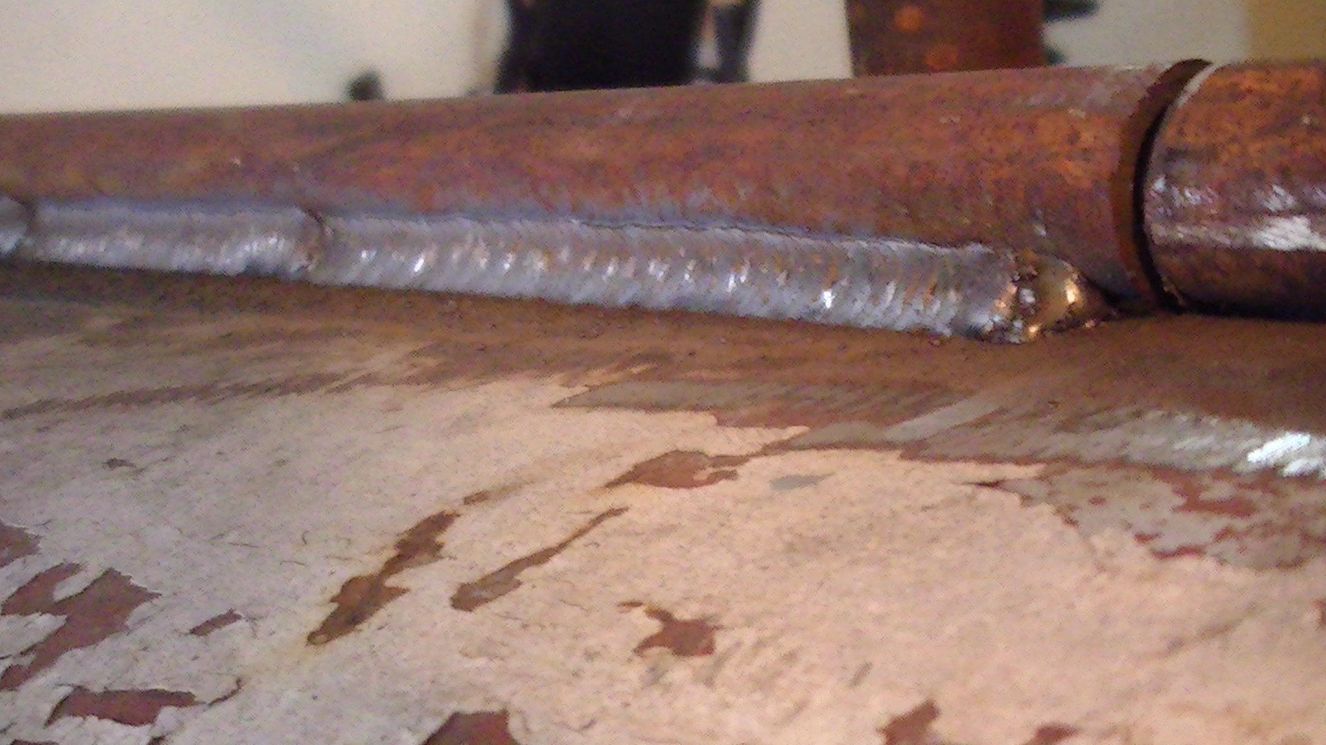

With the IMIG 200, I have easily welded 22 gauge with .030 wire. Using the arc force control (inductance) feature, it allows you much greater control of the arc. Lower end, smaller transformer units will not have this feature, plus they weigh a lot more. The lightweight inverter power unit of the Everlast I MIG 200 is much more efficient and does not require as much power to run. It offers much more flexability, and better duty cycles. The arc force control makes a huge difference, especially in out of position welds(when ever you aren't welding with the weld running flat in front of you) or with the aforementioned thin gauges. If you never had it, you probably don't know what a valuable tool this is. Spatter can be tuned out as well to be non existent.
Here is a weld on 1/4" I made with an older I MIG 160, using .030 wire. I used it to weld to some tubing that I used to make a hinge on a barbque smoker (which I sold yesterday for a nice $2350 btw).
