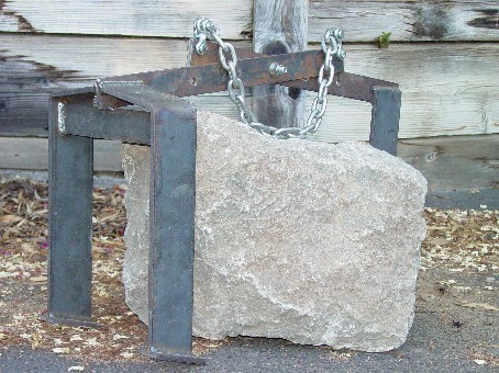

In some posts in projects, I showed some pics of the placement of 50-60 tons of pretty large rocks on a slope for erosion protection.
About 5% of them got away and went WAY down the hill into the woods.
To get some of them back (from a location where equipment CAN'T go) and to get some others from various locations where my cables and/or chains can reach, is there an EASY way to hook onto them?
Getting a chain as tight as possible, which is really hard, works after 4 or 5 attempts on the angular ones, and less often on round ones.
Is there some type of tong device with 3 or 4 jaws that could be used? Similar to log tongs?
Most of the rocks to retrieve are 18" to 30" average dimension. My PT can easily lift and pull them, but keeping the chains or cables attached would avoid multiple climbs down and back up the slopes to reattach.

I don't know how well this will work dragging rocks uphill, but this home made rock grapple works great lifting rocks with the FEL to build rock walls. It's built from scrap 3/8" x 2" and 3/8" x 3-1/2" barstock. It can fit over a 16" x 24" rock. The heavier the rock, the tighter it grips. Lift from the center of the chain.

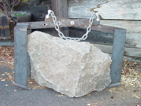

Another View.

That looks like it would work great on a lift, but my concern would be that when the chain loosened as it might going up the hill, the rock would come out and roll back down..........
Looks good though for straight lifting....

BX2230Dude,
That's a real /forums/images/graemlins/cool.gif grapple dude!
Something like that would work for logs too I bet...
But I think the chain link fence idea wins the prize... /forums/images/graemlins/smile.gif
