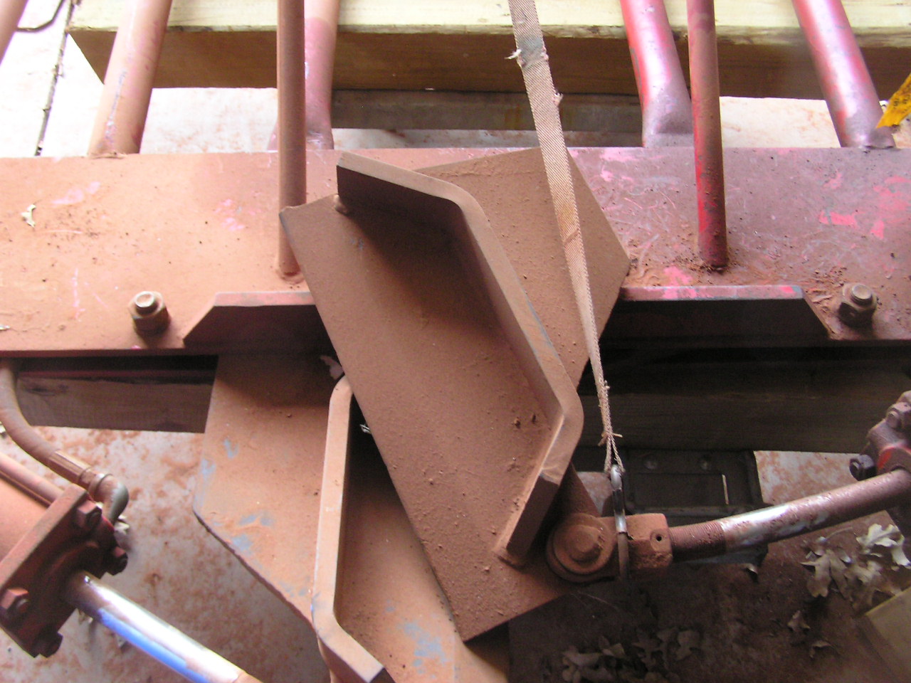

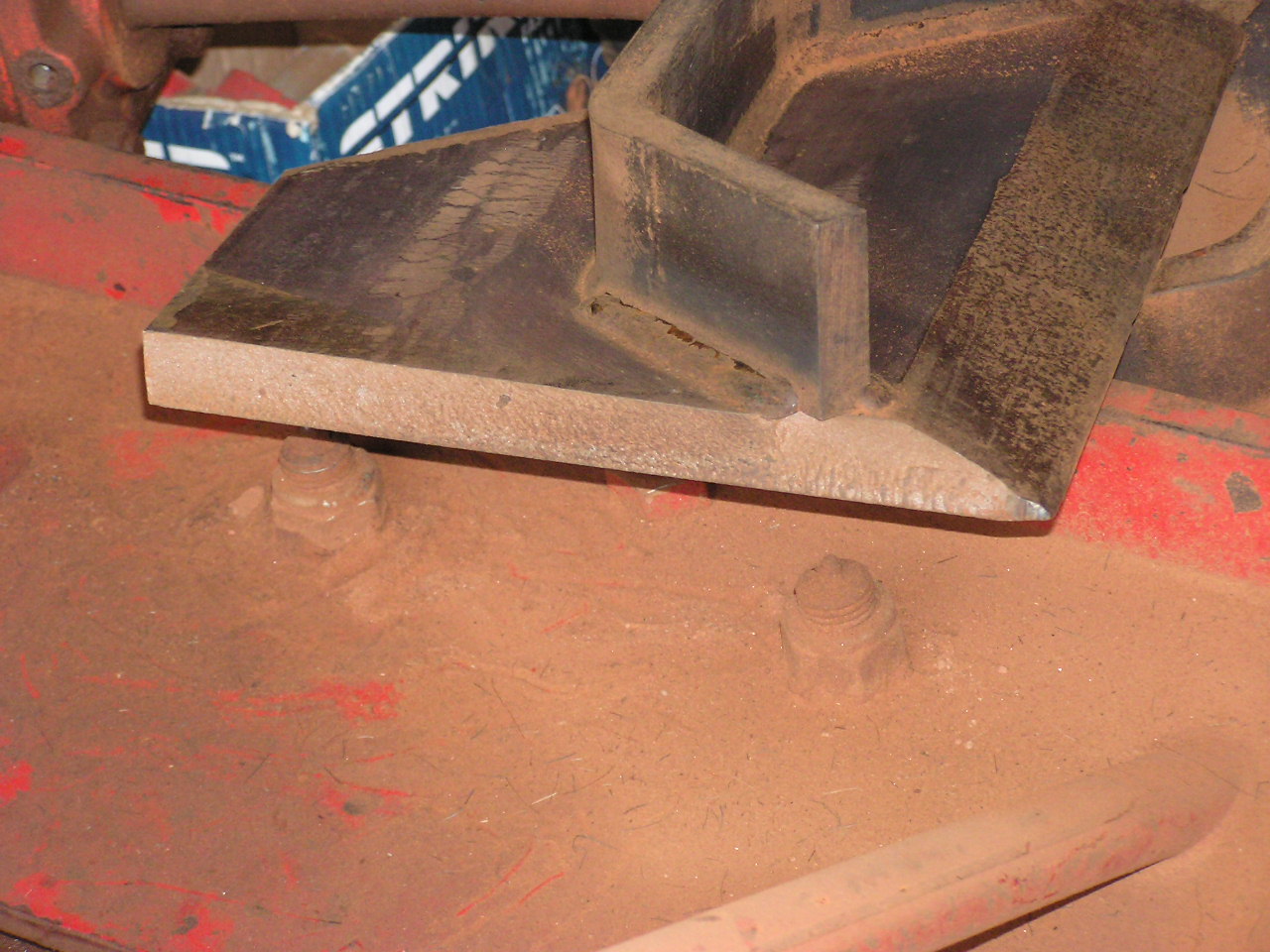

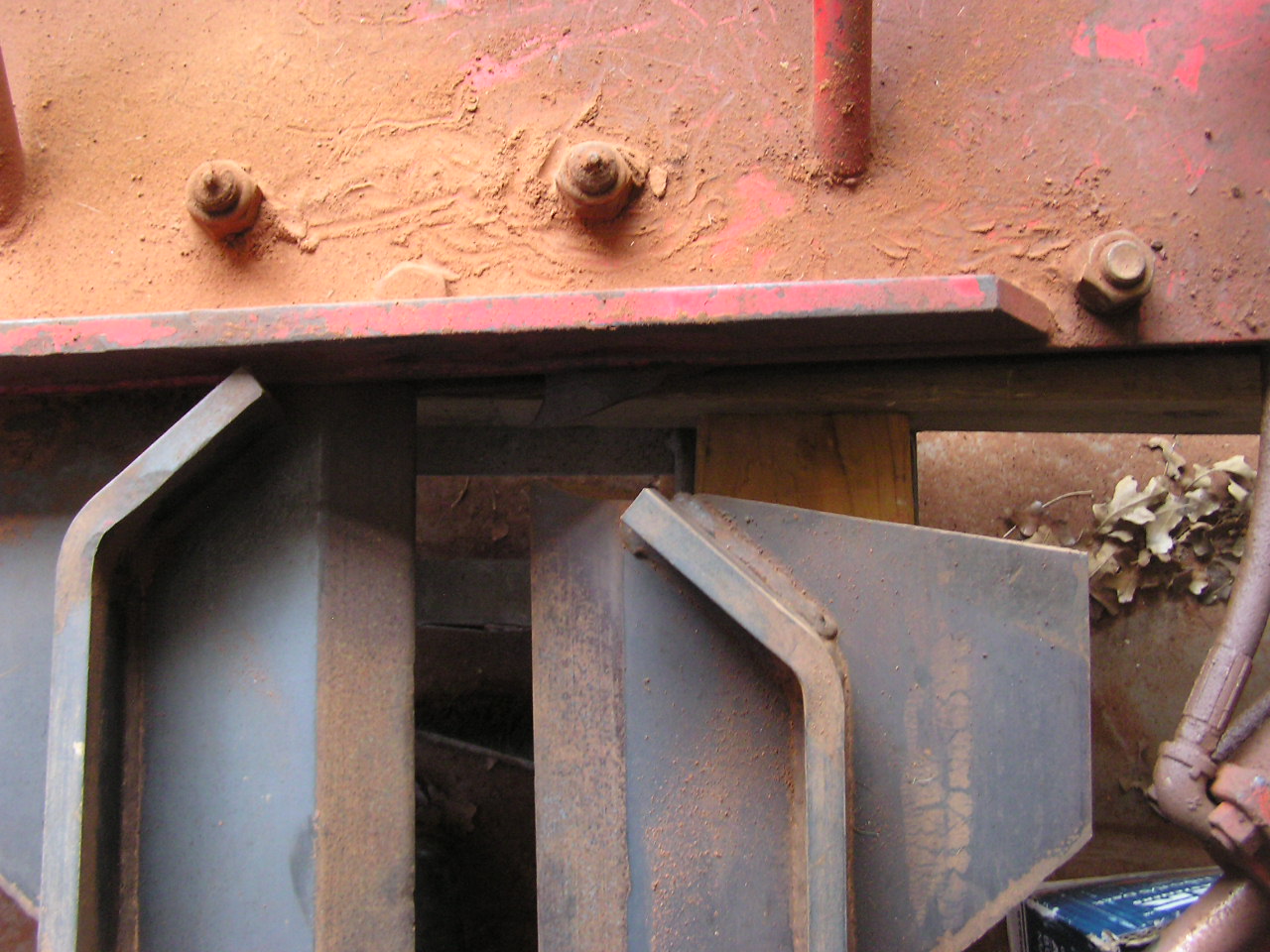

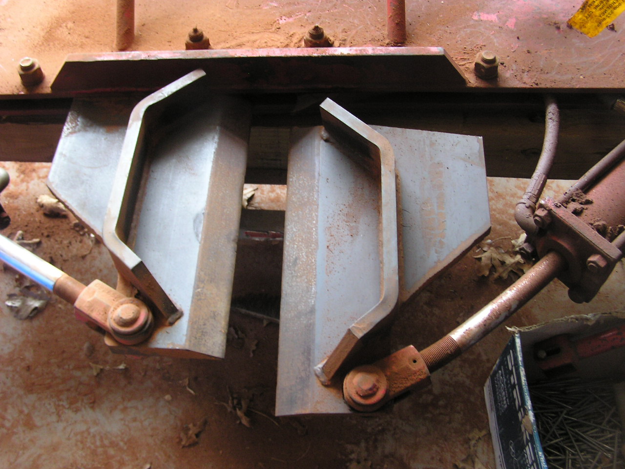

Old cedar tree cutter broken blade. It is 1080 hard, 26 mm thick. About 12" x 25".
Thanks in advance.
   / Need Advice, Would you try to weld this? #2
I would clean the steel real well and grind a chamfer to get good penetration. I would TIG weld it if possible. There are some very good welders here that can give you better advice I'm sure.
   / Need Advice, Would you try to weld this? #3
Are you sure it's 1080? Seems odd it was welded on before. That might be why it broke. If it is 1080, that's very high carbon and you'd need preheat and post heat as well as special rods to weld it. I would do some checking on the web about welding high carbon steel. Welding Web would be a start or a specialty rod supplier.

I would stick weld with Super Missle rods. I have used them to weld together die sections of HT tool steel in metal stamping dies with good success. Be sure to PH to about 600-700° before welding & have someone keep heat on the piece with a torch while you are welding if possible. After welding heat it back up to about 500° & let it cool slowly to room temp. Do this a couple of times. I have repaired a lot of punches & trim dies using this process with at least 90% success.

I have a very old set of cable cutters (like bolt cutters but the blades cross) that were my grandfathers, that one of the blades had broken off about an inch an a half of the tip.
I took it apart, set it on a copper block and with a TIG and 4130 rod "built up" an entire new blade. Has held up for better than 10 years now.

Thanks to everyone for the good information.
Arc weld, The manufacturer told me it was 1080 hard, they don't use it now, don't have any, can't get any, cant fix it. The bad thing is a few years ago they re-welded both sides of the end of the brace where it broke, because the weld had cracked at the blade.
Shield Arc, I can read the pages just like if I was holding the book! :thumbsup: Thanks for that.
Repair is beyond my capability, so I will let you know how I get it fixed, when I get it fixed.
Thanks everyone.
