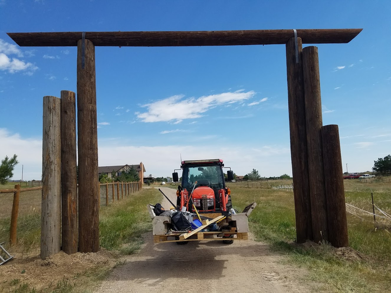

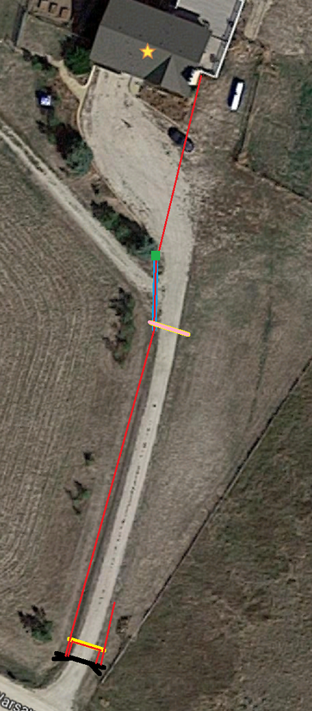

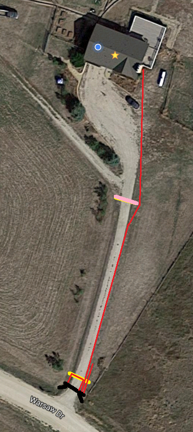

I'm going to be running 3 conduits from the house out to the end of my driveway. 1 power (20@ circuit), 1 for fiber, & one because conduit is cheap & trenches are expensive. Total run is about 350'. I've got several 100' chunks & 50' chunks glued up already & laying next to the driveway. I've got a 3pt trencher for my tractor that cuts a 6" trench up to about 3' deep (not quite enough to clear the frost line here in Colorado).
I don't expect more than 3@ normal use tops, probably less, occasionally using 10-15@ a few times a year for HAM radio field day out in the pasture or an occasional power tool. Debating between 12 & 10 gauge, possibly 8 to fight voltage drop. Shouldn't be a big deal at the average amp or 2 of draw going into regulated 12v power supplies (for that matter most of my higher amp usages will be HAM radio field day, also into regulated 13.5v power supplies). But I'll figure that out at some point after the conduit is all installed.
East side option: Pretty much a straight run for 350', except for the sweep 90's at each end.
West side option: Not quite as straight, but I have a spot for a pull box 100' from the house & would end up putting in a 30-40' chunk of drain pipe in the same trench in under a driveway to later pull some drip line in.
In either case I'm likely dropping in 2 30' conduits to go under the driveway right next to the arch & another down the side driveway on the outbound drivers side to put a button on a post for an eventual gate opener.
Where is a good cheap source for a pull box? Don't see any listed at Home Depot/Lowes & I assume the $30 plastic sprinkler ones aren't rated or appropriate for electrical.
Red = new conduit I need to put in
Blue = 3-4" conduit I'd put in if I went that way (would terminate next to the pull box, not in the pull box)
Green = pull box
Pink = existing 16" culvert
Yellow = 6" small culvert I'd likely put in
West side route Trenching plan west.png East side route Trenching plan east.png

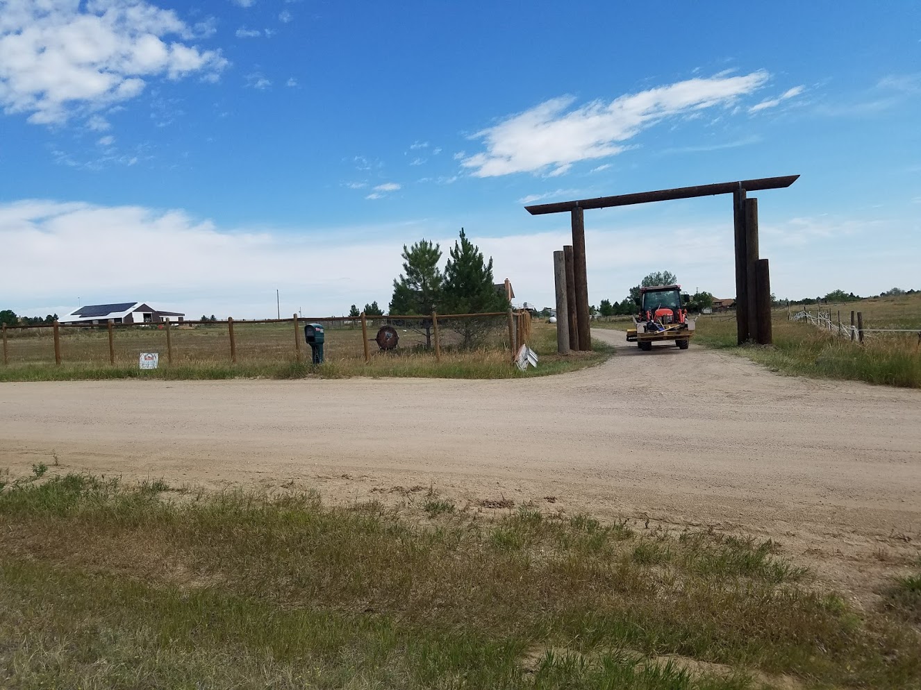

Ranch arch at the end of the driveway

Run the conduit at the recommended/code depth. Electrical at 2', water 6"-12" below frost line (deeper a the driveway) and fiber at 12-18". Technically they can't be in the same trench so separating them vertically will help. I now fiber doesn't suffer from being next to an electrical line but copper data can degrade so separate those two as much as possible- opposite sides of trench and depth difference.
Your local electrical wholesaler will have a pull box. I'd go for 10ga wire. You are correct to upsize for voltage loss. But 8ga doesn't hook to plugs etc well. Plus, in a pinch the 10ga can run most RVs.
As far as pull cord just put the conduit in and put the string in later. The old vacuum/leaf blower/BIG air compressor and plastic bag trick is what folks who do this everyday use.
This is a poor homeowner type video but you get the idea-
vaccuming a string through a pipe - YouTube
You will need to size the conduit. If the utility will be running the fiber (their box is at the house) they will demand a specific size. Most will require something way to big. If it's on your side of the utility (box at road) then an 1 1-4" or bigger should do. The electrical should be sized for 3-4 10ga THHN wires-4 wires (only one extra) would give you 2 20-30a circuits- a little extra for your HAM stuff at little extra cost. They have conduit sizing calculators. Southwire has one on their website or let me know and I can do it.
Take your time and cut the ends straight, debur and glue properly. The last thing you want to do is have to dig something up because you rushed. Same goes for keeping debris out- lift and pull pieces to you- no pushing conduit away from you!
You will also want long sweeps- spend the extra few bucks. The wholesaler will have the nice ones- their is a difference.
The extra one should be over and inch imho. No reason to underside that one.
350' technically doesn't need a pull box. However I'd leave a 20' section in the middle exposed until you get the pull cord through- just in case.
If you hadn't purchased conduit already I'd recommend going to HDPE. With a tractor you could get spools and do it in one shot. However, regular PVC will work fine.
Good luck and keep us posted. It's always nice to help folks who want to do things right!

Fallon, a couple of things to think about. Assuming that you want to stay within the 3% voltage drop limit (per NEC), 4 amps is about all you can count on if you use #10 copper wire. If you up size to #8, you can count on about 7 amps being available.
You don't say what size conduit you are using, that needs to be determined based on the number and size of conductors you are using.
I was in the business of installing sports lighting systems for many years so I am no stranger to pulling wire for long distances. The longest pull I ever made was just over 900' with 3-#2's and 1-#4 conductors in a 2" conduit. We used my tractor to pull the well lubed wire. I would suggest that you leave the 90 deg sweeps off until the pull is done then add them after. This helps keep the pull as straight as possible. Also, if you use a nylon pull string the string will cut through the wall of the sweep and of course the string will break at that point. I think there are other string materials that are less likely to have this problem but I can't remember what they are offhand. I always used the shop vac method of pulling my string through the conduit (even on the 900' run it worked just fine).
One more point then I will leave you alone. If you soil is rocky, consider bedding your conduit in sand. This means at least 4" of sand below the conduit and 8" above it. The conduit must also be centered in the ditch so that you have at least a conduit diameters width between the ditch sidewall and the side of the conduit on either side of the conduit. If you cut a 6" wide ditch it should be sufficient for 2" conduit.
