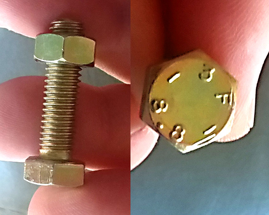

Howdy group. I came across a very large number of these new nuts & bolts but am not familiar with the stamping on the head. I suspect they are metric as the bolt measures exactly 3 cm in length and a standard 5/16-18 coarse will almost thread on but does not. I read it as 3F on one side then 8.8 across from that. Looks like a heavy Chromate coating for corrosion resistance.

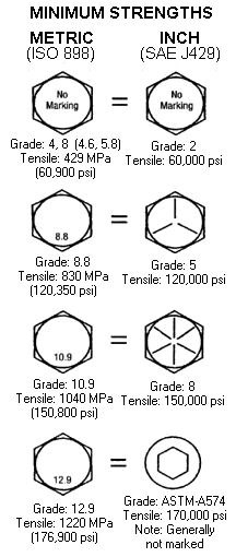

It's an M8x1.25 30 mm long bolt. The 8.8 is the grade for metric bolts.
In the land of metric, we don't even bother to mention the pitch (1.25 in this case), only if we actually want a fine thread or something. So we would just call it M8x30 mm bolt.

The thread diameter and pitch of the M8 and the 5/16 bolts or nuts are very close to each other. It will actually work if you force it there, but you may end up with a slight mix between a 5/16 and a M8 thread.
As far as the length, the provided metioned in the first post.
Hey that's great, thank you. A boat load of grade-5 bolts I can live with. Am I close in assuming the 3F marking is for 3 cm? But what about the F marking?
That would be a manufacturers marking/ID, so not really important.

3F is Fontana Luigi
Darn it ! I was hoping these bolts were Ferrari or maybe Lamborghini :)
Thank you for letting me know. Fascinating all that information can be easily put on the head of a bolt.
