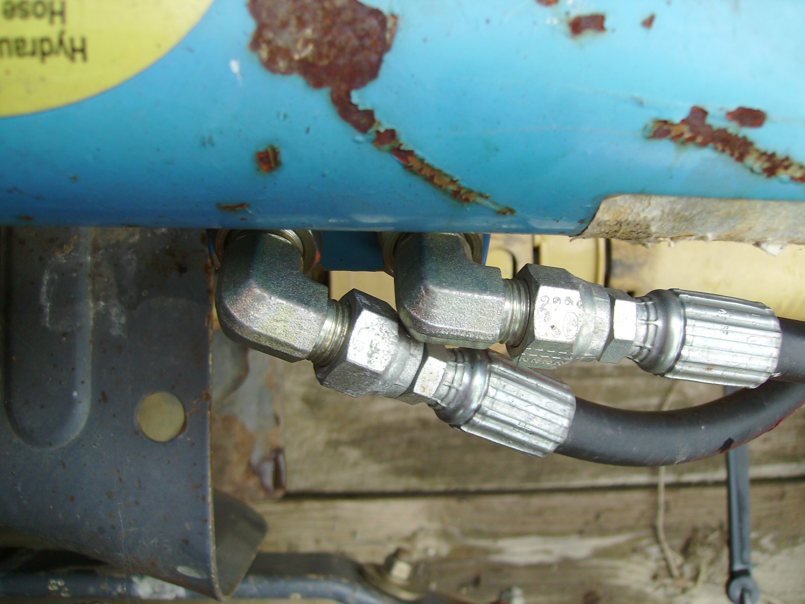

You can try Diversified fittings in Perry OH (see attachment for info), After you get a price you might decide to wait:eek:. I also attached a pic of the ones that I got from them.
Which fittings are calling 'banjo' ?
Here is another shot that gives a better idea. Notice the nut next to the DPCV.
Sorry, I was thinking wrong. It is the fitting at the end of the cylinder.

   / Need Help!!! Where to buy BSP Banjo hose assembly? #8
That last pic clearly shows a banjo fitting.
Your pic #2 does not, hence my question.

Weatherhead part # MB5515x?x?. ?= sizes. this fitting is a BSPP x JIC 90 degree. The BSPP will screw into your cylinder in place of the banjo bolt, just have a hose made with a JIC fitting on the end. This will cure the banjo forever.
