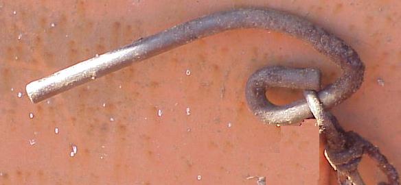

Although there may be different styles that vary some, this is what I've always seen. This one is made from steel rod about 1/4" in diameter and if there was a ring to secure this one it was buried down in the dirt somewhere. For some reason it seems like that once the binder broke over center nothing was needed to keep it in place - that is if the binder geometry was correct BUT, I could be way off base on that.

That is the one I remember. Have one drawn out on paper that I was going to post, but you have it (used to have a ring on the chain that would hold the tip from catching on something and flipping open). Fairly easy to bend some 1/4" steel rod.
We used them on wood sided grain wagons to keep the sides from bowing out when oats or ear corn were loaded, or at the end where the tailgate was installed. When shoveling out the wagon, they were opened so the chains were not in the way.

This one is relatively new in that it is on steel grain sides from a truck in the early 1980s.
