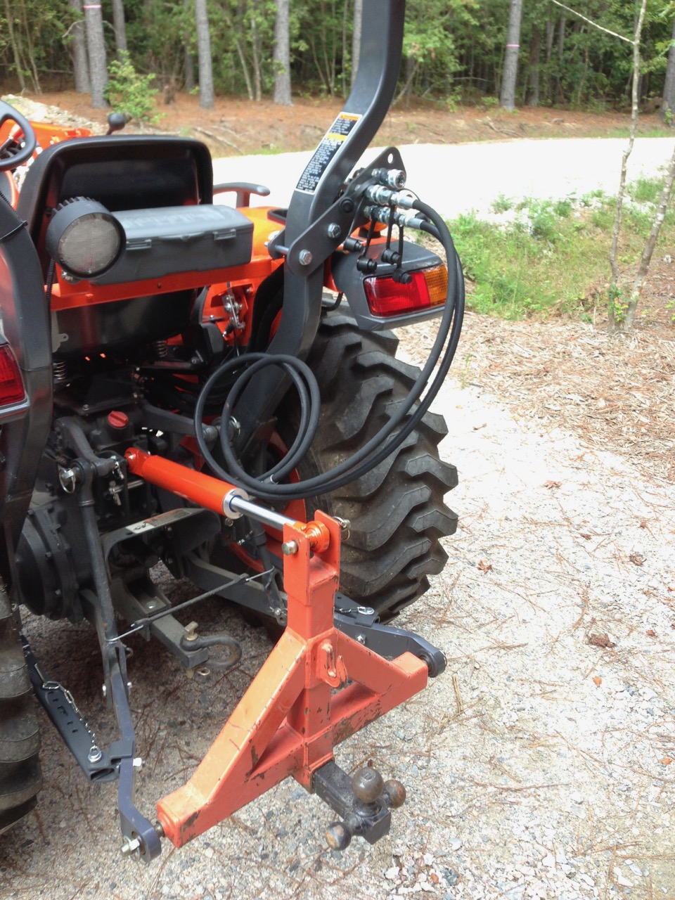

Nelson:
Here's a somewhat different way to do stabilizers. It makes a 3 point into a self centering hitch. This is on my B7500 but was copied from an IH 686. The orange center bracket pivots depending on the width of the arms to keep them centered.

That's another new one for me, Richard, had not seen anything like it. Are you using that with a quick-hitch? Does that act like a somewhat rigid stabilizer since the lift arm ball ends would be captured?
Thanks for posting. Interesting.

Short answer .... yes and yes. I do have a Pat's QH on it now but not when this was originally done back in 2004. Since both links are fixed it acts like a rigid stabilizer but the width can change to whatever size the implement wants. It makes hooking up much easier even without the QH because both arms move together as the width changes. After using the IH 686 which was that way from the factory (and an IH 584 that wasn't) I got spoiled and made my own for the Kubota. I was a little concerned when I made it that the 1/2" all-thread wouldn't be strong enough but it has lasted over 10 years without any problems.
