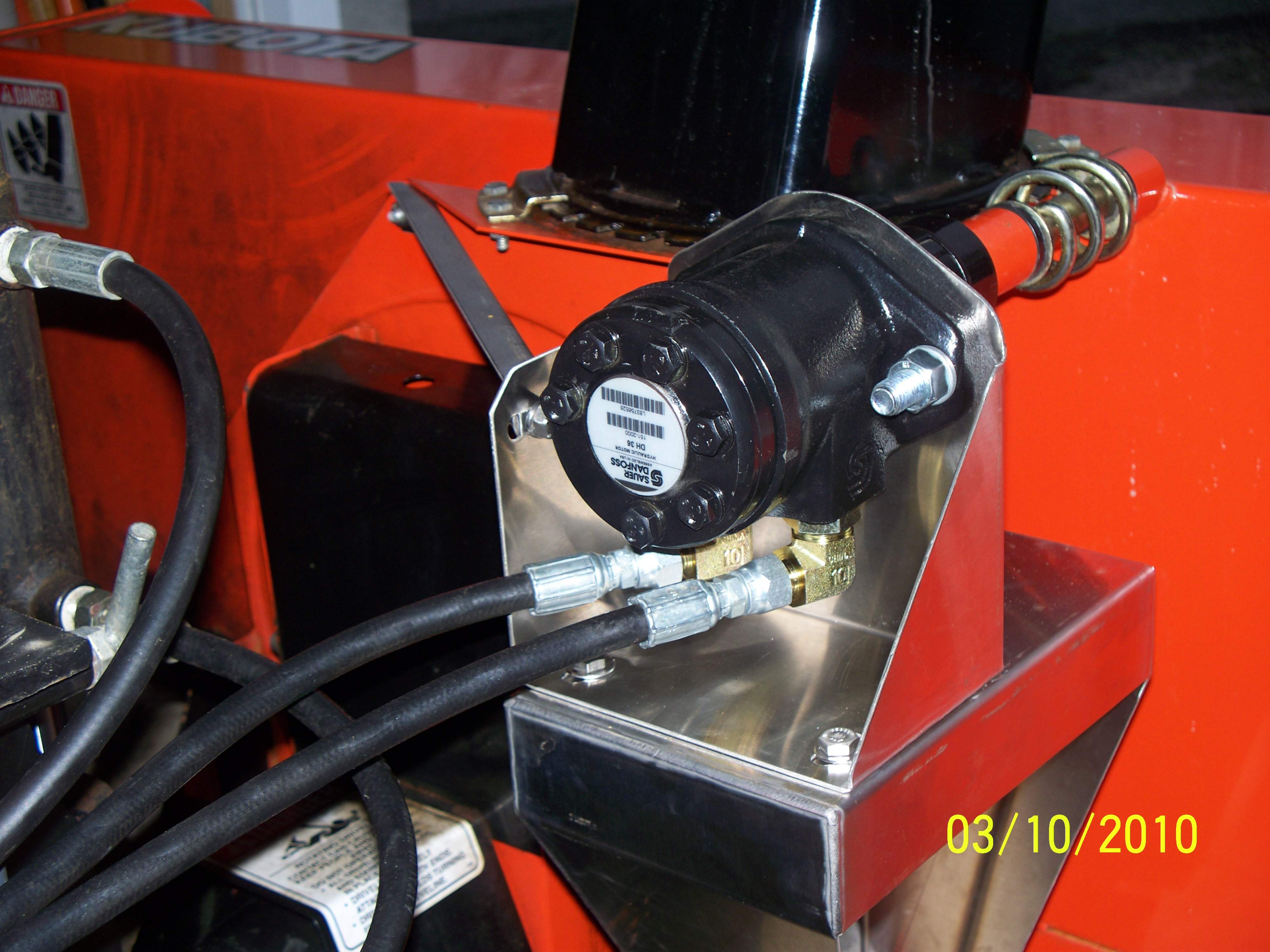

I got a new Kub 2360 and front snowblower this Spring.
The blower is a 2750 and I like to try to fabricate a hydraulic motor to rotate the chute.
My question is :
I know I've seen it here but cannot locate it now.
I can't find the post about installing an after market motor and hoses ? It was explicit in stating the spec. of the motor ( where purchased), bracket, and hoses.
As you may know, I'd prefer not to spend 800 dollars on OEM stuff.....
Any help appreciated,
GrayBeard

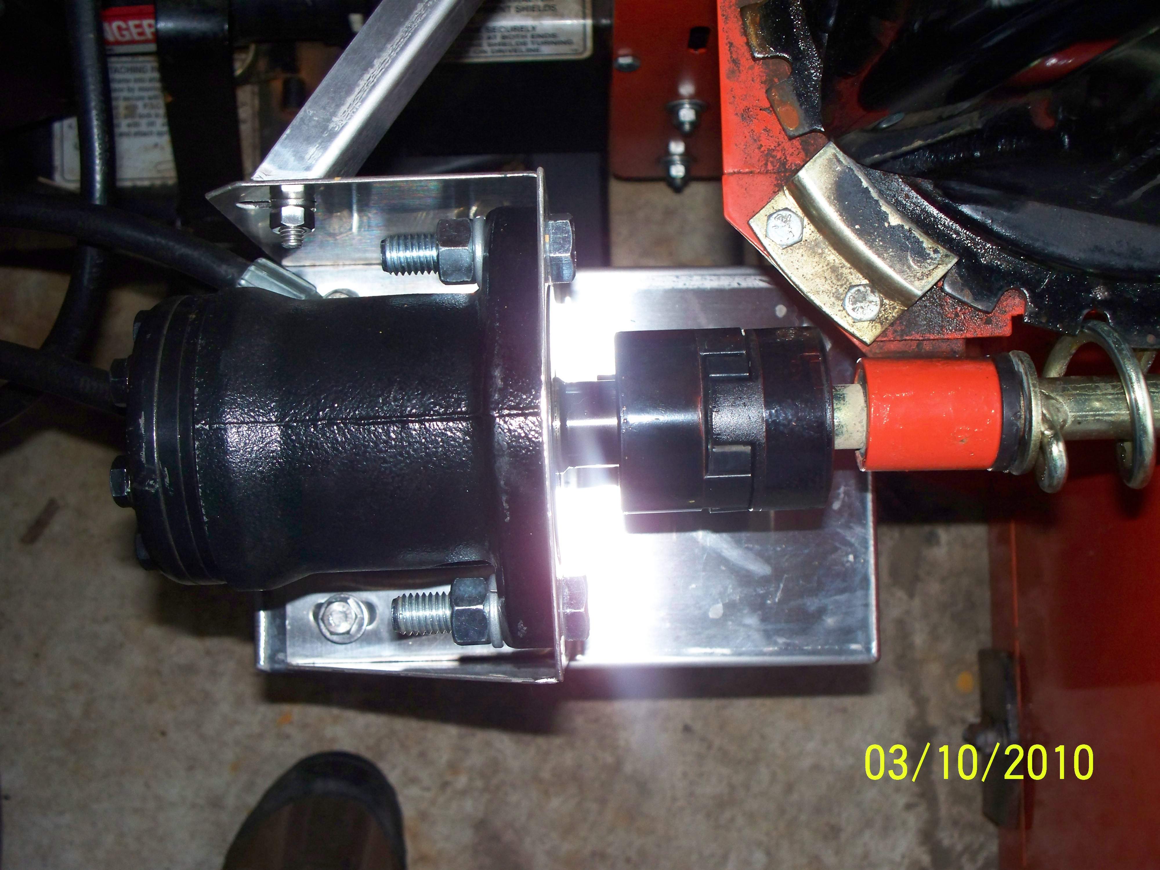

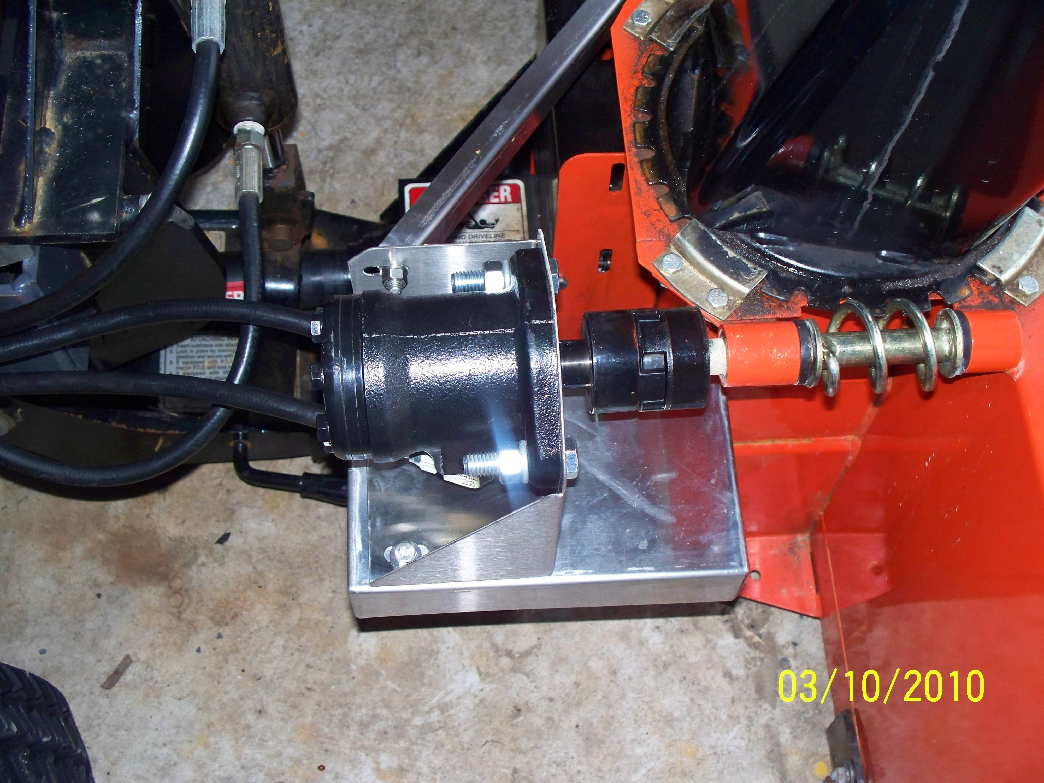

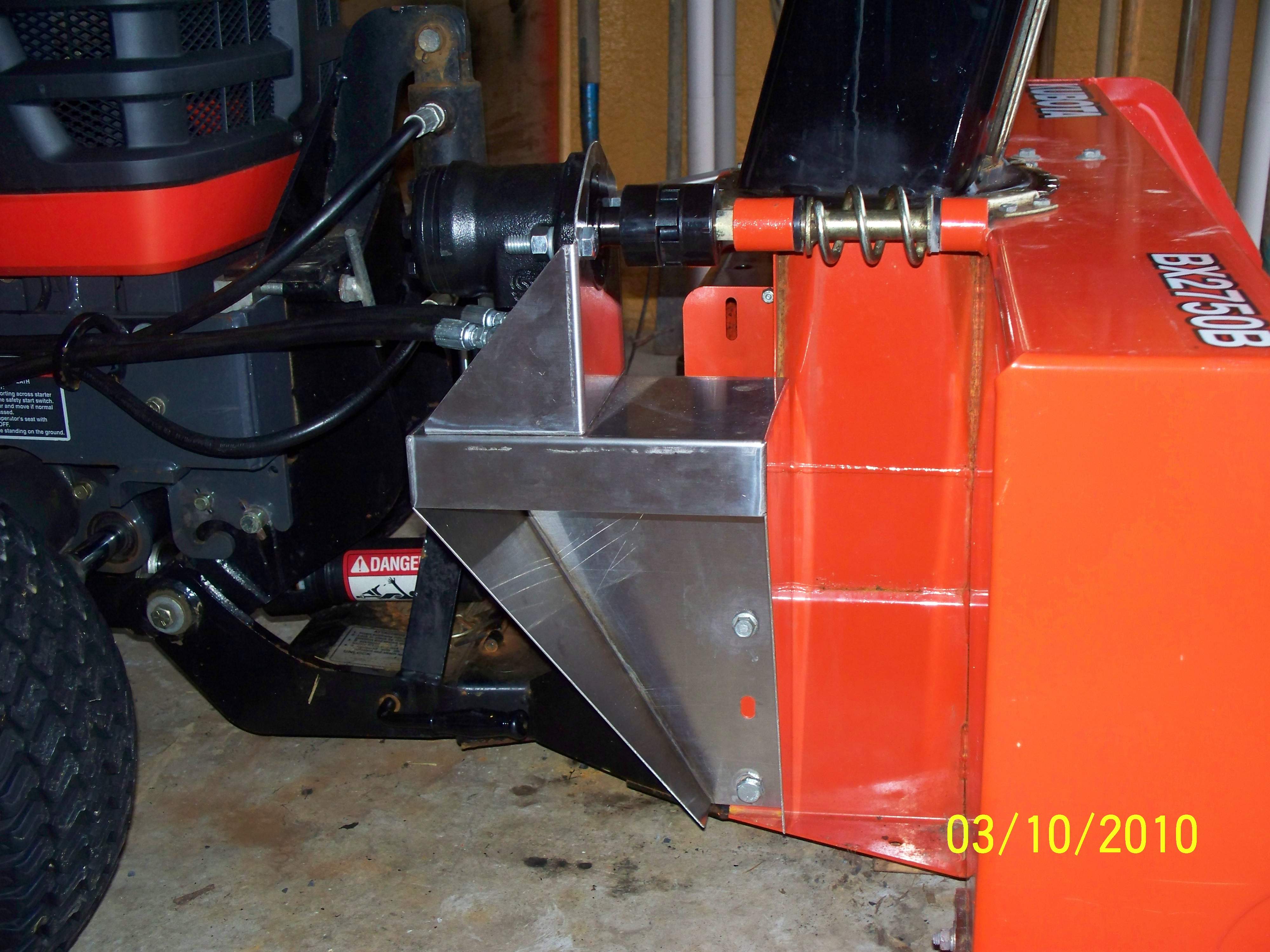

I did the same thing to mine before last winter. I got a hydraulic motor from
ebay for under $50. I had a bracket made where I work. My biggest expense was gettting the hydraulic hoses made. I had the Lovejoy couplings, but had a friend machine the ID of one of them. I was concerned about rotating too far & breaking something. Last winter I did it once & it just jammed things up at the chute. I loosened the bolts & unjammed it. I attached a few pictures.
That's a great looking set-up and pretty much what I'm looking for.
I'll send you a PM.
Thanks, GrayBeard
