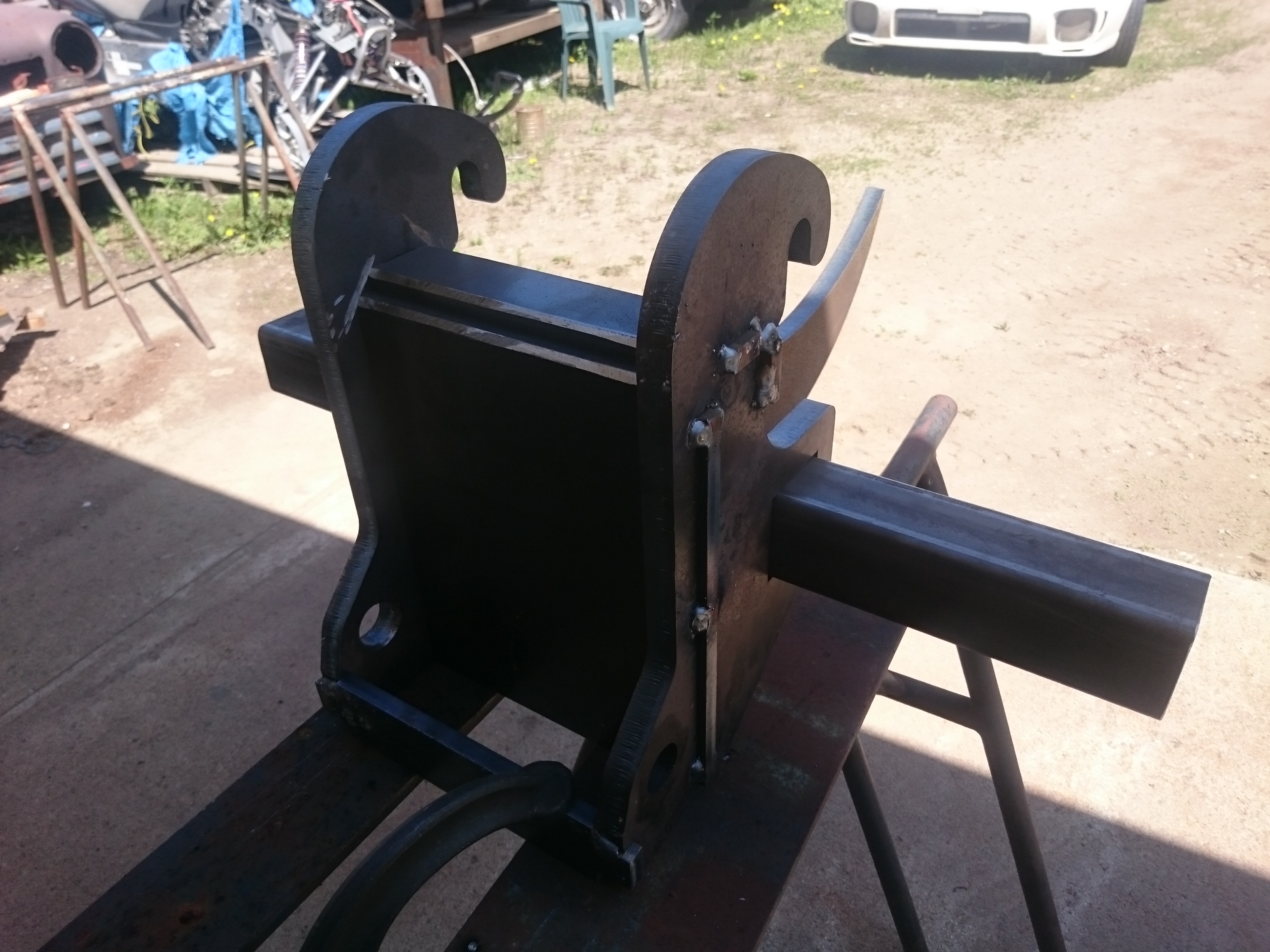

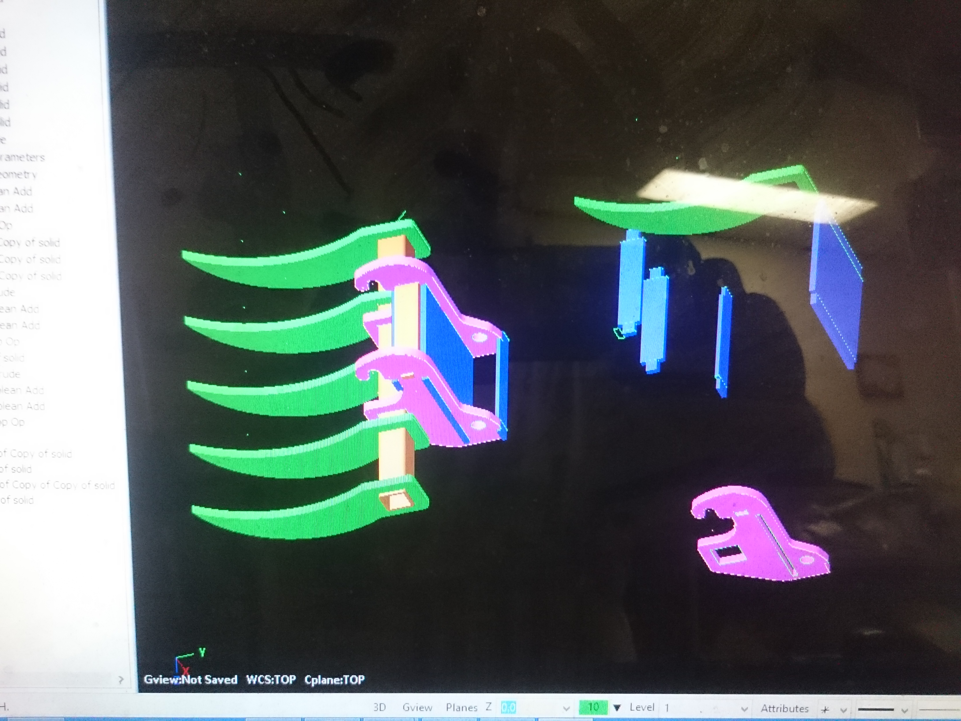

quick update, the thumb has been returned and over the weekend came up with this design for a comb and my design for the X-change adaptor as part of the rake, the width is 30 inches and should work well, the parts are being cut next couple days and then some welding, hoping its finished by weekend to try it out DSC_0049.JPG

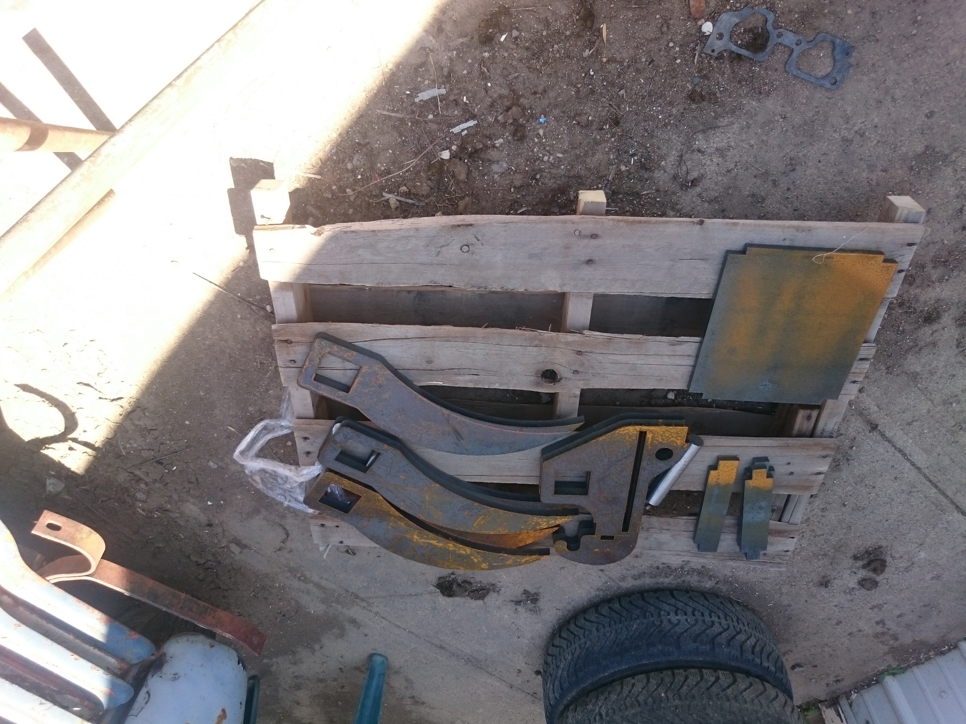

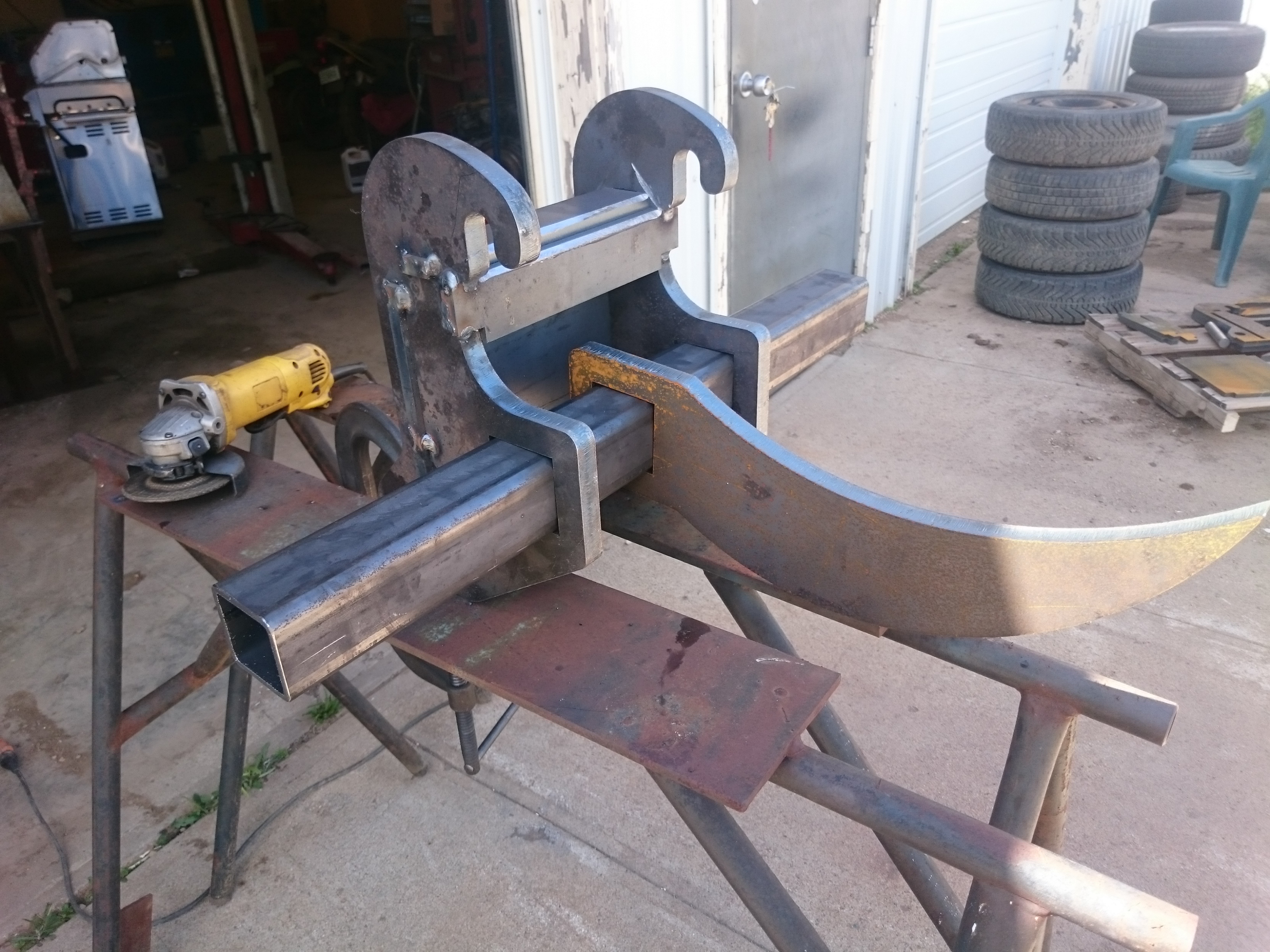

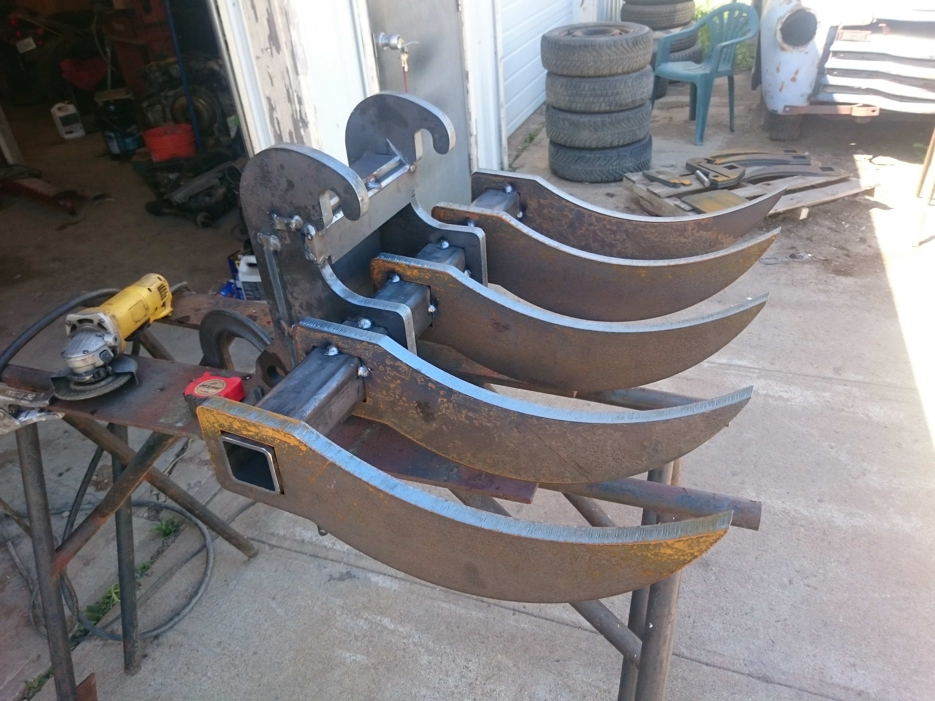

got the plasma cut plate in this morning, got enough for 2 units as one did not cover the minimum, hopefully sell one to cover the costs, got the first one tacked up, will be out there after work to finish welding it up and hopefully paint it tomorrowDSC_0063.JPGDSC_0069.JPGDSC_0068.JPGDSC_0064.JPGDSC_0062.JPG
   / need some ideas for a rake on mini x #4
Very substantial tines, L. They look to be at least 3/4", or maybe even 1" thick. A36 steel?
correct dfkrug, the mount is 1/2 inch plate, welded now paint tomorrow and if all goes well with weather some action shots on the weekend, now I have the mount figured out will be cutting some for my post hole auger, post grabber and small spade currently mounted on the skidsteer, I will cut some parts to replicate the E32 x-change on a skidsteer mount and it will allow me to use same attachments on the skidsteer using a cross pin instead of the hydraulic pins on the excavator

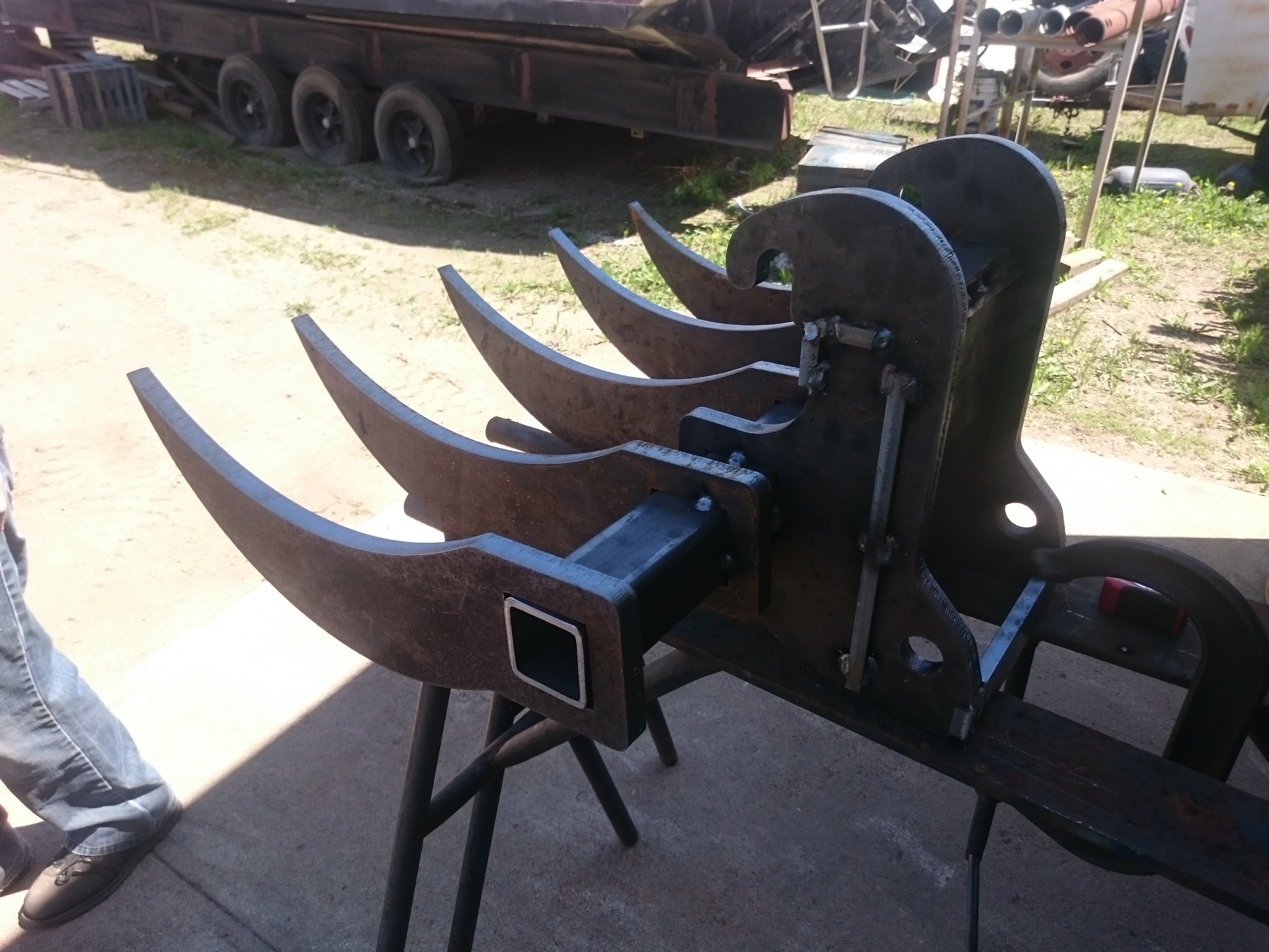

#9
yes they work great, it will dig roots and comb them out, works good for rocks, just rake them out and roll back to pick them up, got a few pictures
