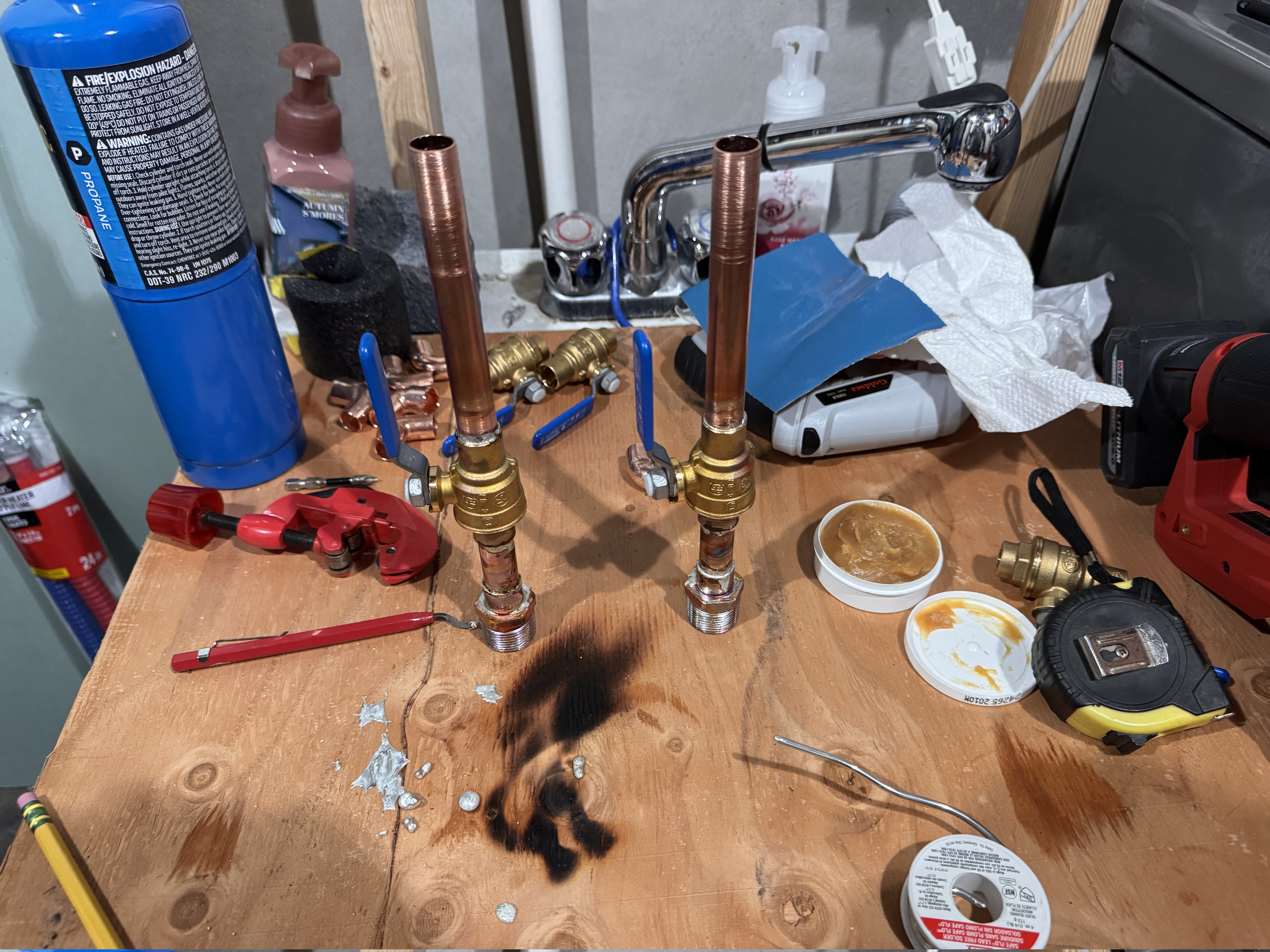

I'm here to give plumbers an aneurysm.
It's been a while since I have done this, by my 6th solder I had the right amount of heat and solder, top right.
   / New garage time! #1,603
I like the yellow bottles better for copper. More heat than the blue bottles.
   / New garage time!
#1,605

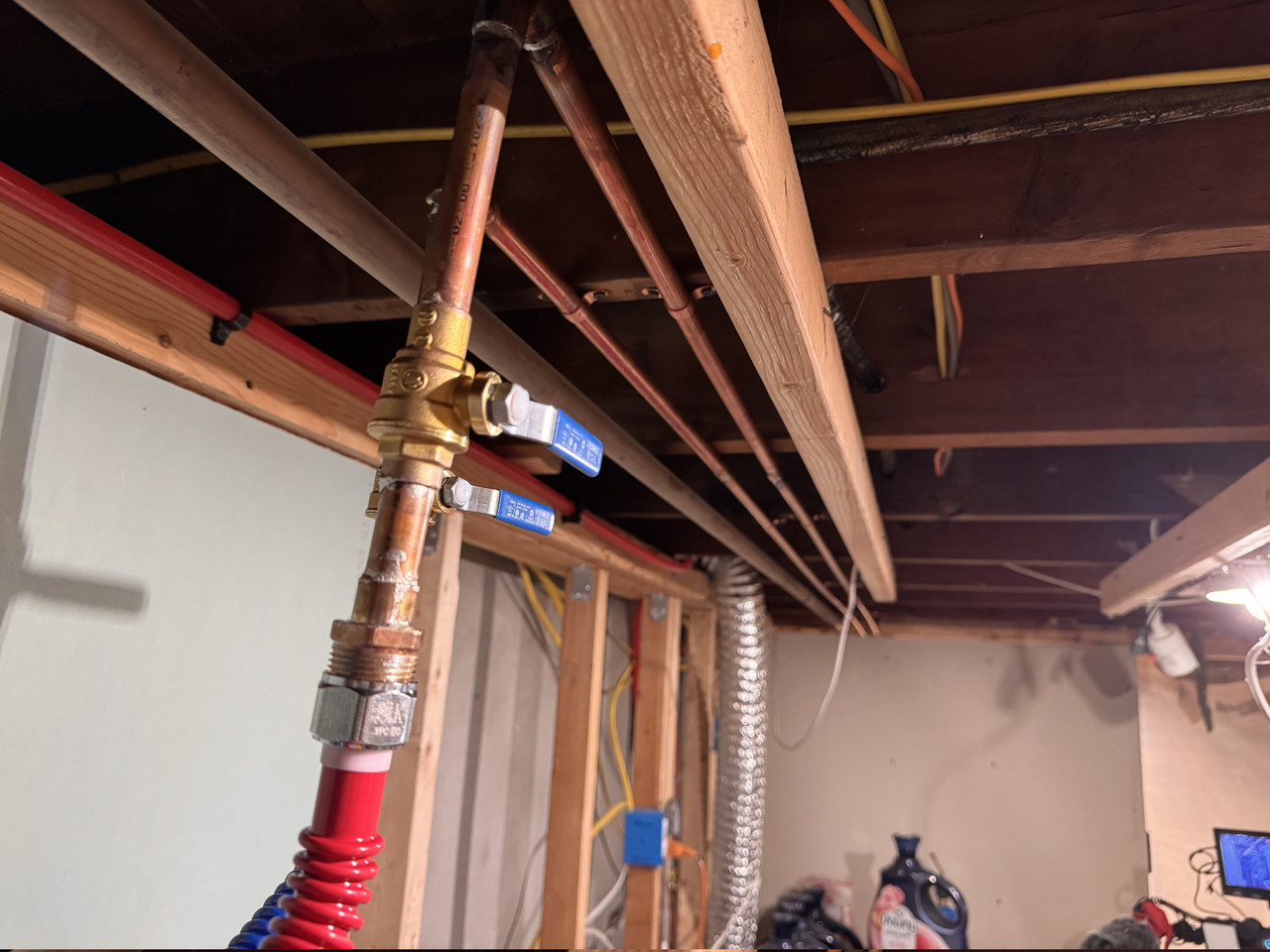

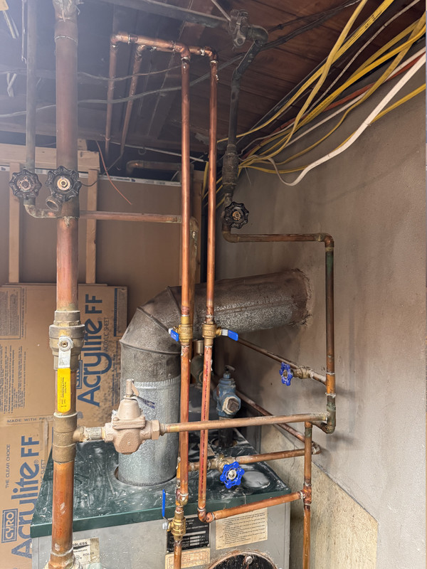

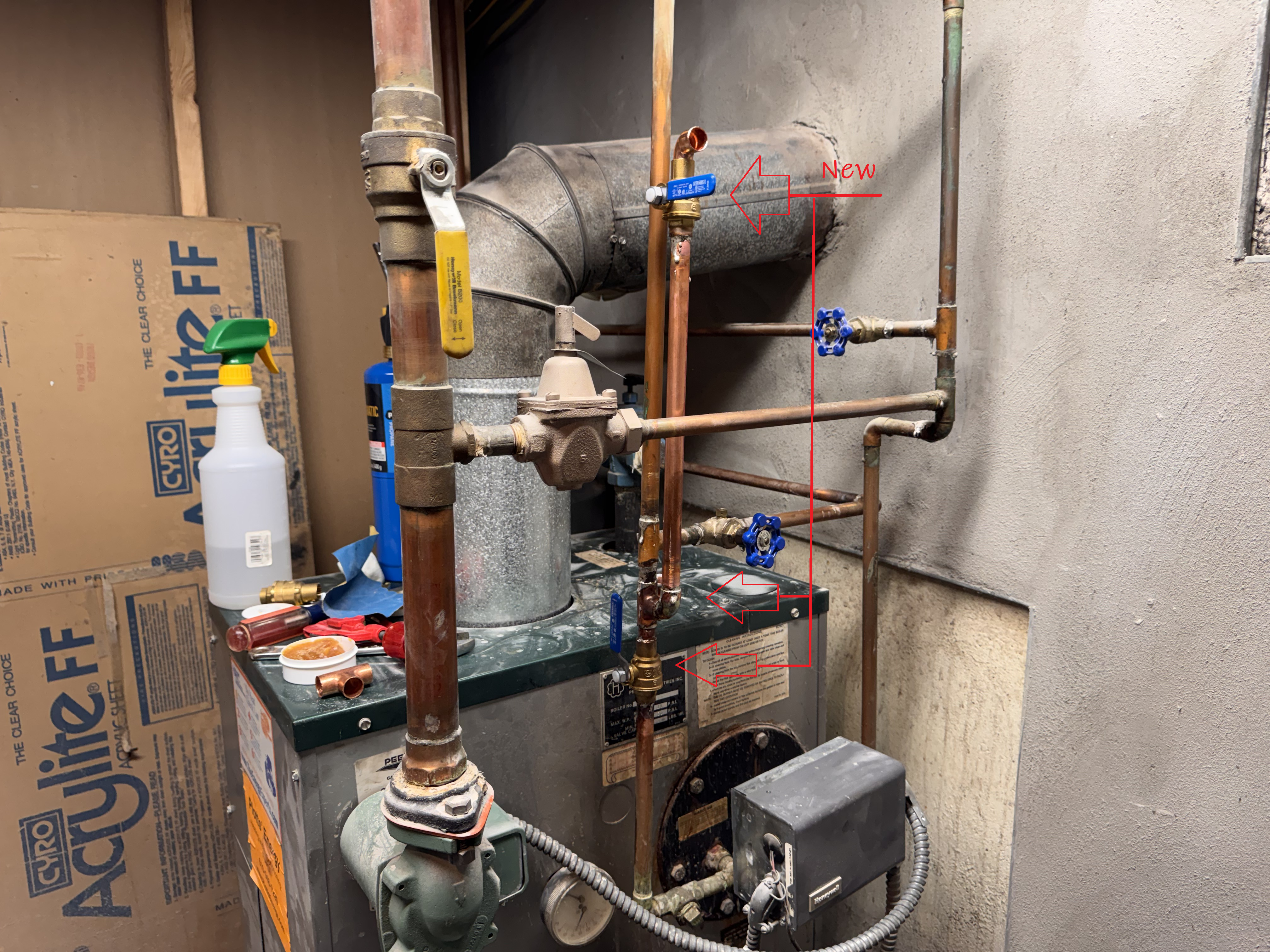

#1,608
I added the return to the furnace. Not the prettiest, but it's in there and no leaks. I have a shutoff valve after the boiler, then the T junction, then the shutoff valve from the hot water tank. I'm working my way backwards.
Work had to stop as my wife wants to bathe my kid and apparently hot water is required for that. No navy showers I guess.
After this I'll have to drain hte system again, then cut in the supply line. Then run copper to the ceiling and over to the tank.

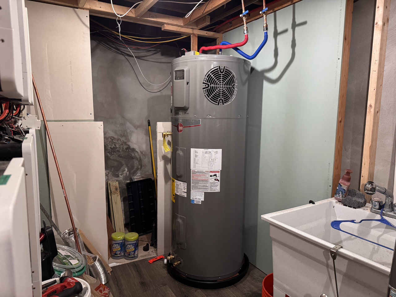

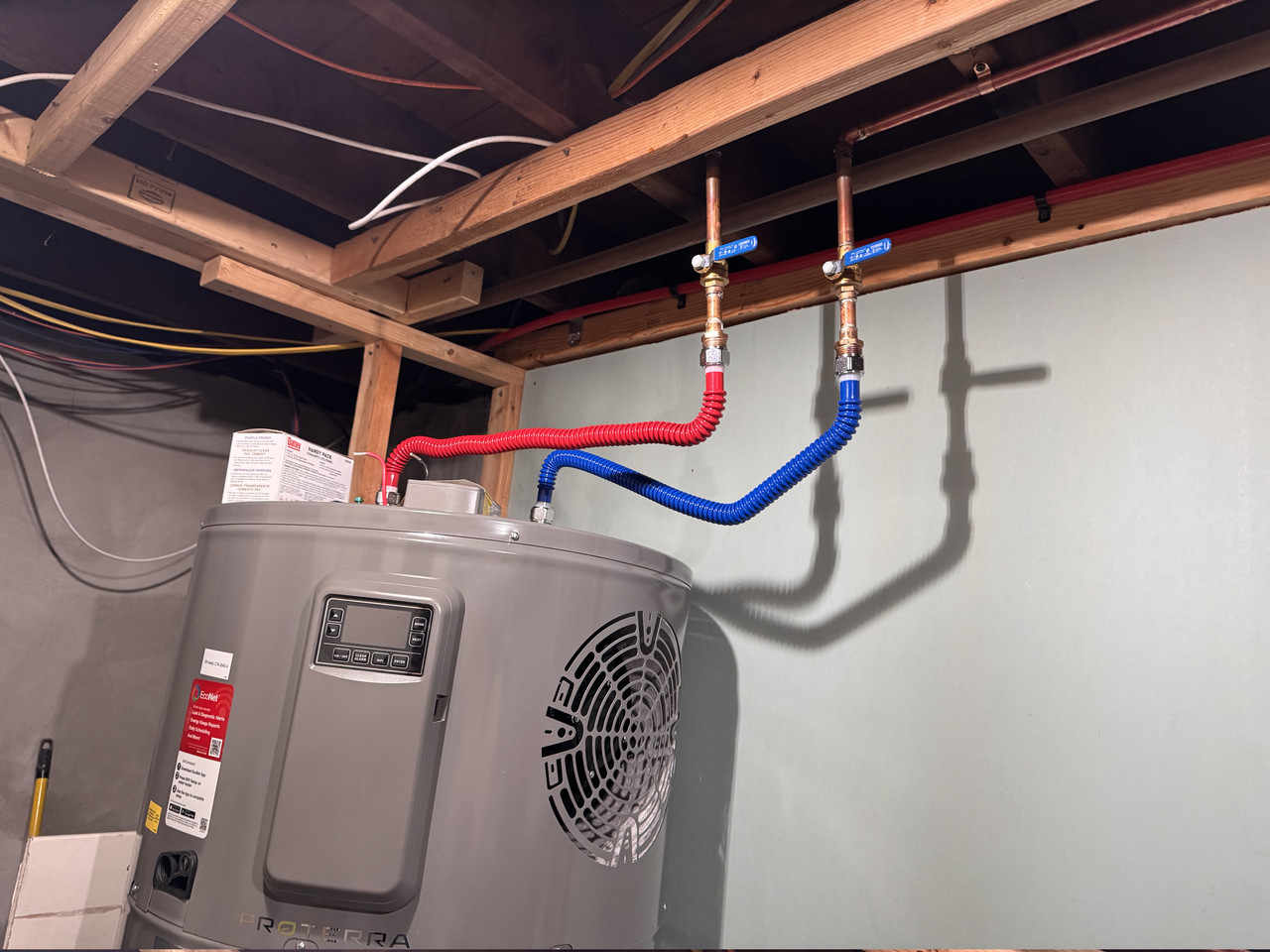

#1,609
Plumbed up. Lots of shutoff's. Pressure tested and flushed out. Got the tank up on bricks. Just need electric and the drains.
