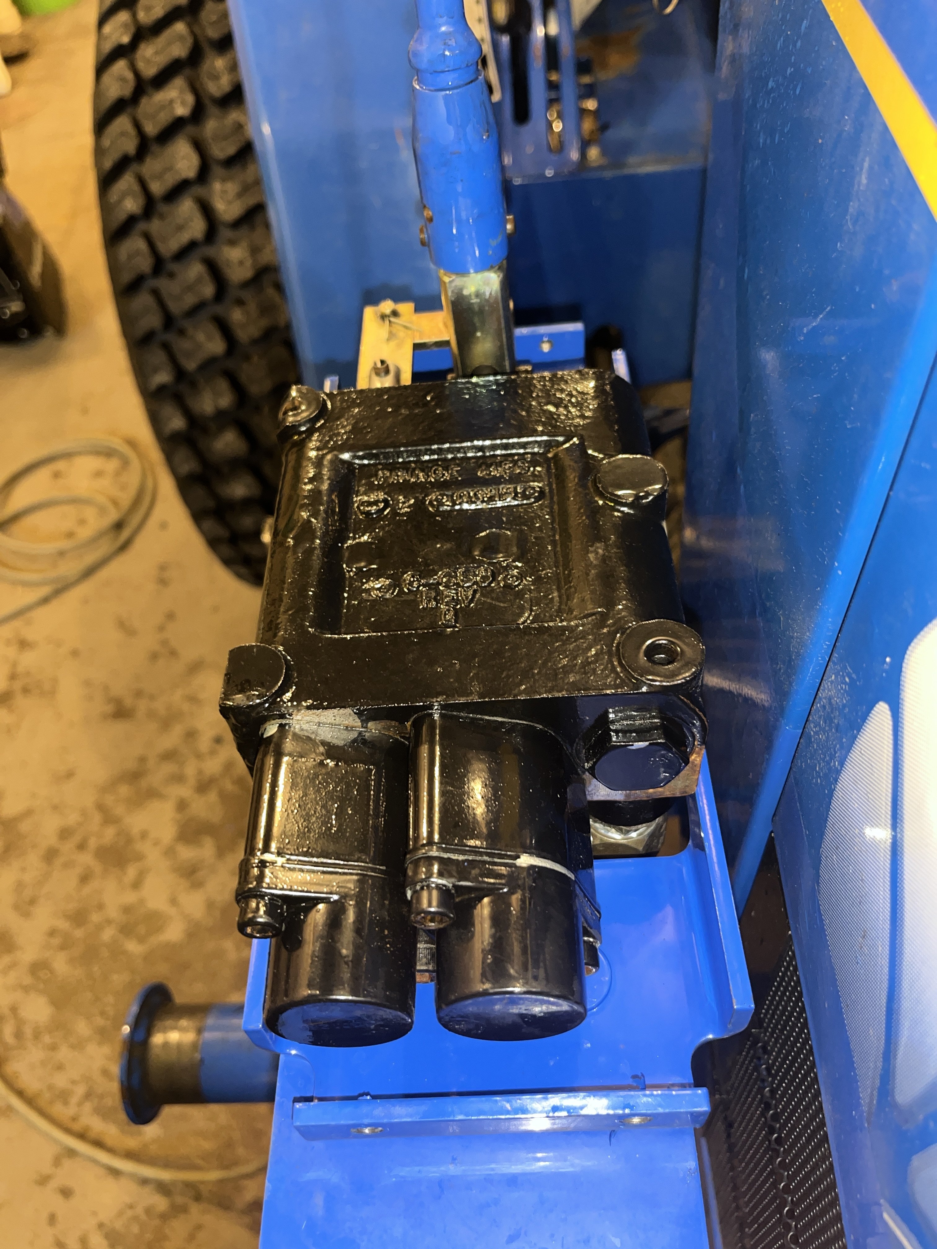

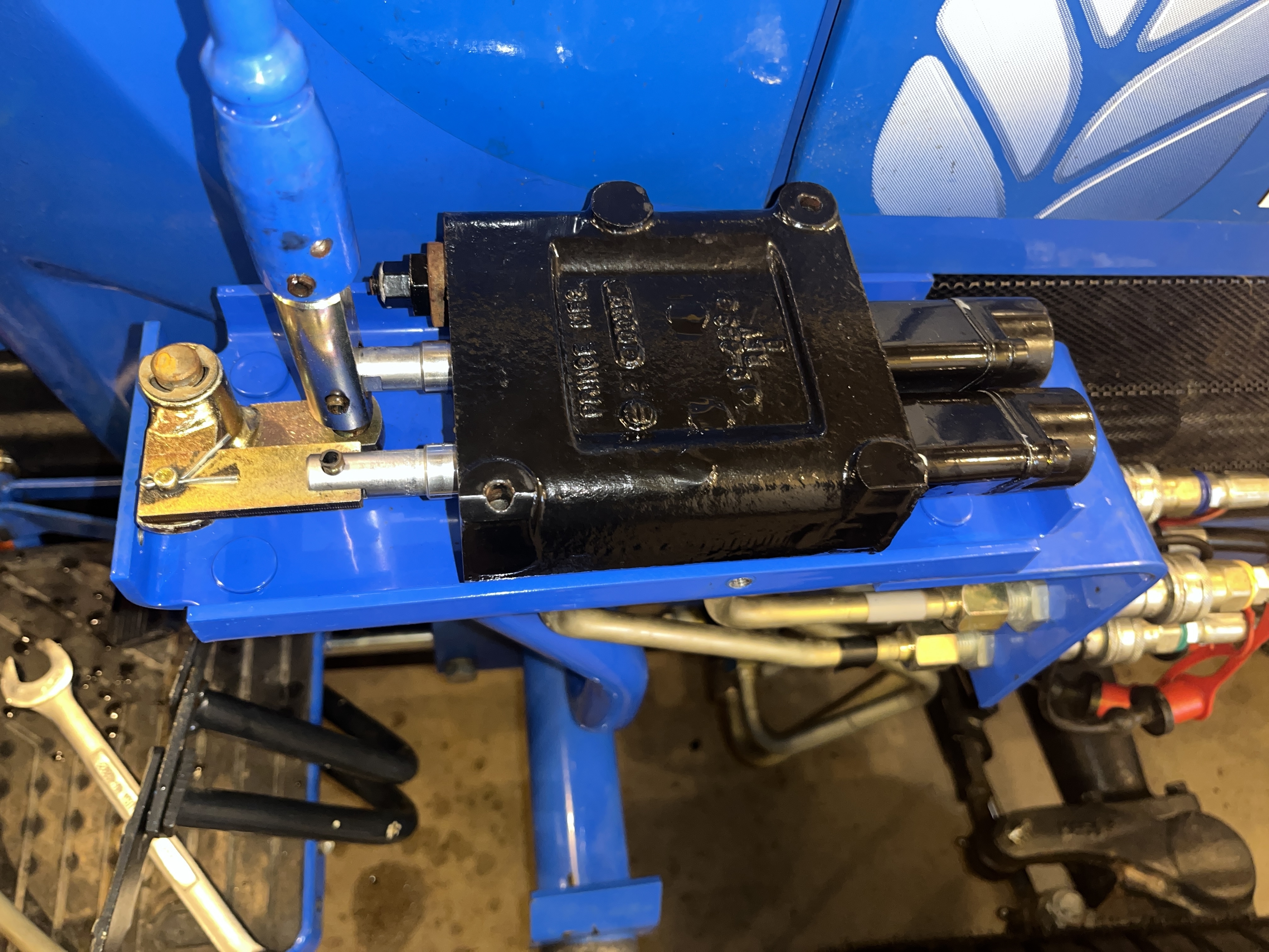

Here are some photos of the valve.
The New Holland part number is 86535713. From other older posts here, and from Prince info online, it appears that the closest stock Prince valve might be a LVTR series valve. A Skematic from New Holland parts shows the cross section of the valve.

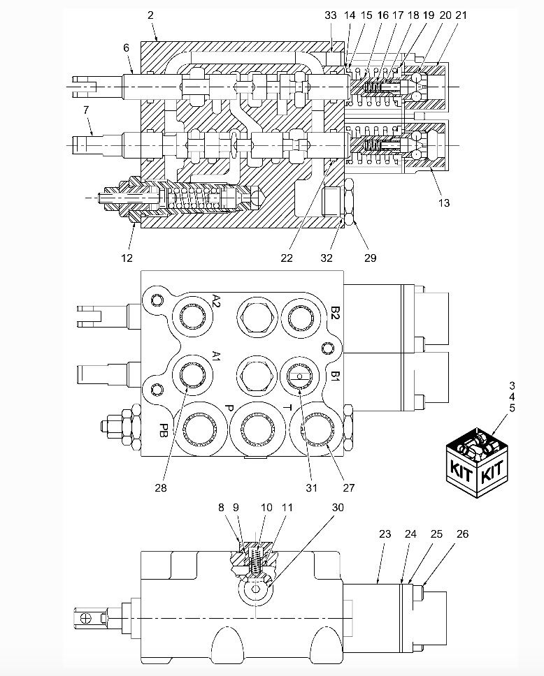

Between us we have cutaways of two different valves. One uses the center spool and one uses the spool opposite the relief valve for lift. Both show a similar location to add the .075" shim but IMO the SB is confusing compared to the cross-section view(s) we have.
#17 is the spring that the spacer would go (inside #16) behind/between #18, but on #7 spool vs #6 as shown above depending on which is lift. I can scan pics & a snapshot of disassembly instructions from the T1520 manual. (Section 35)
btw, My FEL is overdue for the same fix, so expect me to jump in soon. Should only have to remove the cover & one end cap. And THANKS for bringing this up with a thread title that's to the point and will let us get the news out there to others.

Thanks for the beautiful photos and diagrams. Looks like you washed it!

Anyway, here we go. I agree with how "the old grind" descibes the functions of the springs, spools, and detents in that cutaway view. And I don't see my expected weephole. Maybe it is internal or built into the sliding tolerance between parts? Maybe so, we know there has to be some way to vent or drain the void at the far right hand end. Old valve sets had an external weephole to vent to the outside, but apparently not this one. Bottom line is that easy solution #1 is not applicable. And anyway, you took the end cap off and any problem - like dirt or even hydrolocking - would have been obvious if it was there.
Easy fix #2:
Before we go on ... can anyone tell me what that piece is numbered 8,9,10,11, & 30? in the LVTR series valve? Is that the PB sleeve? I don't understand it and need to make sure it is not a restriction on rotating the spool valve. The reason is that my easy fix #2 "revolves" around an assumption that the hidden part of the spool valve has radial symmetry - i.e. that the part of the spool within the valve casting as well as the spring and detent groves are a 100% lathe-turned part. If so, the only thing preventing the spool valve from rotating is the actuating lever fastened to the flat milled on the near end of the spool valve. .
So easy fix #2 goes like this: With the engine off and ALL pressure released from the loader, mark the top of the spool valve at the lever, then unbolt the actuating lever from the end of the spool valve. Now the spool valve should be able to be rotated within the bore. Don't move it in and out, just try rotating that spool valve however much seems reasonable to break up any crud and stiction it has from operating in the same positon for decades, then finally rotate it 180 degrees out from the original position and hook up the lever again.

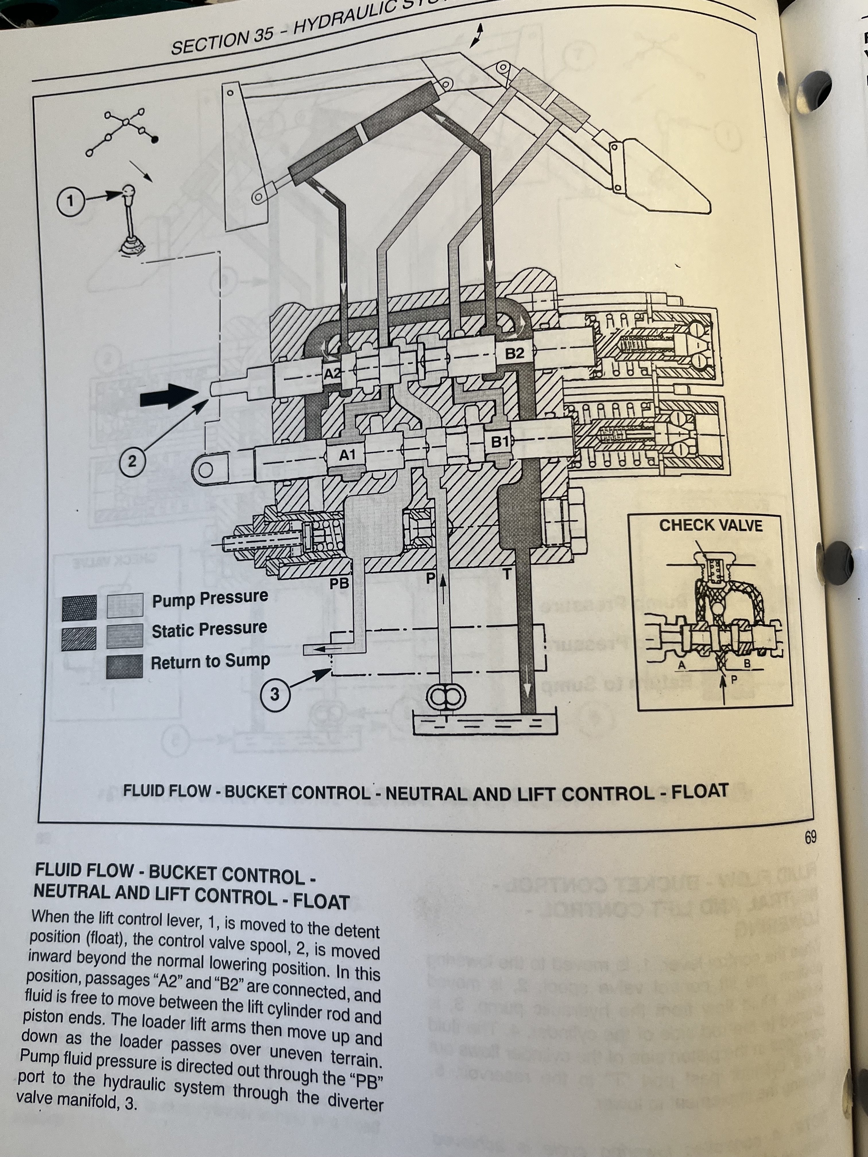

The odd bits are a check valve that works with regen & float. (8-11 & 30) Seven pics in the manual show flow to cyls in operating positions for curl and lift. Each one shows flow through or around the poppet according to control position.

Staying in float requires a cone & spring 18, 17 to hold the four balls into the annular recess in the cap and keep the sleeve 16 in position until manually retracted. We just need to shim up 17 for more push to hold the balls in place better. Can be done in situ & no further tinkering needed, really.

Cone and four balls are also in the curl spool w/o a lip so that quick dump must be held vs detent to a fixed position. The cap sleeves are different between spools and could be switched with functions/connections but there's also an orifice to move over too. It's under a plug on the top of the valve by the capped end.
16, 17 & 18 are kinda crowded into the top B&W pic in post #4 with numbering arrows pointing to them. Here's another pic from the manual. 16, 17, & 18 are then shown as 13, 21, and 22 with 24/25 being the outer sleeves with groove or not. I call 22 the cone, and it's 21 that's weak and can be shimmed to hold the balls into the groove/lip more securely.

I only see 2 balls on each spool in the diagrams for the Prince valve. I also have been trying to understand why the bucket curl spool also has the cone & balls. On this Prince valve the bucket dump function is described as a 2 stage function with the second stage adding regen (I assume that means first stage is without regen). The older 1520's Kayaba valve (according to the description in the 1520 service manual) also has regen on the bucket dump function, but it is not described as a two stage thing.

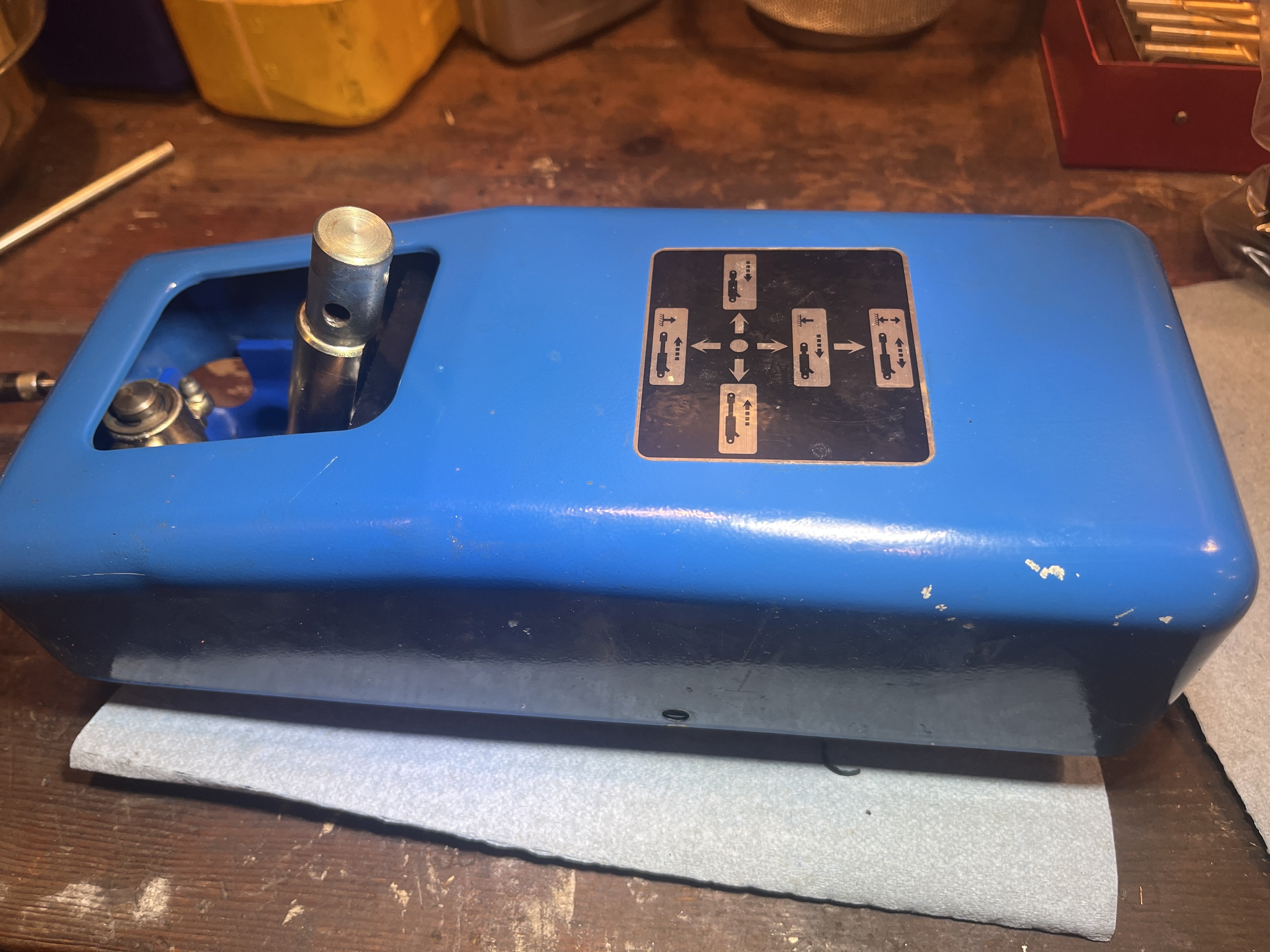

Mine did the same thing, it would not stay in float. Mine is exactly like yours, I took the blue cover off and noticed it would stay in float position. When I put the cover back on I noticed the joystick was hitting the cover, I took a round rasp and filed the cover down a smidge where the joystick rod was hitting the cover and it now works as it should.

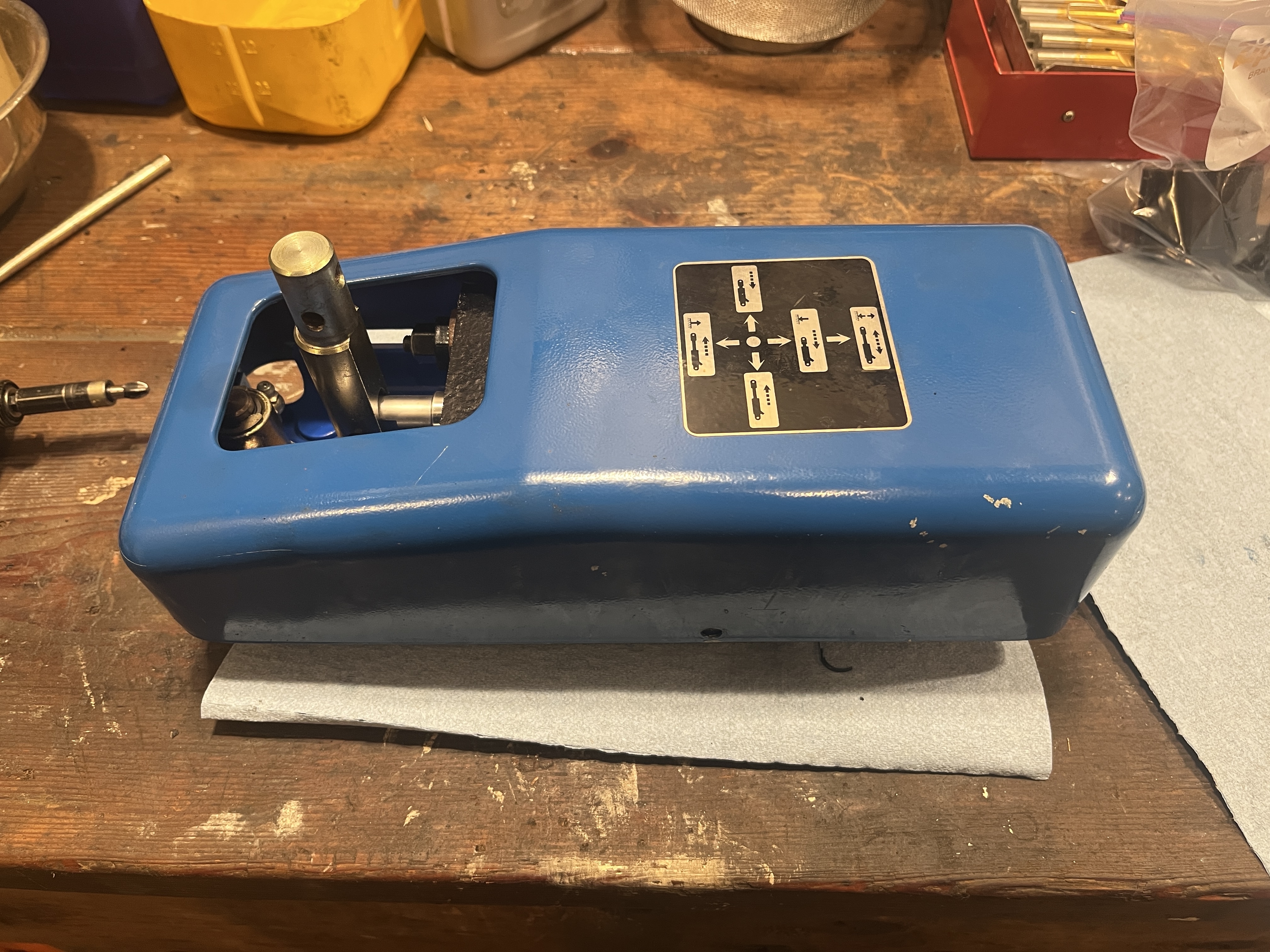

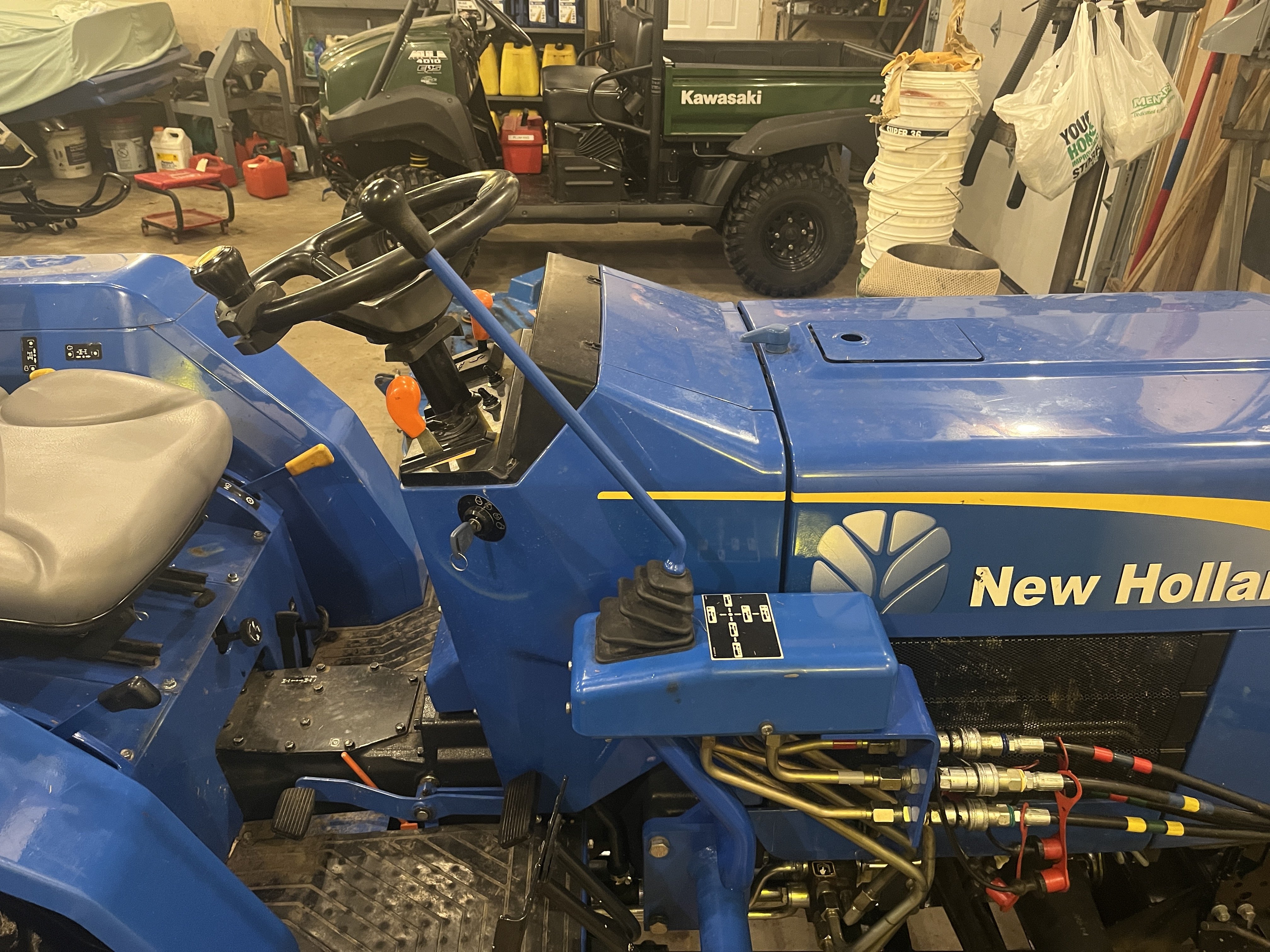

Regarding the handle clearance with the cover, I don't think that is an issue. Here are a couple photos of the valve with a cover minus the boot and handle. First is with valve in neutral position
Next is with the valve in the float position
A thought that did pop into my head a bit ago, is whether the length & weight of the valve handle extension is helping to knock the valve out of float. The float detent feels pretty firm when operating the valve without the handle extension. The T1520 valve handle is about 19" long which is 5-1/2" to 6" longer than the handle on my old 1520 (with Kayaba valve fwiw). I know that it is enough longer that it is more in the way when getting on and off the tractor.

I jumped into it today and disassembled the float detent. I did remove the valve so I could do it on the bench (at least for first time). It did come apart easily, as I was told on here several times in past few days. (Thanks again for all the input). This is what I found
The balls, cone, and spring were well covered in grease. There as no rust, dirt, grime, scale. There are only 2 balls. Maybe saving the cost of 2 extra balls helped Prince get the New Holland bid from Kayaba??
For anyone else who tries this, I noted dimensions needed to select the shim(s). The 'G' dimension is the size of the largest drill bit that I could easily slide into the bore where the spring sits, so the ideal, or max, shim OD looks to be about .260". I do not think it is necessary for a shim to have a center hole to clear the rod on the back side of the cone. I am thinking to start with .060"-.075" for thickness mainly because that was the recommended shim thickness on the old SB (I know it's different valve but it is a starting guess). If I don't find something around here, I will probably order shims from McMaster.
Also, taking it apart is easy. After removing the rear detent cap and its 2 screws, I just wrapped a rag around the detent collar, including the end, and slid the collar back. Between the rag and the existing grease, nothing acted like it wanted to take flight. Getting it back together, maybe not so easy. The axis of the bore where the balls set is rotated at an angle that I don't have anything to safely pinch them into place while sliding the collar back on. I haven't quite figured that out yet, but thinking of making a plate that I can fasten to the valve base plate with a bolt to function as a jack screw to push and hold the cone in.
Nice idea. Will you be making up a lighter handle just to check?
