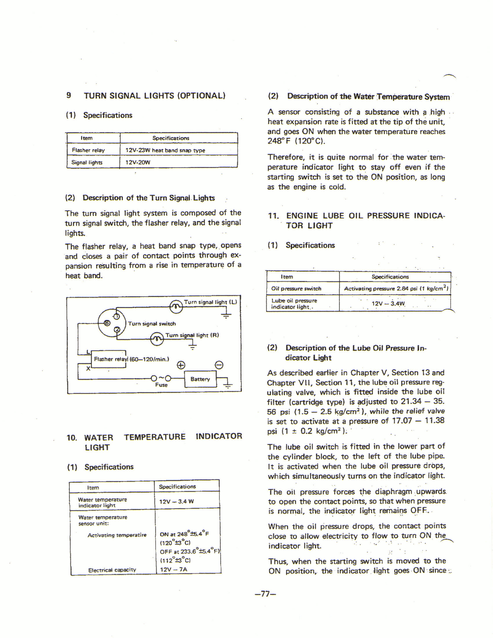

Hoye states not more than 25% antifreeze. Page out of the 155 manual, I believe it would also apply to your 165.

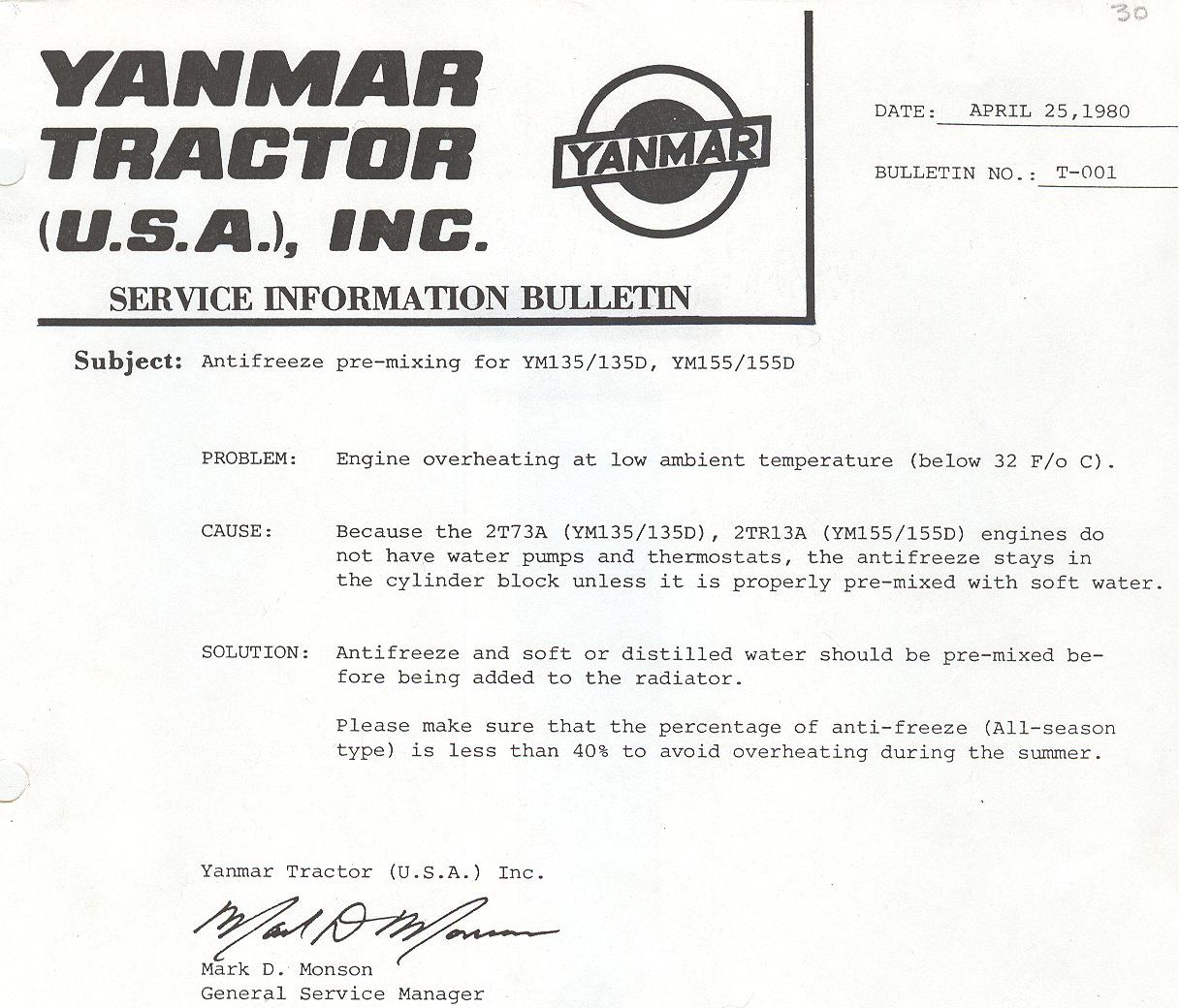

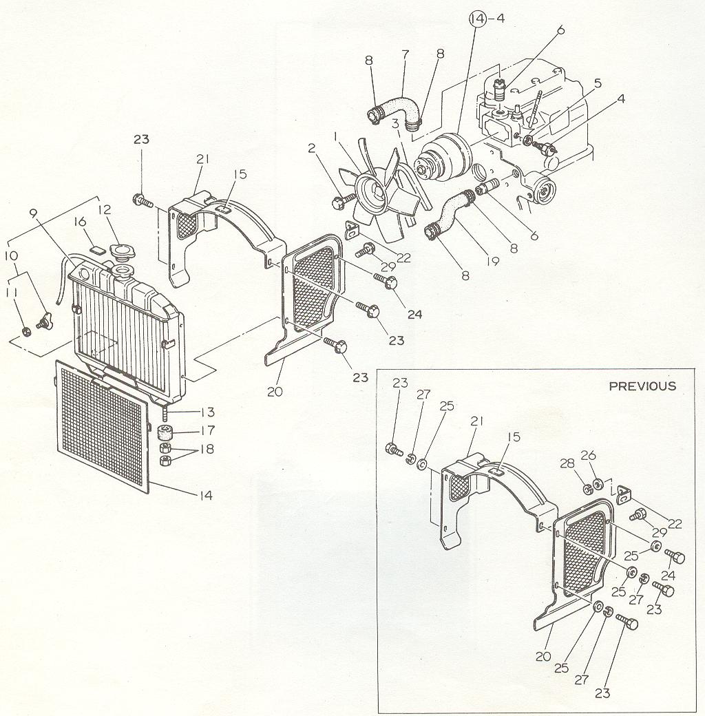

A little more information on the YM165D and thermosiphon cooling. Here are some old tech bulletins.
Yanmar wants the antifreeze to be pre-mixed with the soft or distilled water. That makes sense.
The radiator shroud and sides (items 20 & 21) are shaped to funnel the cooling air through the radiator fins, so they need to be there and fit well. Some early models even used strips of foam to seal between the radiator and the side mounts so that air had to go through the fins.

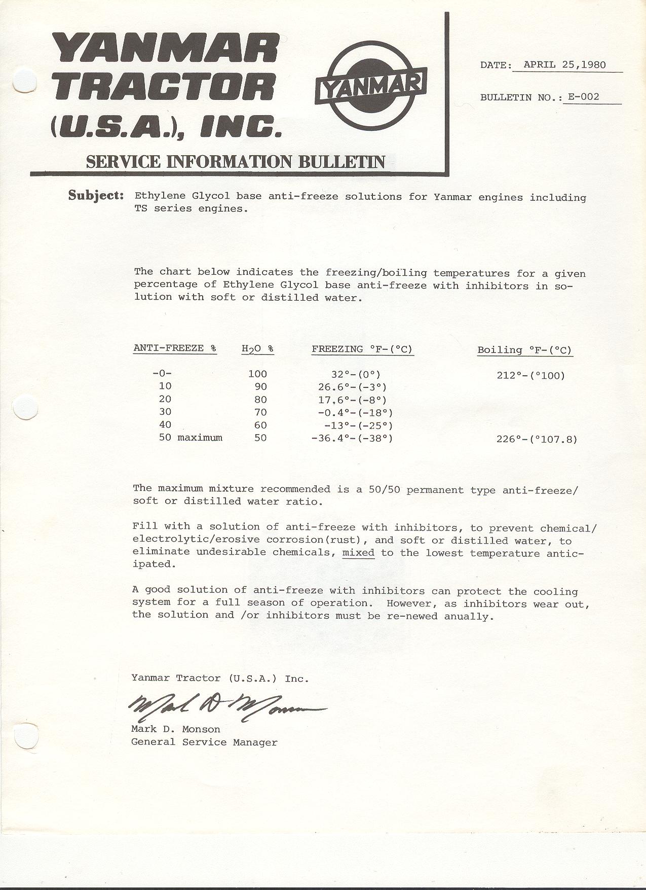

Lastly, here is a bulletin showing how percentage of antifreeze affects freezing and boiling. Not mentioned is how heat transfer changes with water/antifreeze proportion. Also, at the time of the bulletin all antifreeze was ethylene glycol. Today antifreeze can be several different chemicals. I'd stay with the old style green ethylene glycol.
rScotty

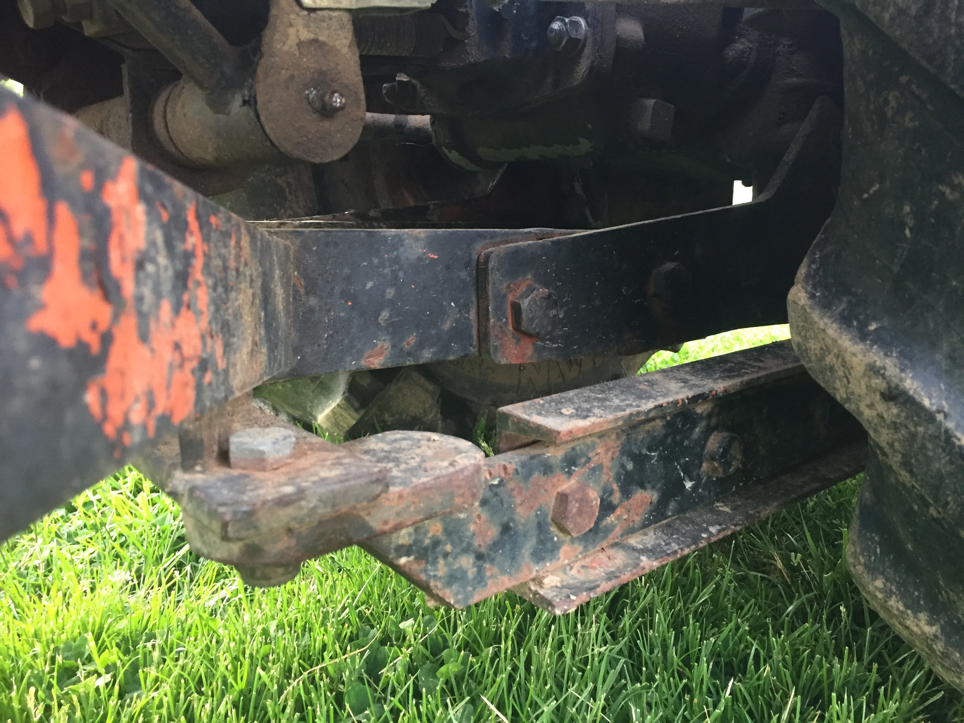

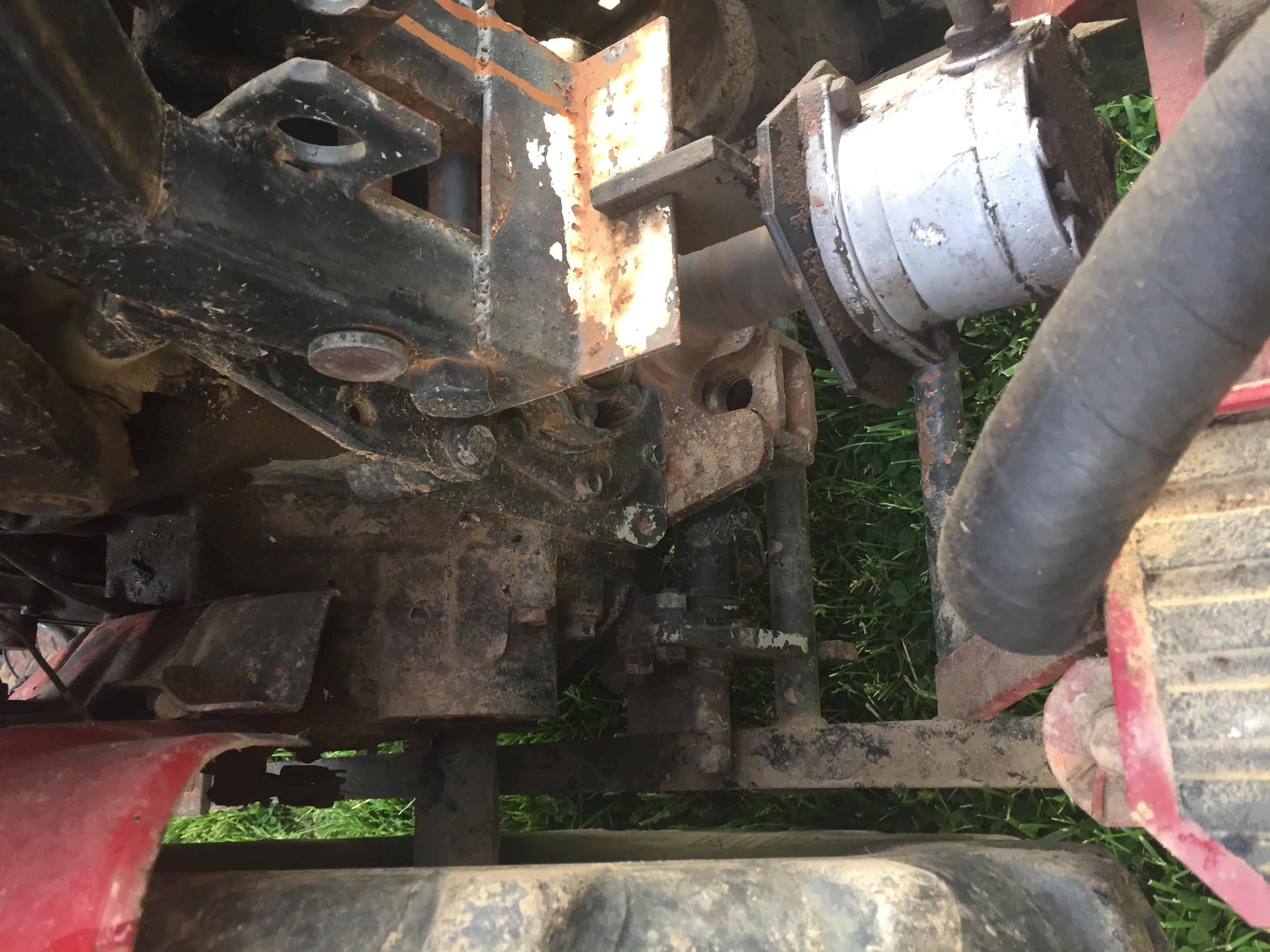

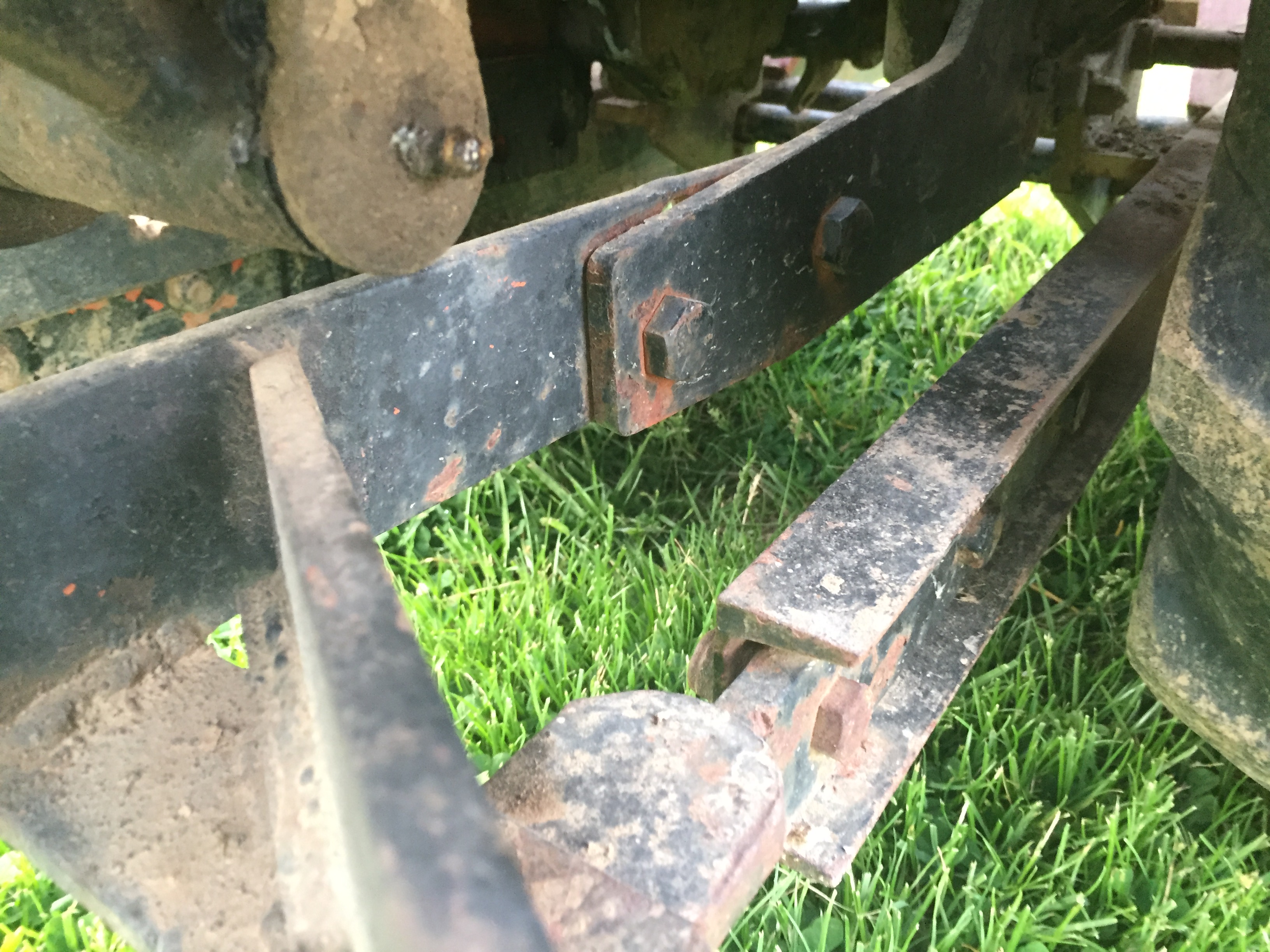

I said I’d post some pics of how the backhoe is attached, finally got around to taking a few pictures:
