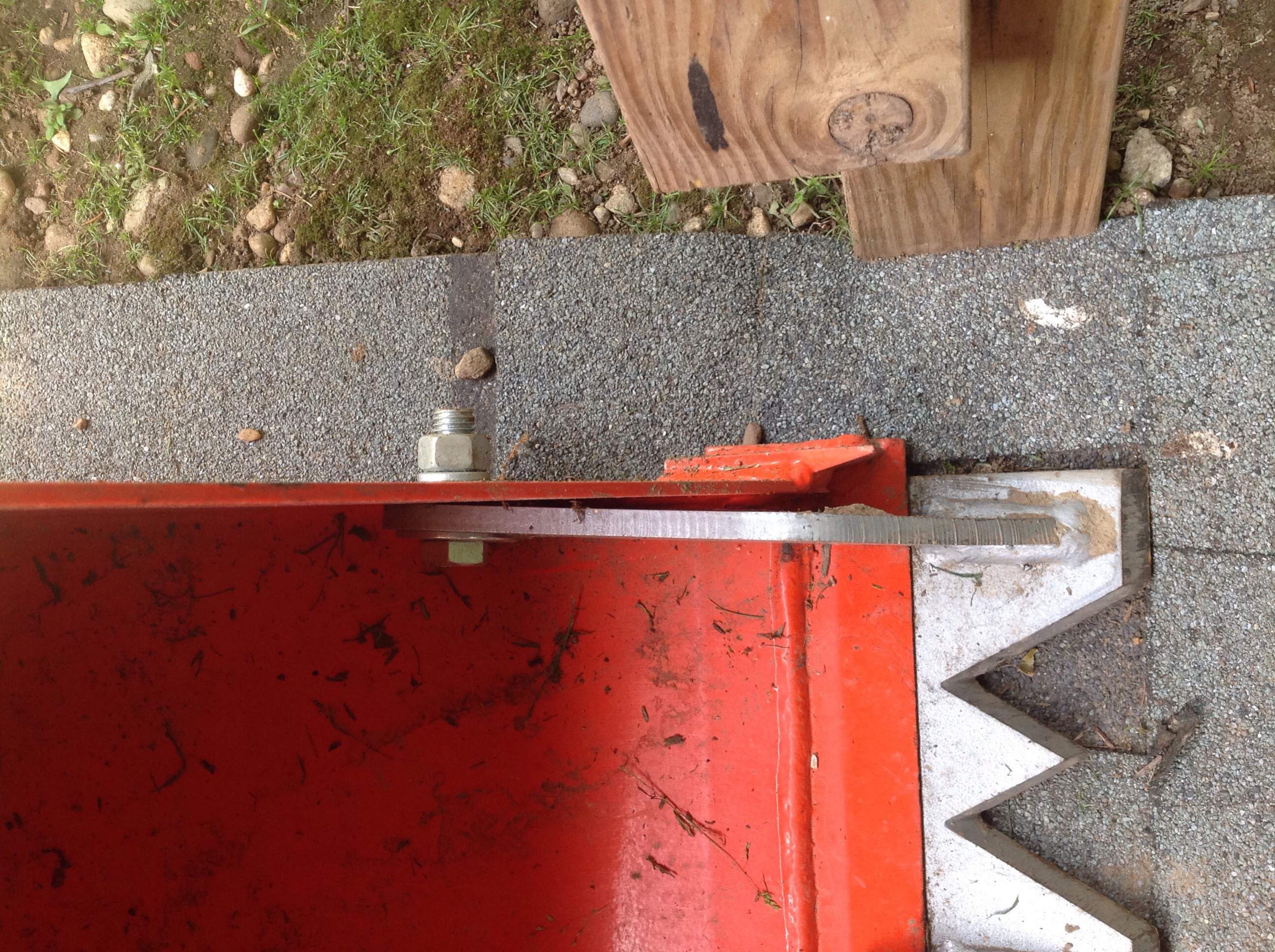

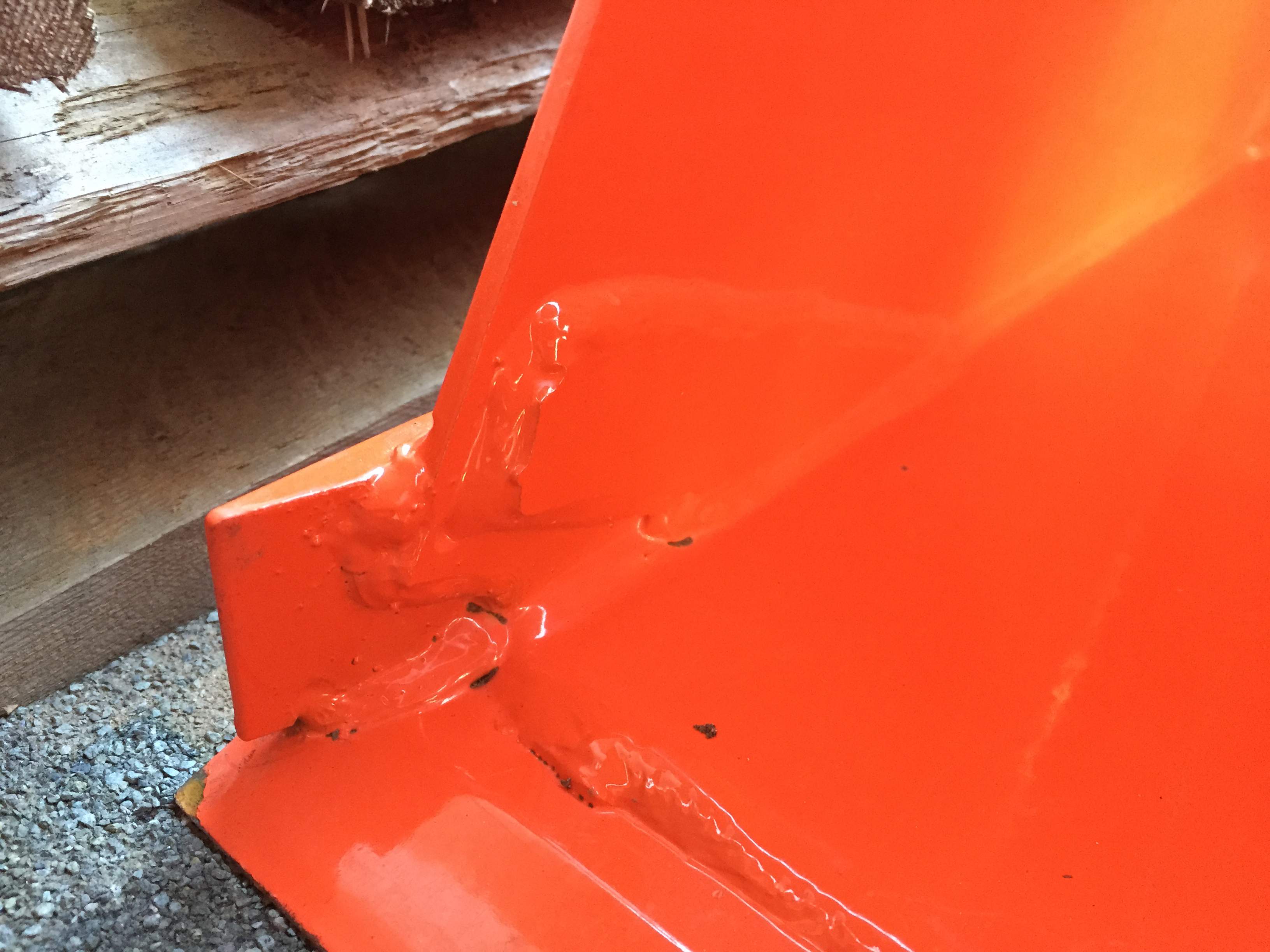

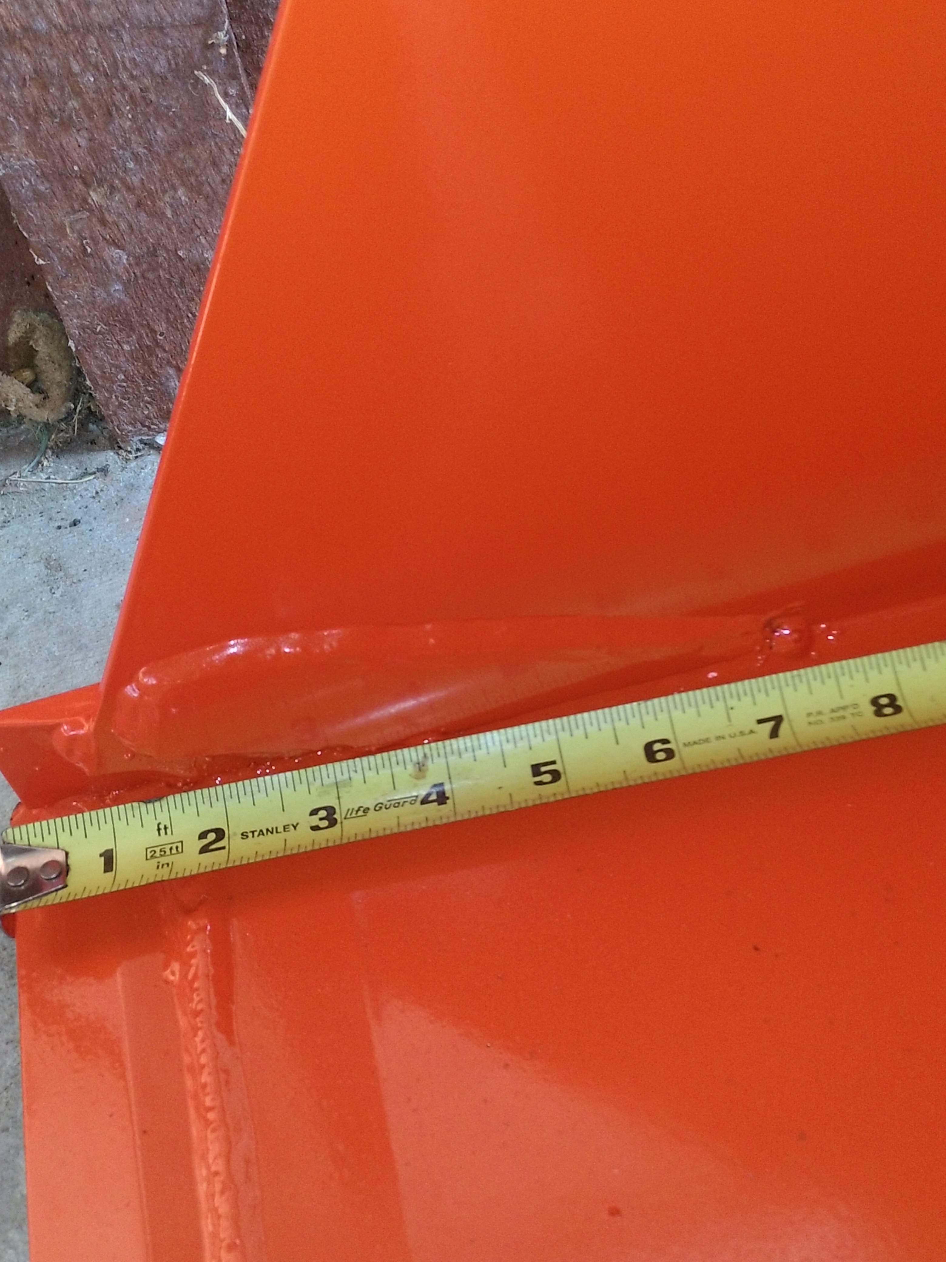

I have the same tractor and bucket and was wondering if you could guide me on the length you selected for your Piranha tooth bar?
I measured the inside dimension and depending on where you measure, it is between 58 1/16" to 58 1/2" wide. I'm going to attach a picture to help explain...if you measure the vertical sides of the bucket it is exactly 58 1/2"......if you account for the thickness of the welded reinforcements where the vertical sides meets the horizontal bottom, it is 58 1/16". Hopefully the attached picture will help show what I'm explaining. Based on those funky welded reinforcement, what lenght did you order? I can do metal fabrication so, if I need to extend the reinforcement to make a solid mounting surface at 58 1/16" wide, that will not be a problem.

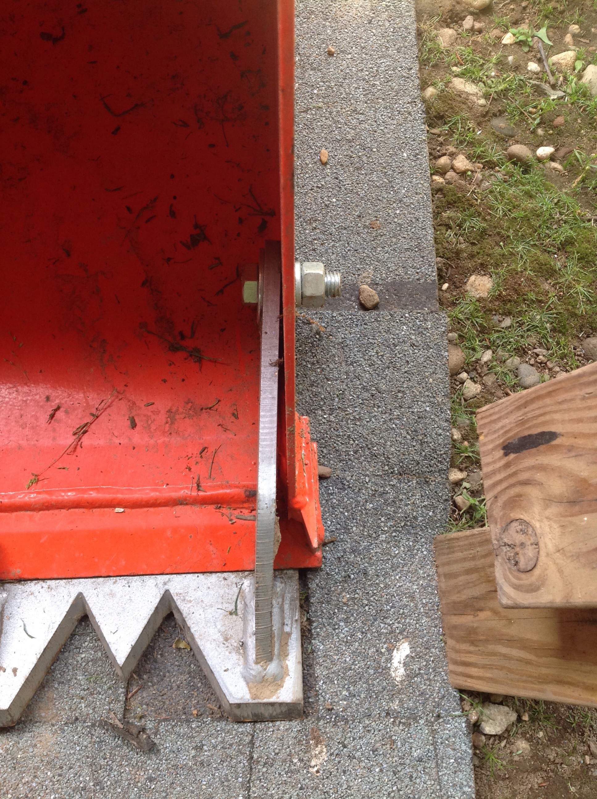

He might have said that he has longer ears that can be attached that will get beyond the reinforcement. That's what he said to me. I received my 60" (58 1/8 ") PTB yesterday and installed it. We discussed the fact that I might need slightly longer bolts and he suggested that I go to TSC and pick up something if necessary. I was able to just barely get the bolts tightened using a c-clamp so I did in fact replace one of the bolts. I'll attach another picture of the PTB installed when it stops raining. As you can see my bucket is very similar.

I provided both dimensions and a photo. When I received my PTB, the ears were welded to accomodate the smaller dimension. I asked before installing because it looked like the ears would need to substantially bend during installation and I was told that this is ok and normal for the install. Long story short, I installed using a clamp to help pre-bend the ears and all is working as it should. In the future, I may weld a piece of plate on the inside of the bucket where the PTB ear holes are so the ear / tabs do not need to bend as much and installation won't require the use of clamps. Here are a couple of photos of mine installed.
Also, I never thought about this until after I finished my install but, if you have the capability of welding thick steel, I might see if he will provide the tooth bar cut to lenght and the ear tabs un-welded. In my case, I would have preferred that for my install, as I could have welded the tabs in the perfect spot on the tooth bar and I wouldn't need to weld any plate spacers in the bucket (which is probablly overkill but that's the way I roll :thumbsup:)
