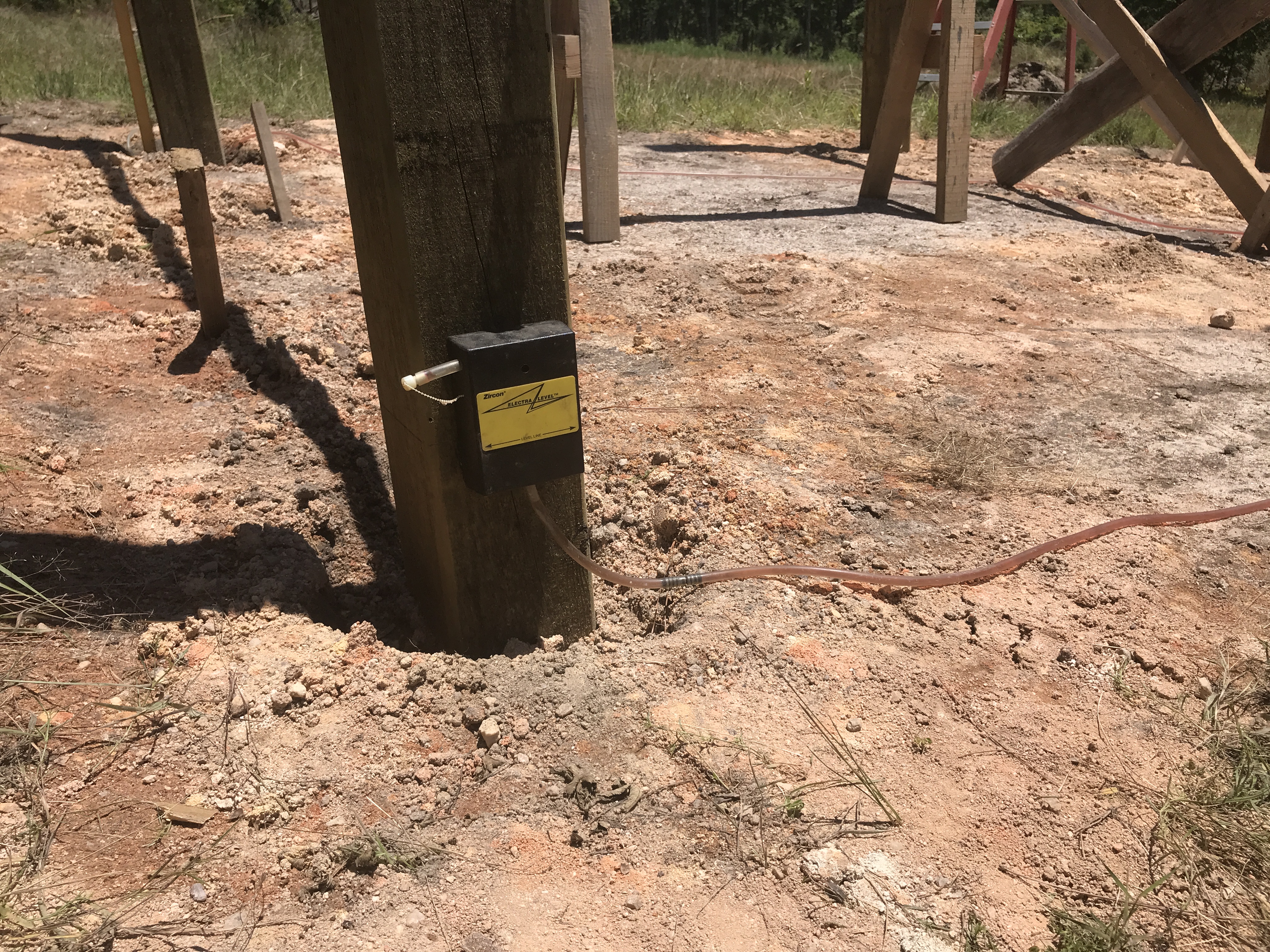

So getting ready to install the decking on my little project...
Anyone recognize this little gem?? Old school..

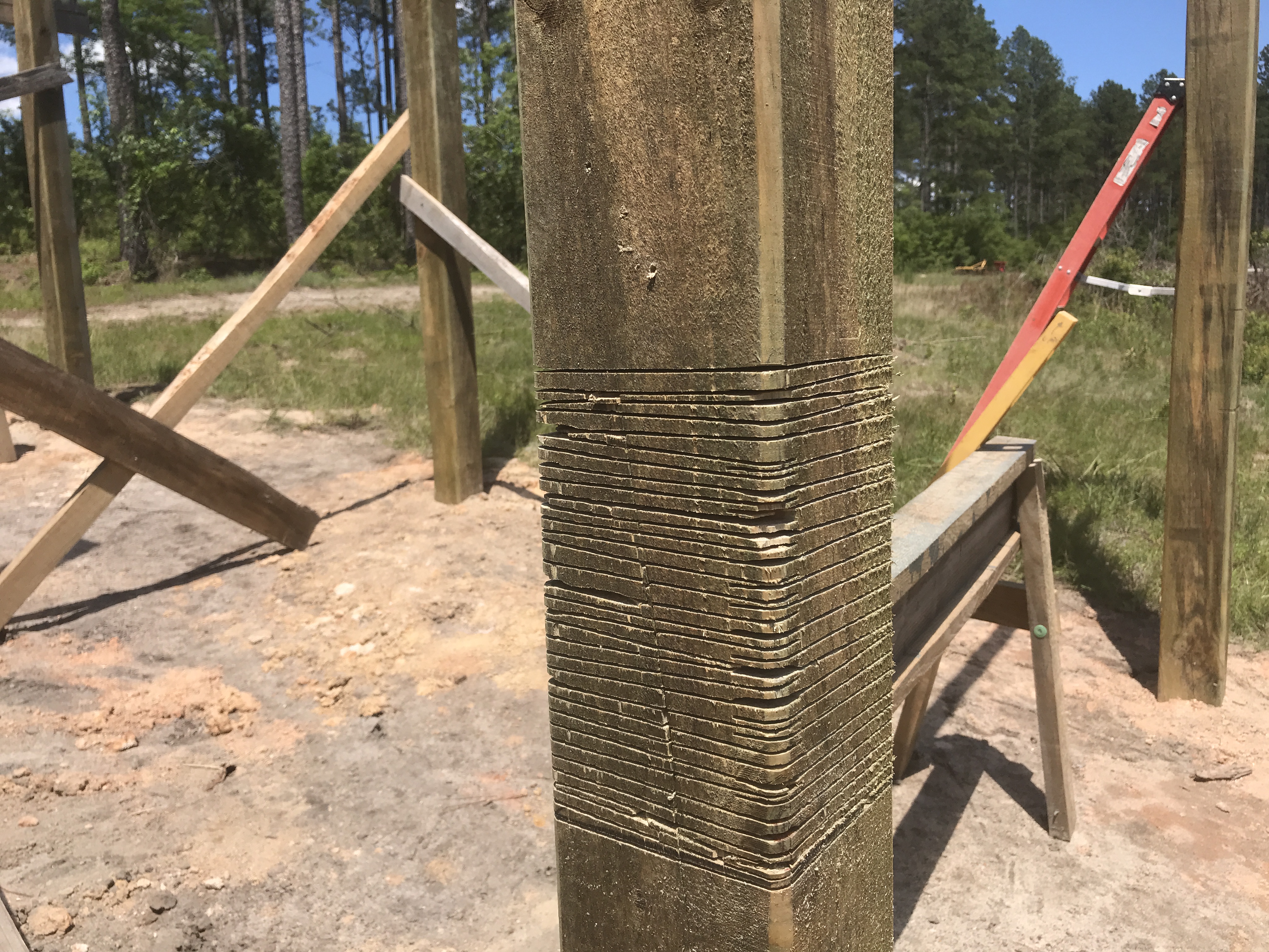

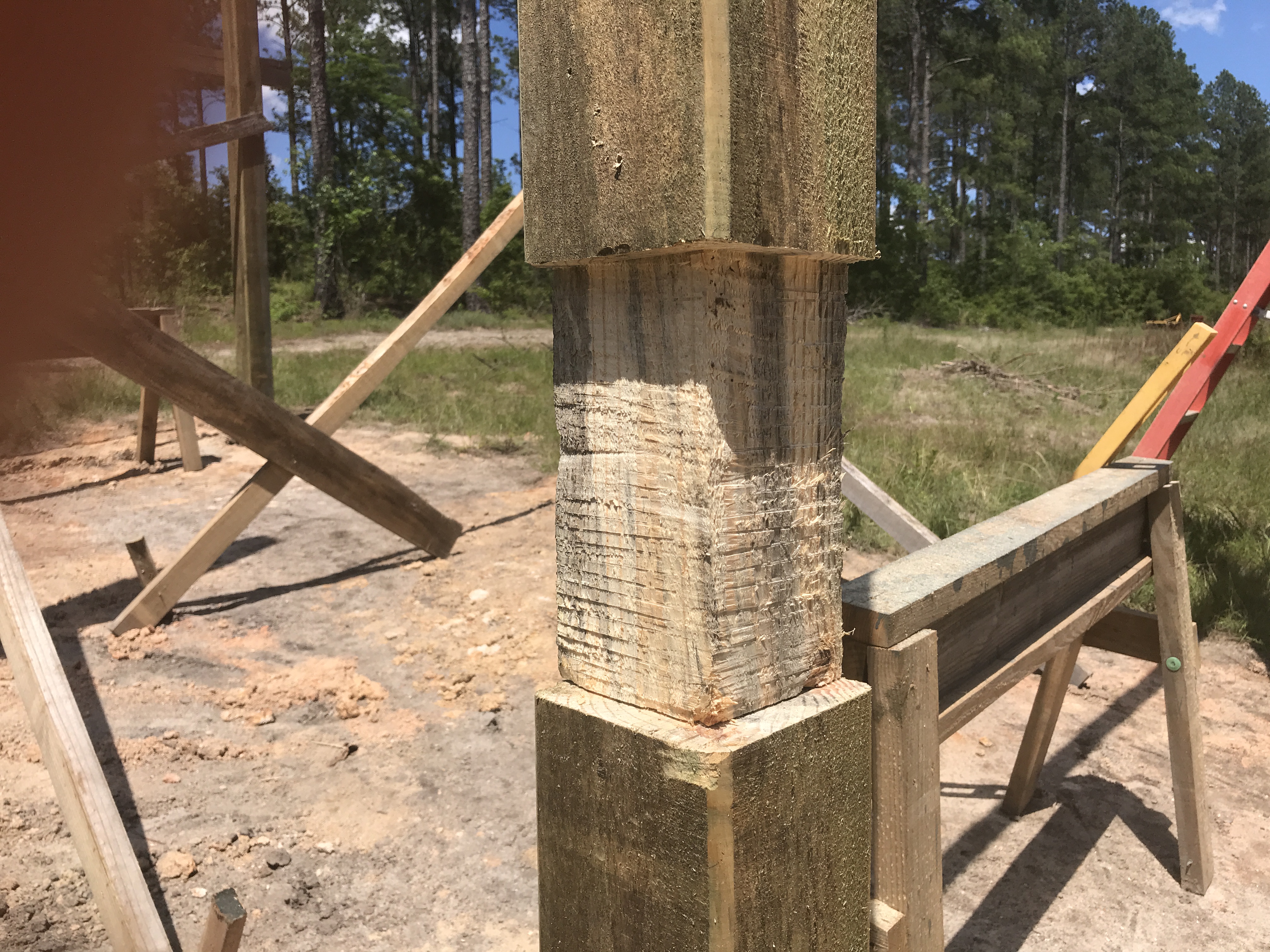

Do some slicing
And knock the pieces out..

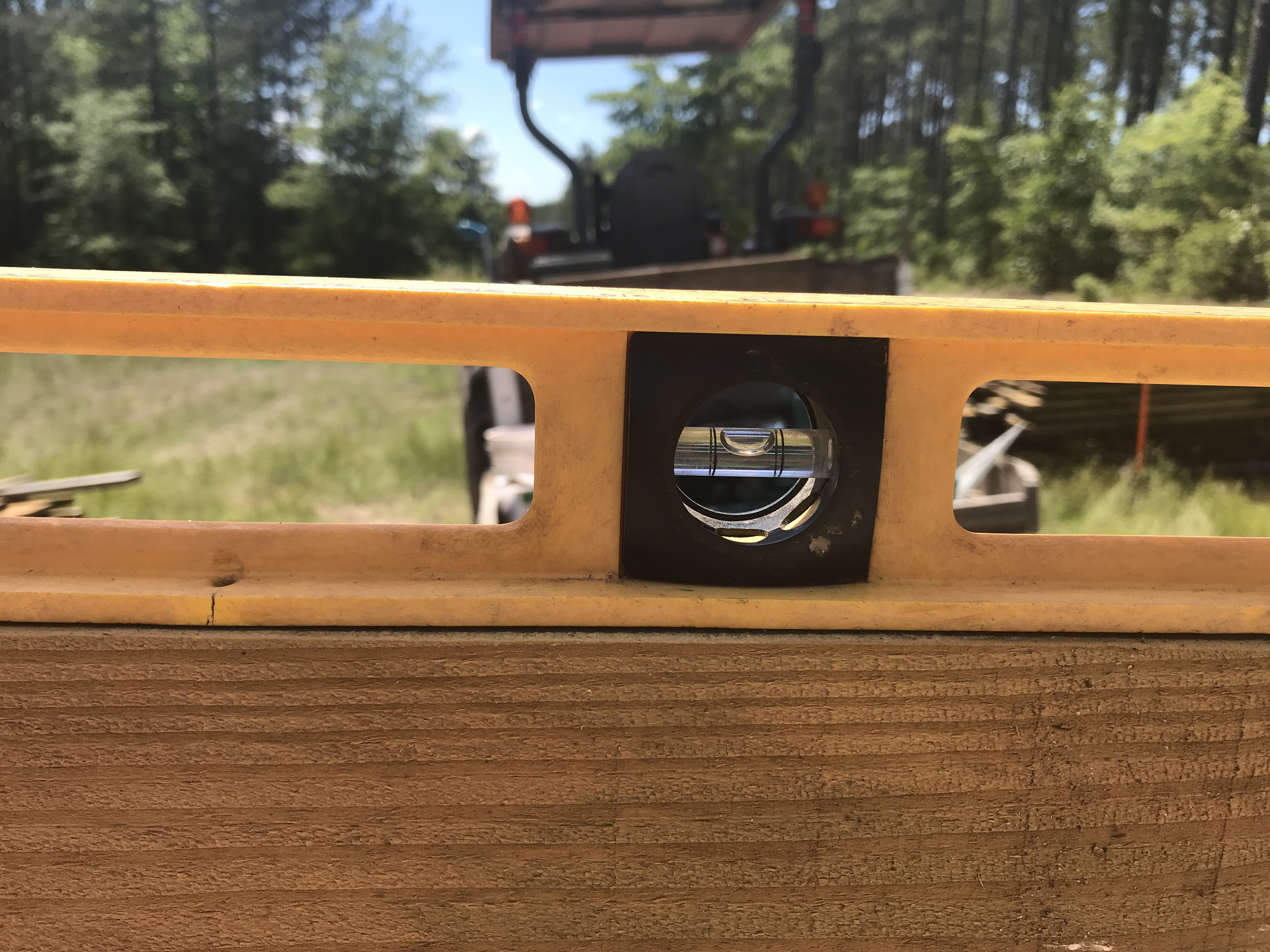

Set one board up to check level..
And we're good!

Never seen a high flueteun water level like that.:thumbsup: I still got the round tub with the coil of hose wrapped around it. Most jobs just had a clear hose with water red dye and alcohol in them .:drink:

I bet I've had that guy for 30 years. I have not used it in more than ten probably! I was a little concerned if it still worked, so I pulled it out, filled it with water (and a few drops of food coloring), put a new battery in it and it worked just like it used to. It beeps when it reaches level so one person can use it and not have to see both ends. Definitely high falueteun as you say!:thumbsup:
Looks like Zircon still makes one, mine is obviously an older model..
Electronic Water Level | WL25 Water level | Zircon

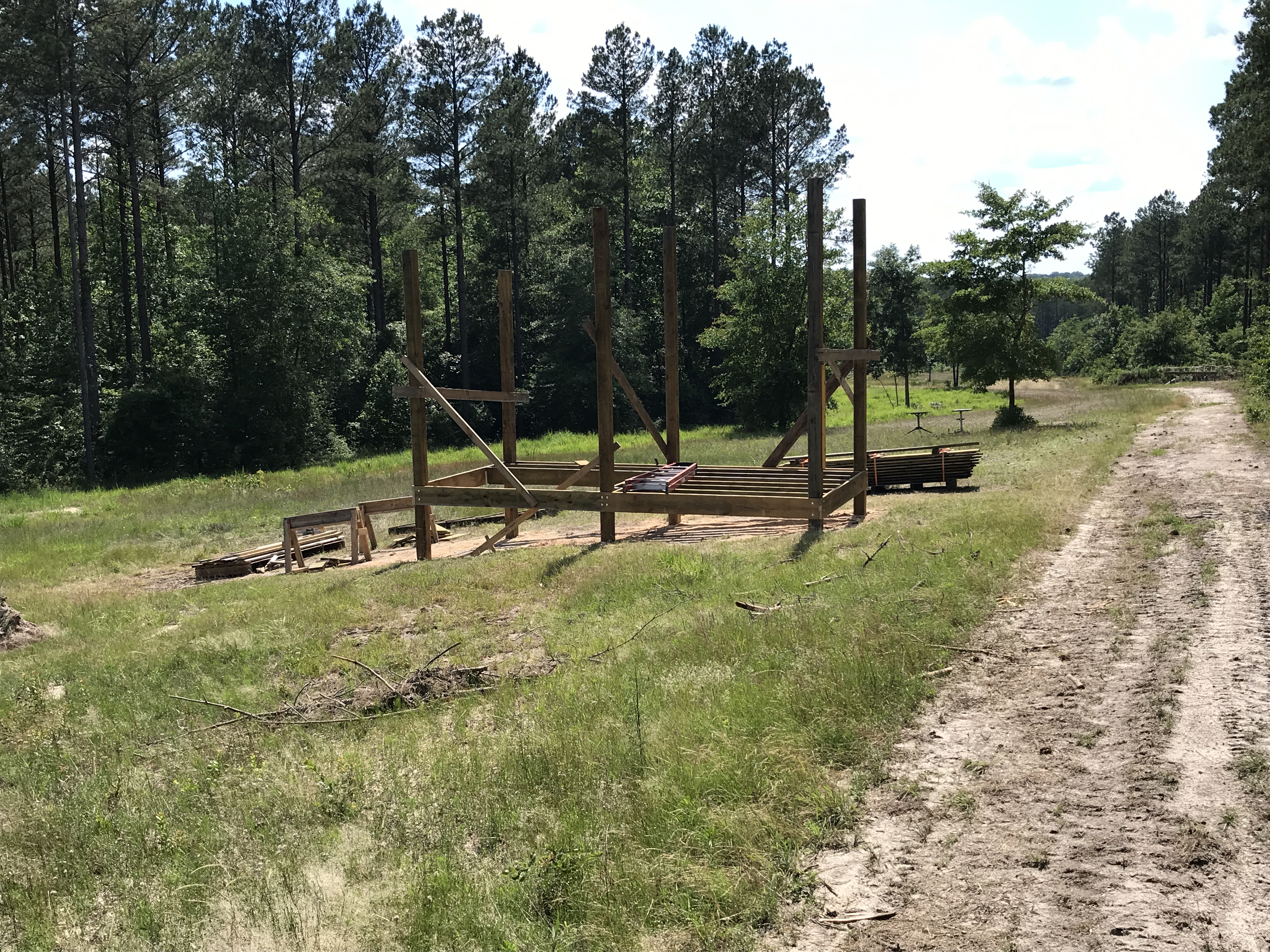

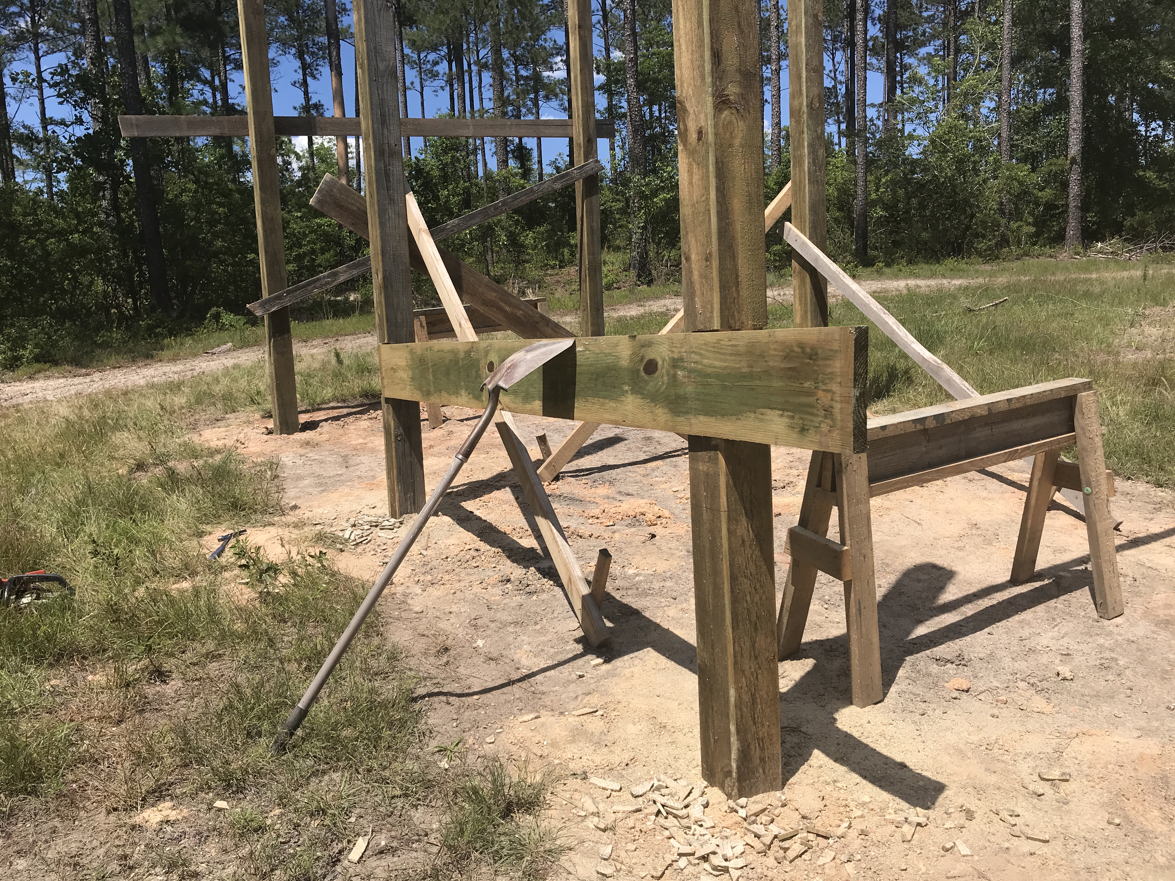

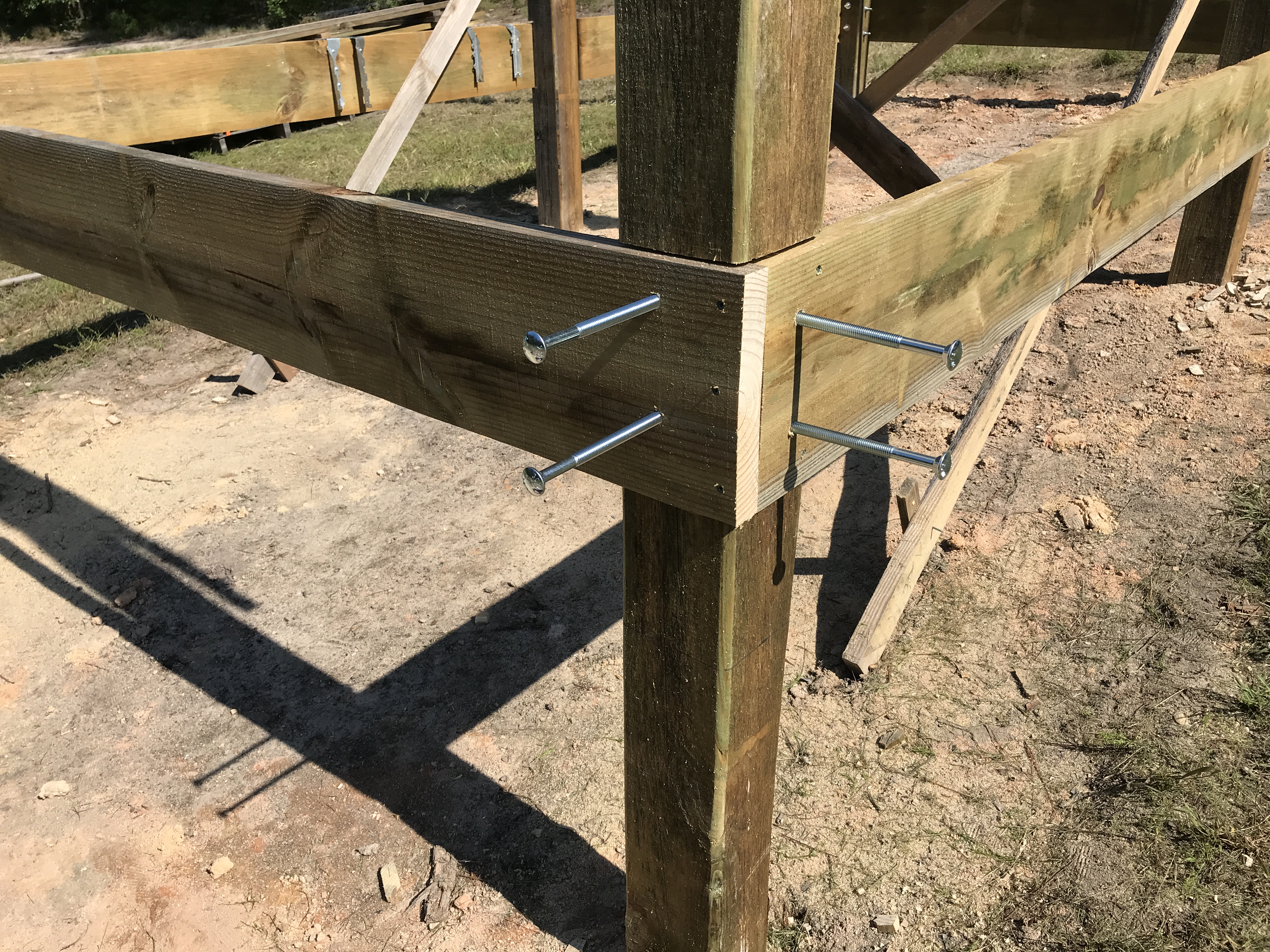

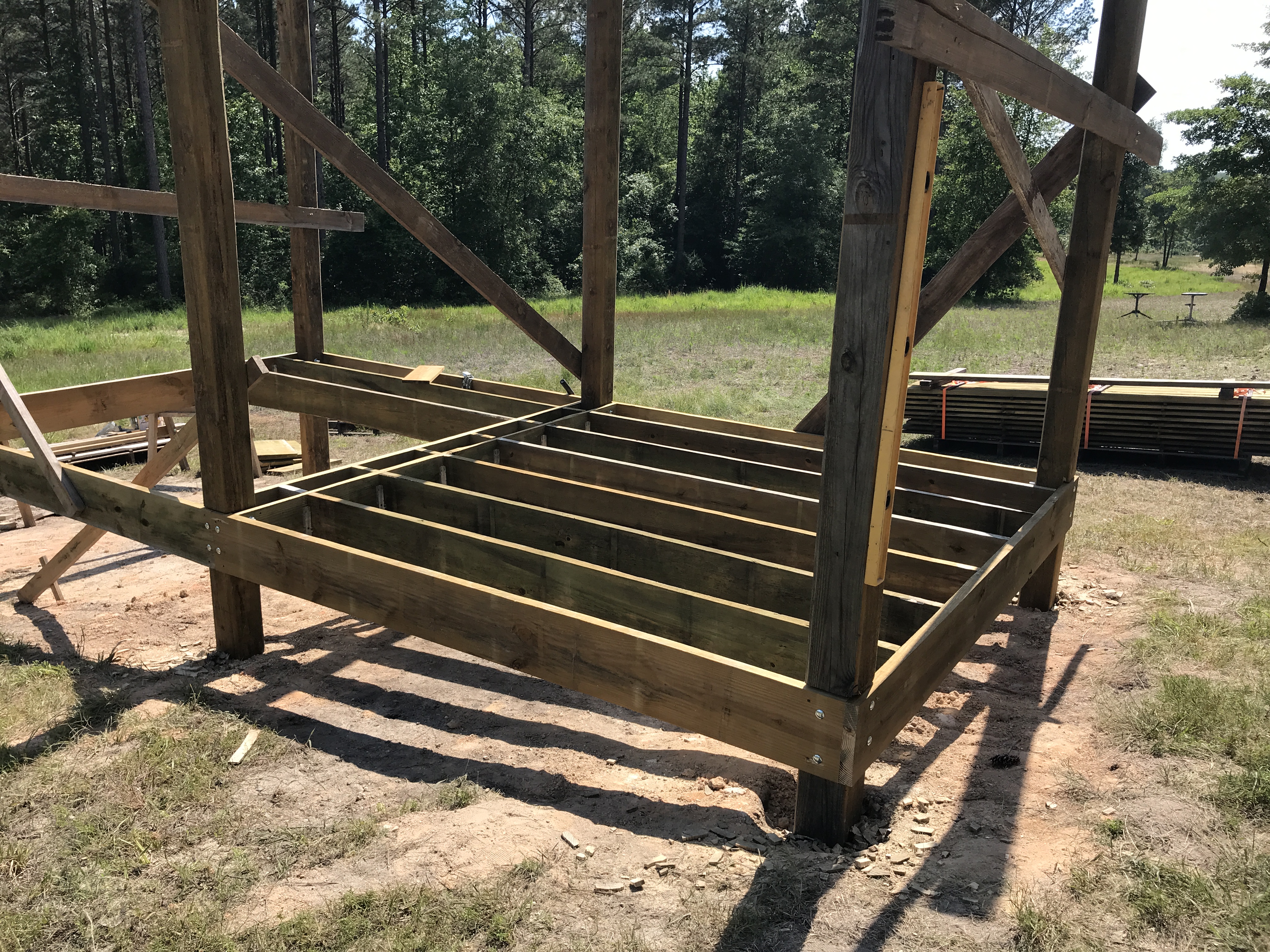

A little more progress...
Bolting up the rim joists

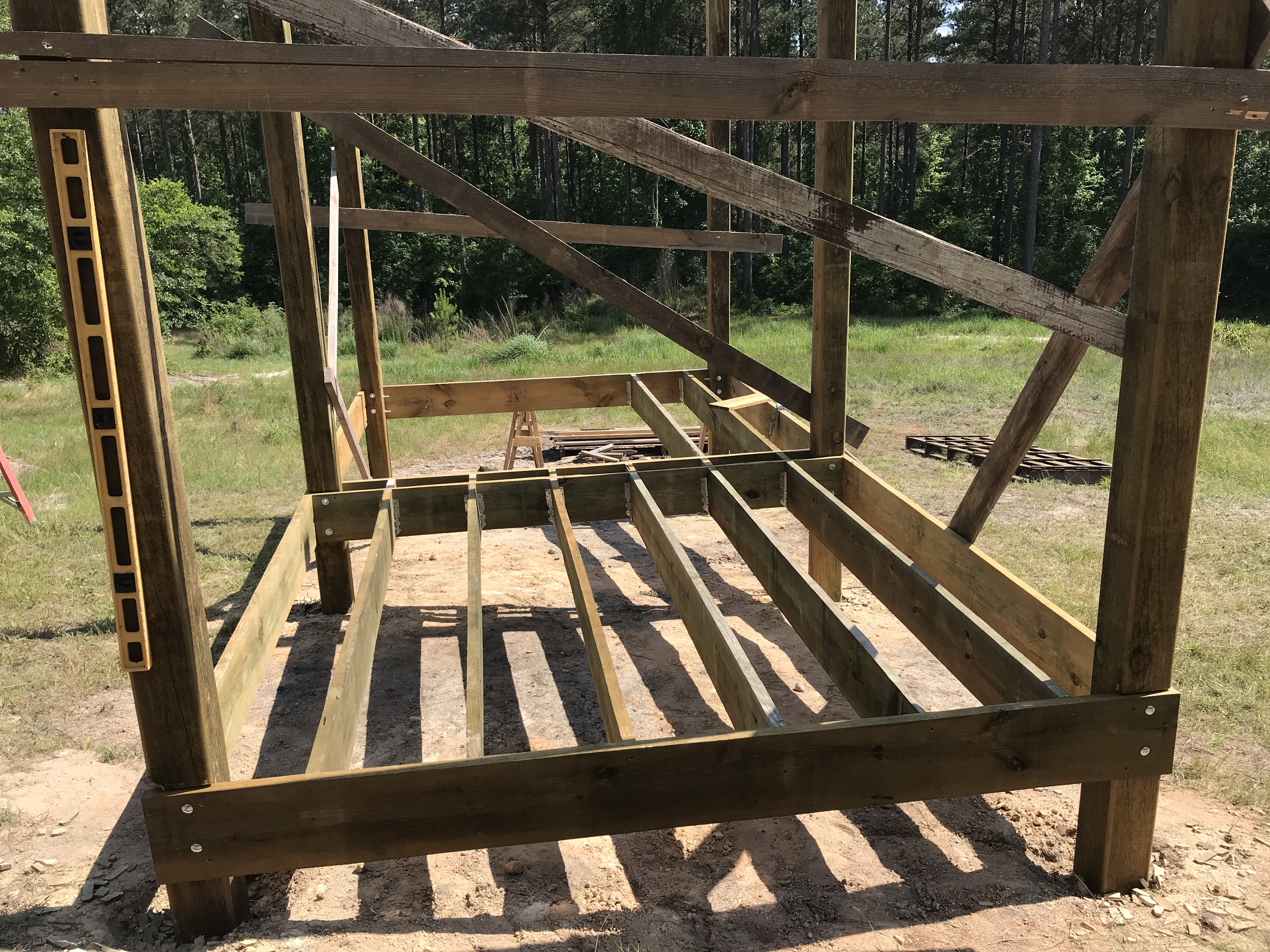

Getting the joists in getting ready for decking
Wont be too long for stage one..
   / New shooting deck #20
Have you ever used the simsion black bolts instead of carriage bolts they are a lot faster and simsion say they are equal to carriage bolts in strength. Simsion Headlock they are called . I think a carriage bolt I definitely stronger the headlocks are just faster. are the carriage bolts you are using galvanized or zinc the galvanized hot dipped are usually used in exterior work and zinc in interior work. Nice to see someone take the time to let in the rim joist add lots of strength.:thumbsup:Excellent work . We do you want me there with the beer and tannerite.
