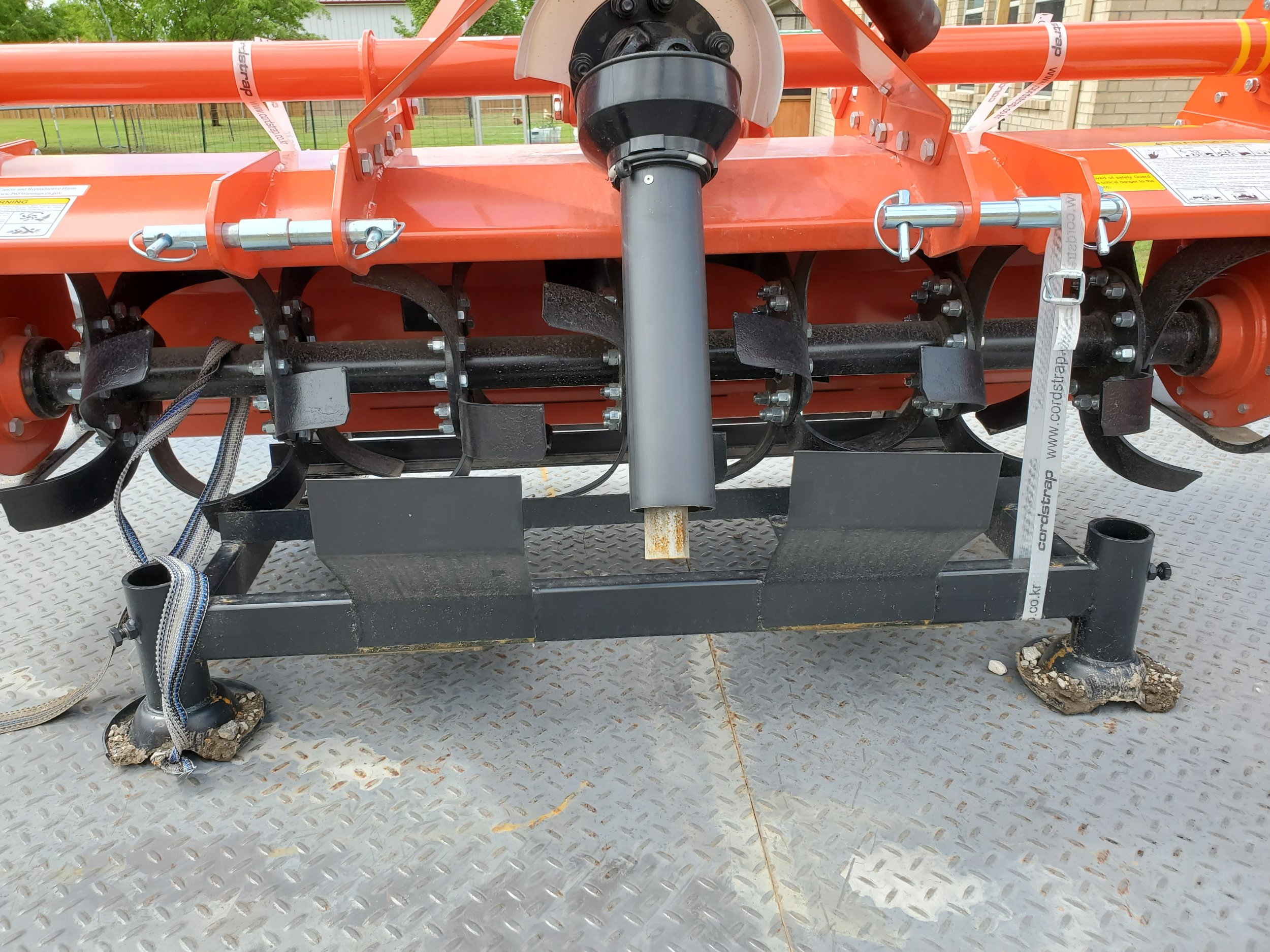

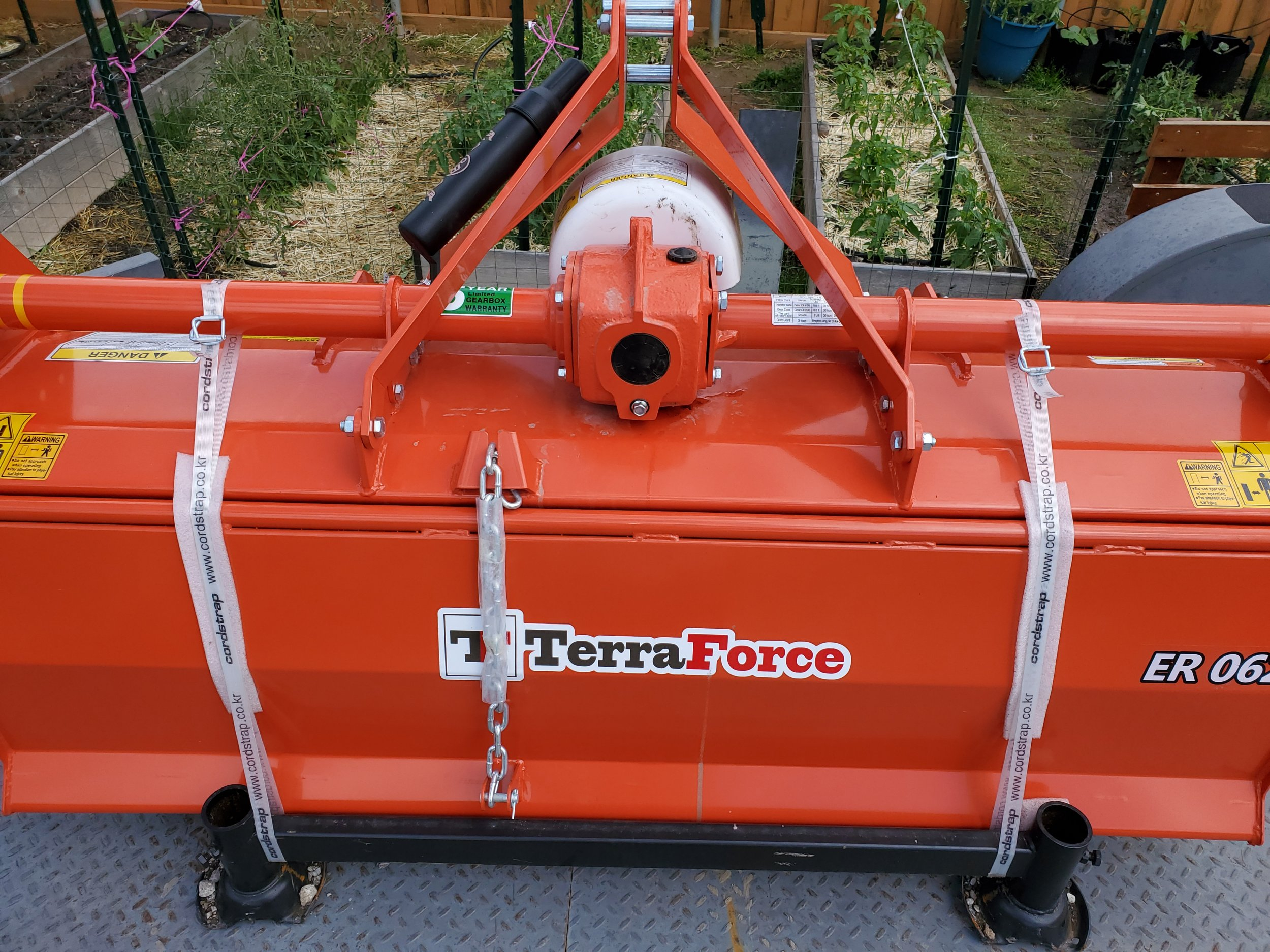

Third, this tiller was shipped on a nice metal stand screwed onto the shipping pallet. Unfortunately I didn't take a picture of exactly how it sat upright on it. I've tried several different ways but can't figure out how to place it back onto the stand so that it is stable again. Anyone know? Pictures?

The slip clutch should be just in front of the tiller's gearbox and the "push pin" end is what connects onto the tractor's PTO shaft. You can see the slip clutch here. Was yours not already attached?
I have a Terraforce 62 and to place it back on the stand I just have to use the hydraulic toplink and extend it out so that the rear shield of the tiller sits inside the posts of the stand like this.
There should be a "stand leg" on the front you can also lower and just have the tiller rest on it and the tines as well.

Thank you for the pictures! So in that position on the frame it doesn't rotate forward?
The 1025R doesn't have a great lift. Consequently when I took the tiller off the stand it bent those front plates. Do you know what the purpose of those plates are?
Mine can not as the back pan is caught by those posts.
Not sure, maybe a visual guide for placing the tiller on there or some sort of protection from the forks or whatever they use to move and stack them.
