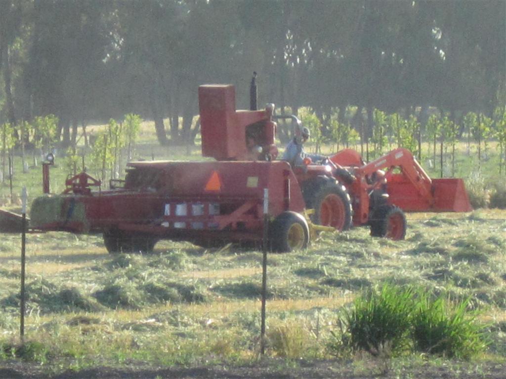

My Massey Ferguson 124 baler (two-twine, small squares) is rated at 35 hp (pto) minimum. The 124 is comparable to those NH balers you're eyeballing.
But I've seen balers this size run off much smaller tractors like a Farmall Super A that has only about 20 hp pto.
FARMALL Super A - YouTube
The baler portion occurs about 6 minutes into this video.
You might try to find a baler that has it's own engine (usually a 20 hp Wisconsin engine). My neighbor runs one like that with his Kubota L4400.

Baler: I bale with a Kubota compact tractor similar in size to yours although you do have a couple more hp. I use a New Holland 65 baler with it which is the smallest of the balers made and it works well. The 65 is 12"x16" bale chamber instead of the 14"x18" chamber that the 273 or 276 will have. Bigger chamber means more rotating mass creating more of a gyro/rocking affect which can be harder on a compact tractors driveline. I would pick the 273 over the 275 if you are determined on only those 2 choices as it is a slightly lower capacity baler I think but am not certain. Even if you were to find a 65 though it may not be compatible with a grapple do to oddball size so probably best to stick with the common 14"x18" baler size if a grapple or automated handling is in your plans. Or if as other posters mentioned that your tractor will not handle the grapple then I do like the 12"x16" bale better for plain ole manpower lifting - most women prefer that size too as they are easier for them to handle if they are the primary feeders of critters.
Cutter: I am assuming that should have read New Holland 467 or 477 haybine (I have never heard of a 427). I think you have the hp to run the 7' haybine but be weary of the overall weight of the implement, especially tongue weight, and the side draft of the implement. You may be okay on flat ground but it would be best if you could try before you buy. I have a 9' Hesston mower conditioner and no way would I hook it to my little Kubota due to the overall weight of the implement, the immense tongue weight of it, as well as the side draft. On the other hand my lowly Farmall h of similar hp will handle it, but longterm I am fixing up a Farmall m to run it. In my opinion either a small drum mower or a sickle mower is the best choice for a compact tractor hay cutter. Except you will not get conditioning with them which your alfalfa will need so you will have to add either a separate crimper (I like the Myer conditioners since they had a pick-up reel) which is doable or a tedder. Tedders are nice, but can be tricky to use with alfalfa or you will destroy the leaves.
Rake: I agree almost any ole rake will suffice. I run 2 JD 594 vintage rakes on steel wheels that I have refurb'd. I like them because they make fluffy windrows that dry very well. Paralel bar rakes, while more modern, do cost more and have tendency to be rope makers and the windrows will not dry as well. Lots of metal in those old 594's too, so you can weld up parts as needed to correct slop/wear.
In summary: Your current tractor can certainly do the job if you make the right choices. Or you could pick up a cheap bigger tractor, but that only further adds to the difficulty on getting this project to pencil out to profitability so to speak.
