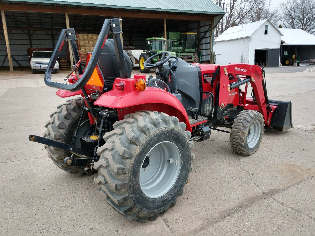

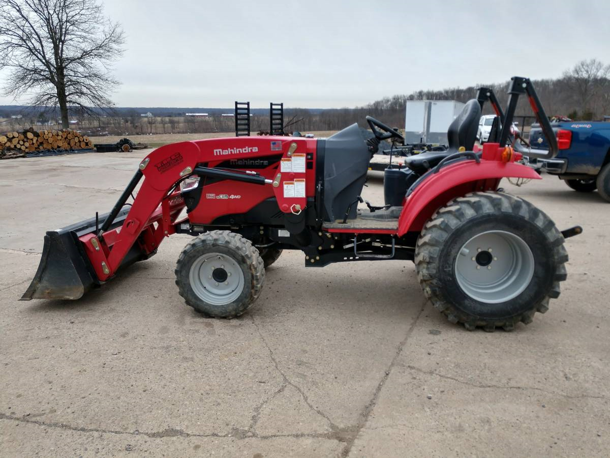

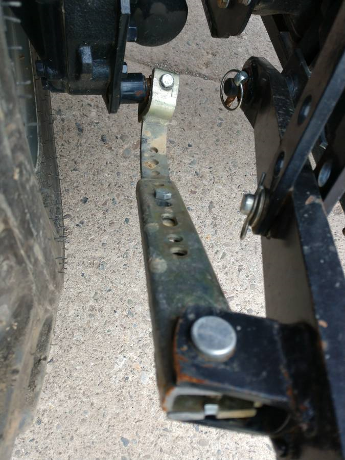

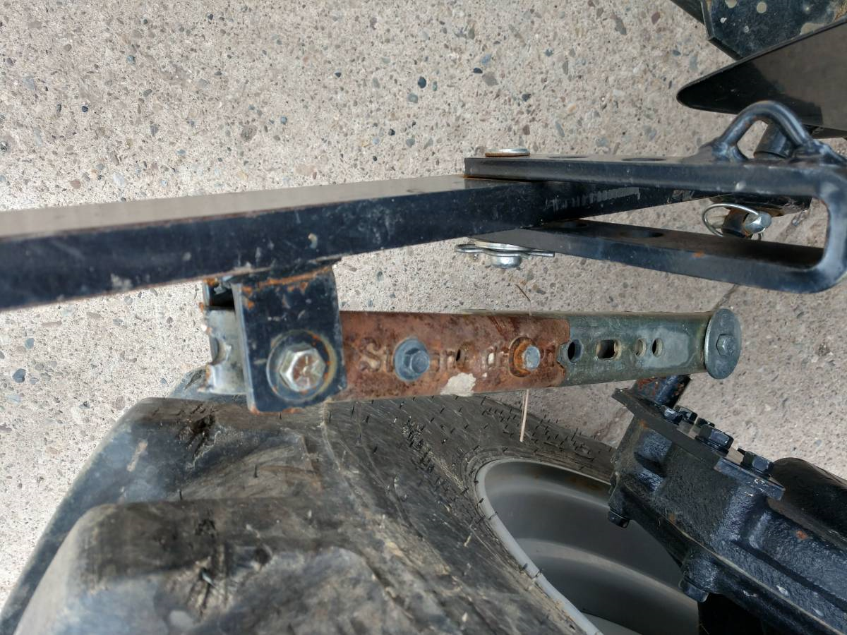

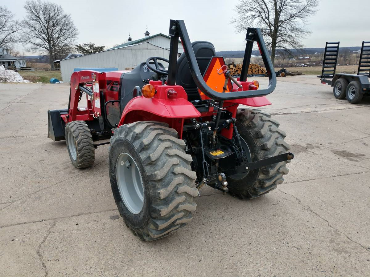

I just purchased a 2015 Mahindra 1533. Just been playing with it a little while I await purchasing some attachments. I have a question in regards to the arms attached to the 3 pt. hitch. One of the arms is bent and don't know what the previously owner did to bend it, or if I should be concerned about it. The other arm, it looks like they modded it with different pieces. Please let me know what you guys think and if I should just replace them with new ones or not be worried. I plan on getting a quick hitch to ease connecting to attachments. I appreciate everyone's help. This is my 1st tractor, so I am definitely tractor illiterate.

From the two pictures it looks like the lowers are not bent but one of the stabilizer bars are. Easy fix. And from the pictures with your other equipment in the background should be no trouble for you. I would raise the ROPS to halfway down. The 3 point will hit it where it is now. I've had my 1533 about 3 years and about 200 hrs. Really like it. If you just bought it I would do a 200 hrs tune-up. Oil, hydraulic fluids, Fuel filter and such. The seller probably didn't want to put any money into it before he sold it. Good luck with it. It's a great tractor.

It looks to me that the previous owner was trying to run a Cat 2 implement on the 3pt. A lot of the Cat 2's are wider, they spread the lower arms out farther than the Cat 1 spacing. You can see that he has run the right one and it has wore on the inside of that side rear tire. Not knowing what the heck he was doing, or if he knew what the heck he was doing, I can't say much more than that. You can also see that he torched the ends of the sway bars some, probably in a vain attempt to keep it from hitting the tire. A lot of Cat 2 3pt stuff can fit on the back of your tractor, but usually they mount the attachments lower pins facing inward so it does not spread the lower link bars too wide. He might have been using something like a 3pt backhoe, or some other thing that was adding extra side stress to the sway bar, thus bending the left one. I think you are good to go. I would try to straighten the left one, and maybe run a grinder over where he hacked on the ends. That's a nice tractor, made by Mitshubishi .... :) [ I've got one of it's littler brothers ] [ and another reason why I could never be a dealer... I would take a baseball bat to someone that mistreated a tractor like that... ]

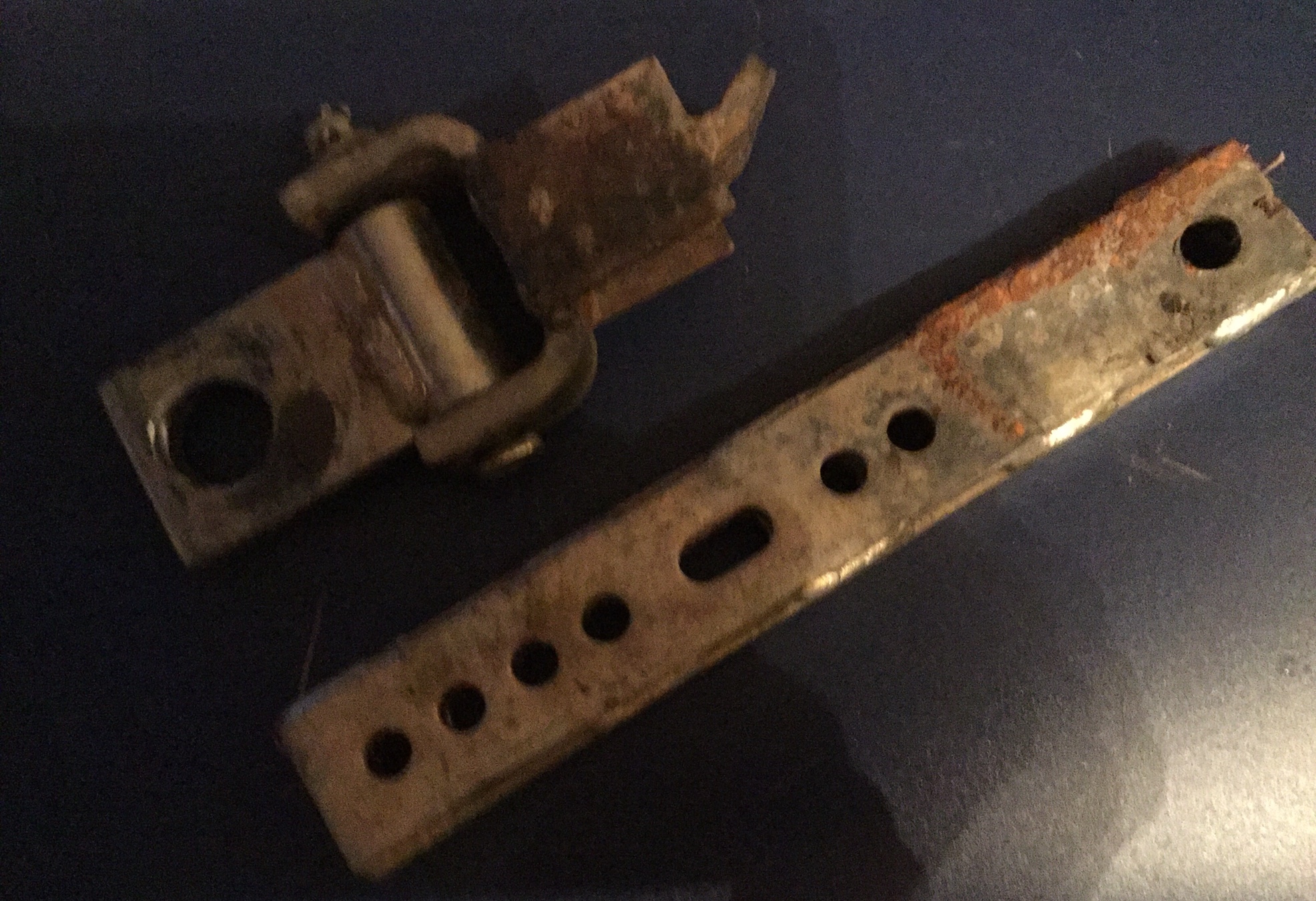

They are good tractors. And I know what happened. The telescoping anti sway bars are made of cheap, porous pot metal. I have been looking for a fix. The original owner tried to “fix” it. I think I am building a new set. I welded mine and then bush hogging lost the part that connects to the draw arms, it broke past the weld. You will enjoy the tractor. IMG_7330.JPG
