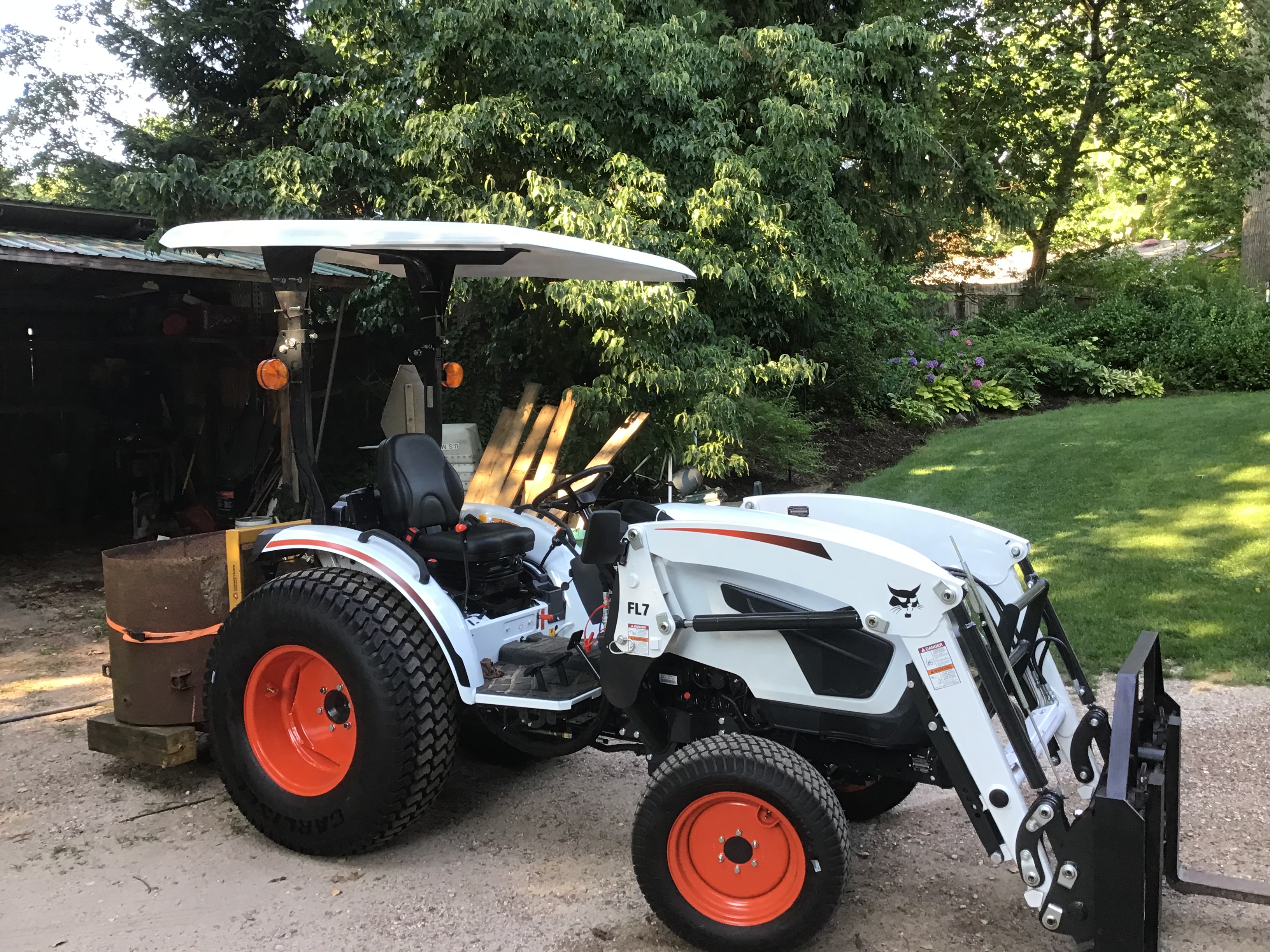

There are quite a few options..... you can look on Ebay or try a place like this:
Tractor and mower canopies | RhinoHide Canopies LLC
I have heard good things about them, they are some of the better priced canopies.

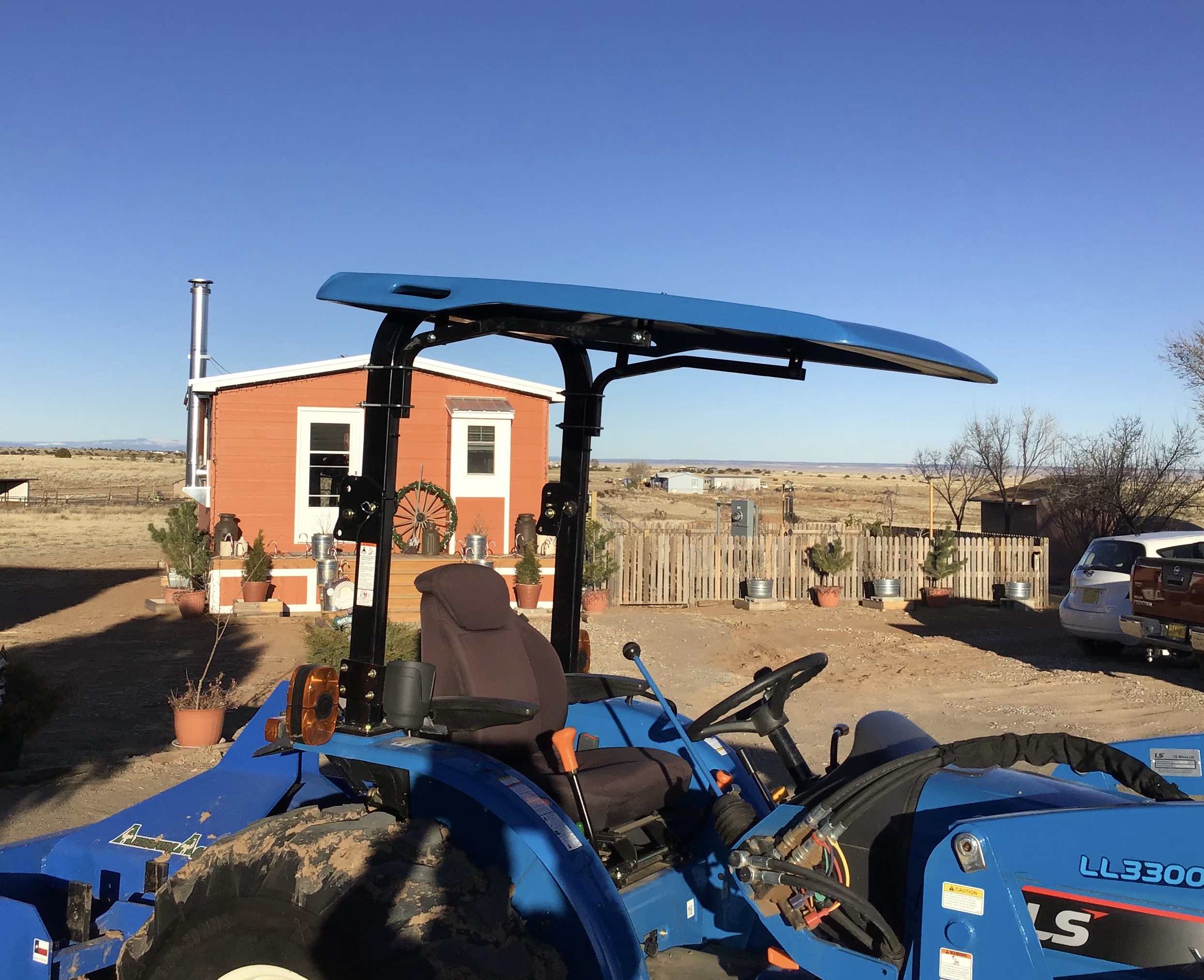

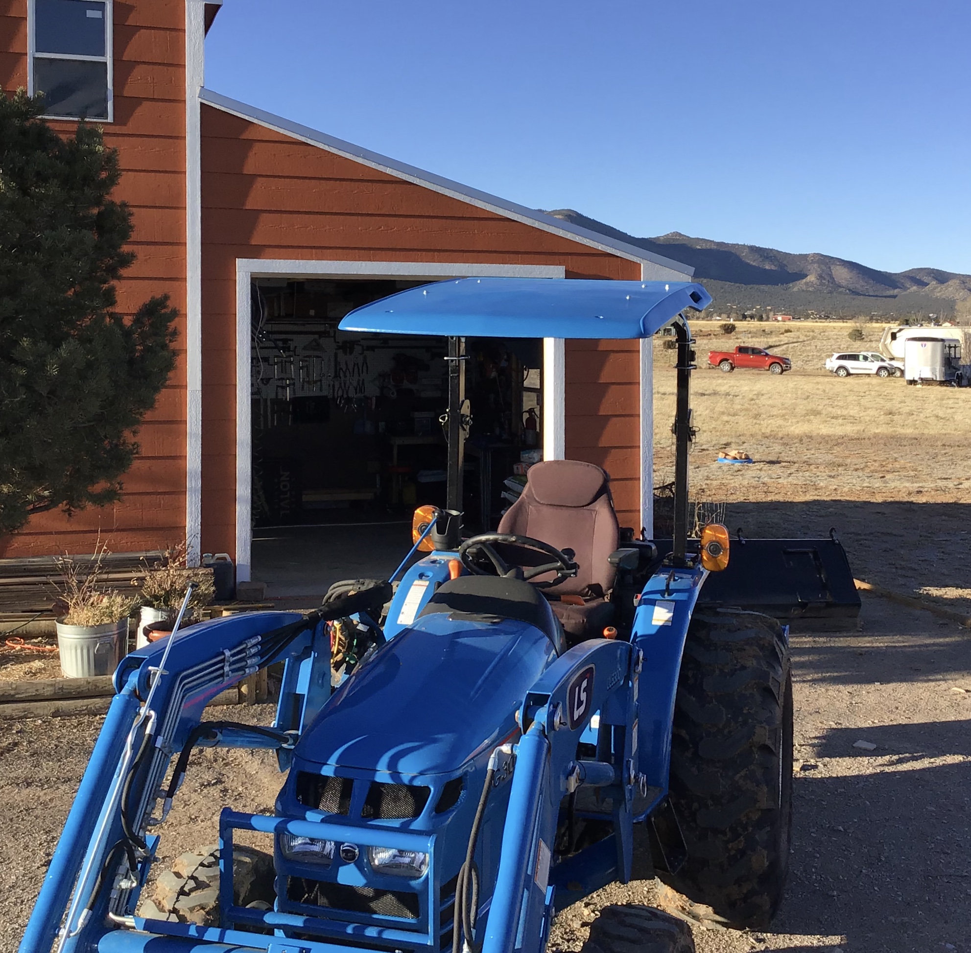

If you are handy, you can sometimes find golf cart canopies that can be adapted to tractor use. That's what I did, total of about $50 into it. My neighbor did the same thing, but his cost him around $100.

Wow that looks great. Where did you find the golf cart canopy? and thanks for your advice. I was actually looking at the LSMT225s as well but then went with bobcat ct2025 as the dealer was 5 min from my house and the specs were pretty much the same.
   / New to tractors: just bought Bobcat CT2025 #4
I got mine at a golf cart repair shop. He had about 20 out back in his 'junk yard' he sold them for $20. That place went out of business a couple months after I got it.
My neighbor called a new golf cart dealer and they had a couple used ones, but they wanted $100.... new was $250 without the hardware.
Search the internet for local golf courses or Cart repair places.... they should have at least a few....
Congrats on the new tractor.... please post pics when you get it!

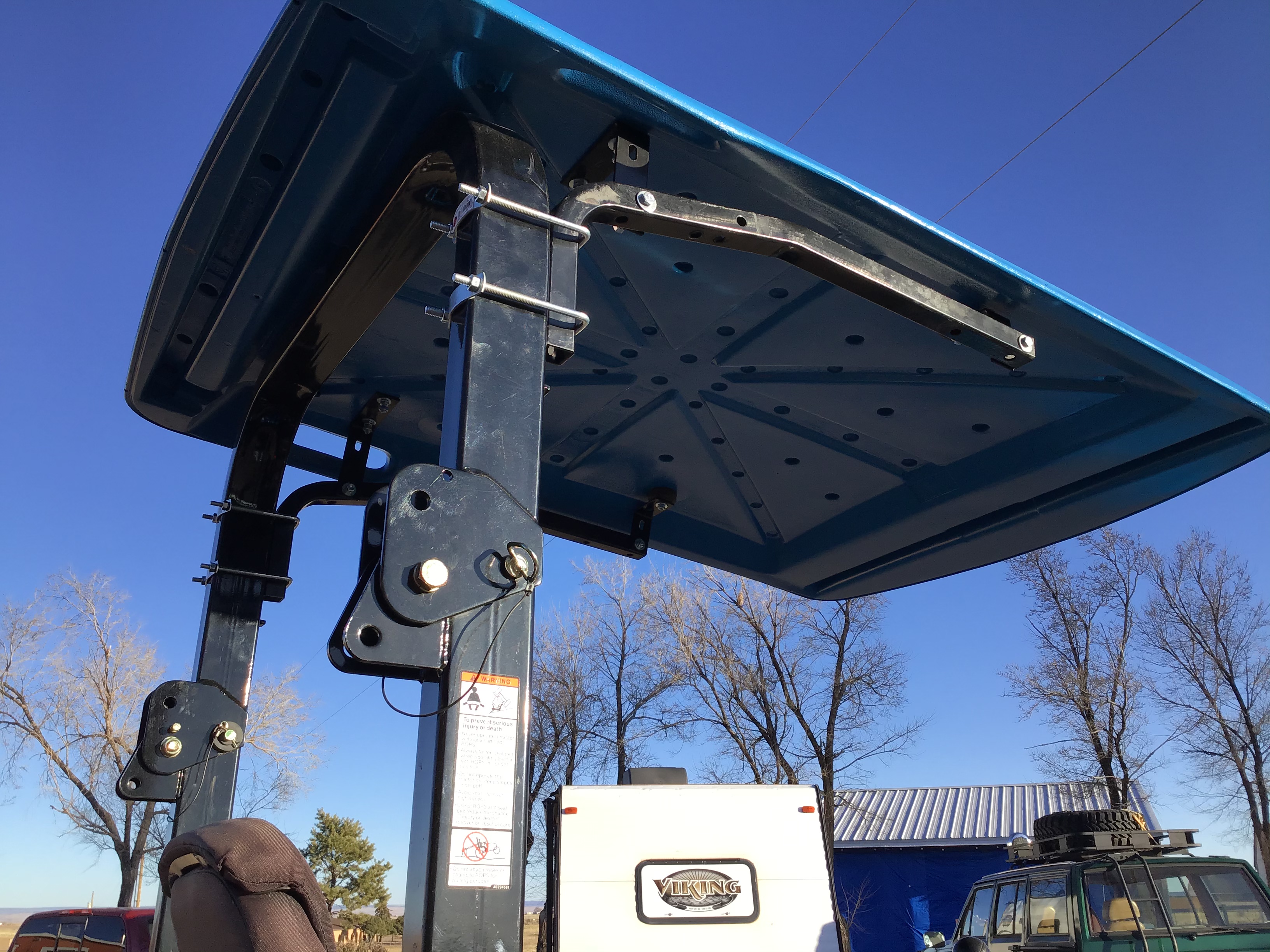

So I found a roof. How did you make the brackets?
I was fortunate, there were a few golf cart brackets out in his yard. I was able to get a couple different pairs. One set just worked perfectly. I made brackets for my neighbor, just used 1" square tube, 11 gauge thickness. Just welded a 90 degree ( more like 100 degree) angle the down leg about 12", the horizontal leg about 36". Used square U-bolts to the ROPS. Bolted the roof to those.

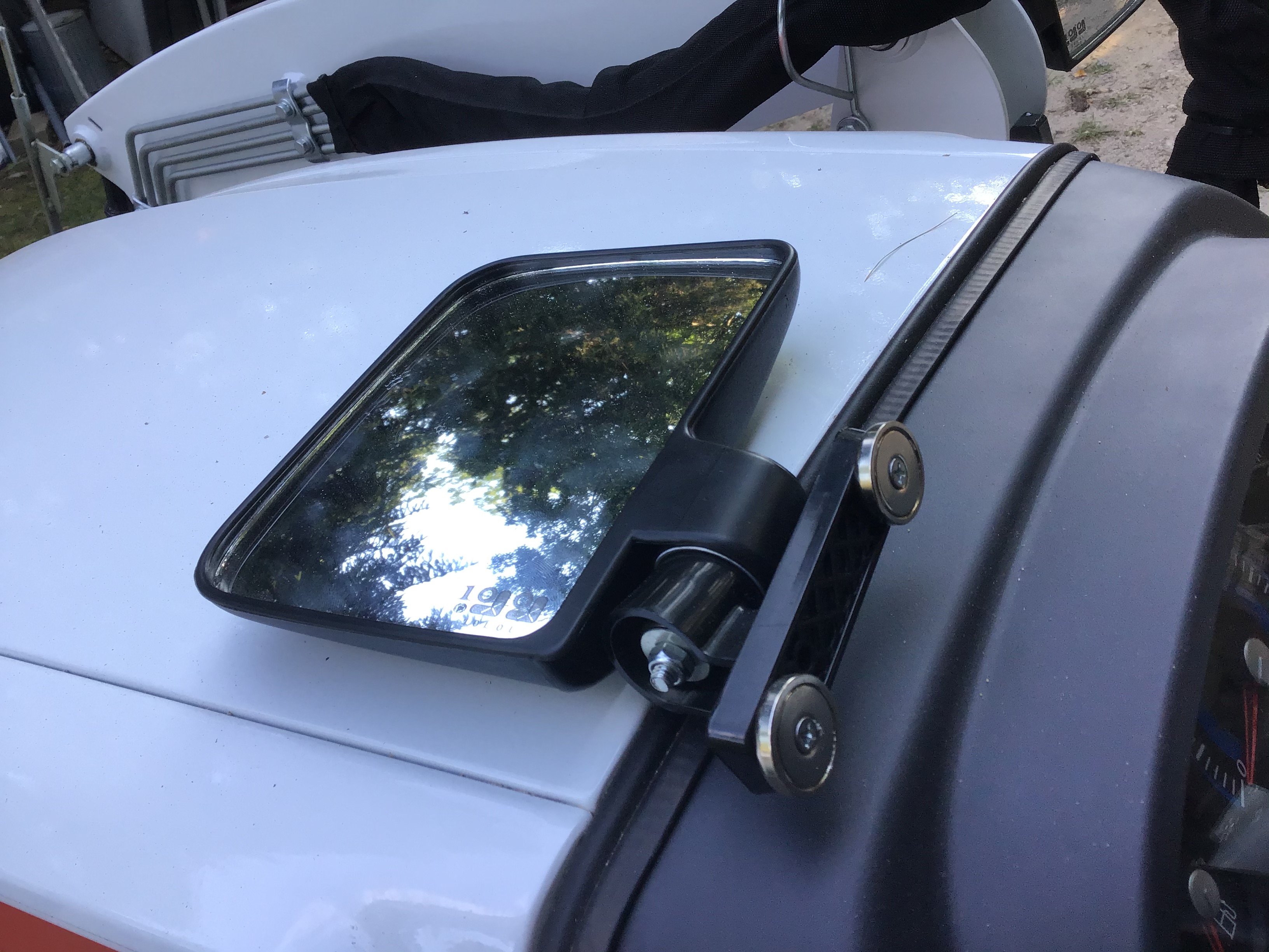

Congratulation enjoy tractor!
I also added a canopy and added mirrors. cheap golf cart mirrors with magnets
