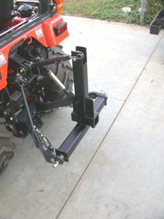

5. How can you mount a standard ball hitch on the tractor? Is it a 3 point implement?

*You need to buy/build a 3ph/box hitch adapter. See attached. Do google if you want to buy one, plenty around.

Ball hitch can be mounted on the draw bar or the three point. The three point will require a tool bar to do this. Lots of versions of tool bars out there. Many build thier own.

#5- Most tractor draw bars will accept a trailer ball, bolt it into the hole just like you were putting it on your truck or car bumper hitch. There are many 3 point attachments that can be bought that have a ball on them or can accept a ball and it can make some things easier, but unless your going to be changing trailers frequently this attachment isn't necessary in my opinion.
