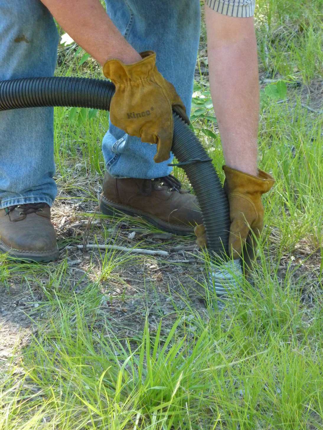

For me the hole vacuum idea really panned out well. I was able to vac a hole about 4 feet deep and the hole diameter was about 3" (whatever the tube diameter was for the shop vac). I sucked the hole in just a few minutes time. I did run into two small roots....and used a metal pipe to pound through those....then back to the vac....no sweat. I did not use any auger or other means....just the vac and hose.
I'm sure I could have sucked another few feet deep.....but I did not have enough pipe to do the job.....and I started pushing flex tube into the hole. I was afaid I would not be able to pull the tube back out.....so I quit.
To answer your question on depth......I dont think anyone can tell you for certain....as wells vari so much. But if you have damp / wet soil coming now.....its time to drive your sand point.
I drove mine too deep (over 25 feet) and lifted it back up with a handyman jack. It now is 21 feet into the ground and I have measured 11 feet of water in the pipe.....using a length of string and a nut for a weight.
If I were more experienced at driving sand points.....I beleive I may have saved driveing two 5foot lengths of pipe. I just did not perform the right checks for water along the way....or didn't realize when we had good water.

A pic of my end result. :D
