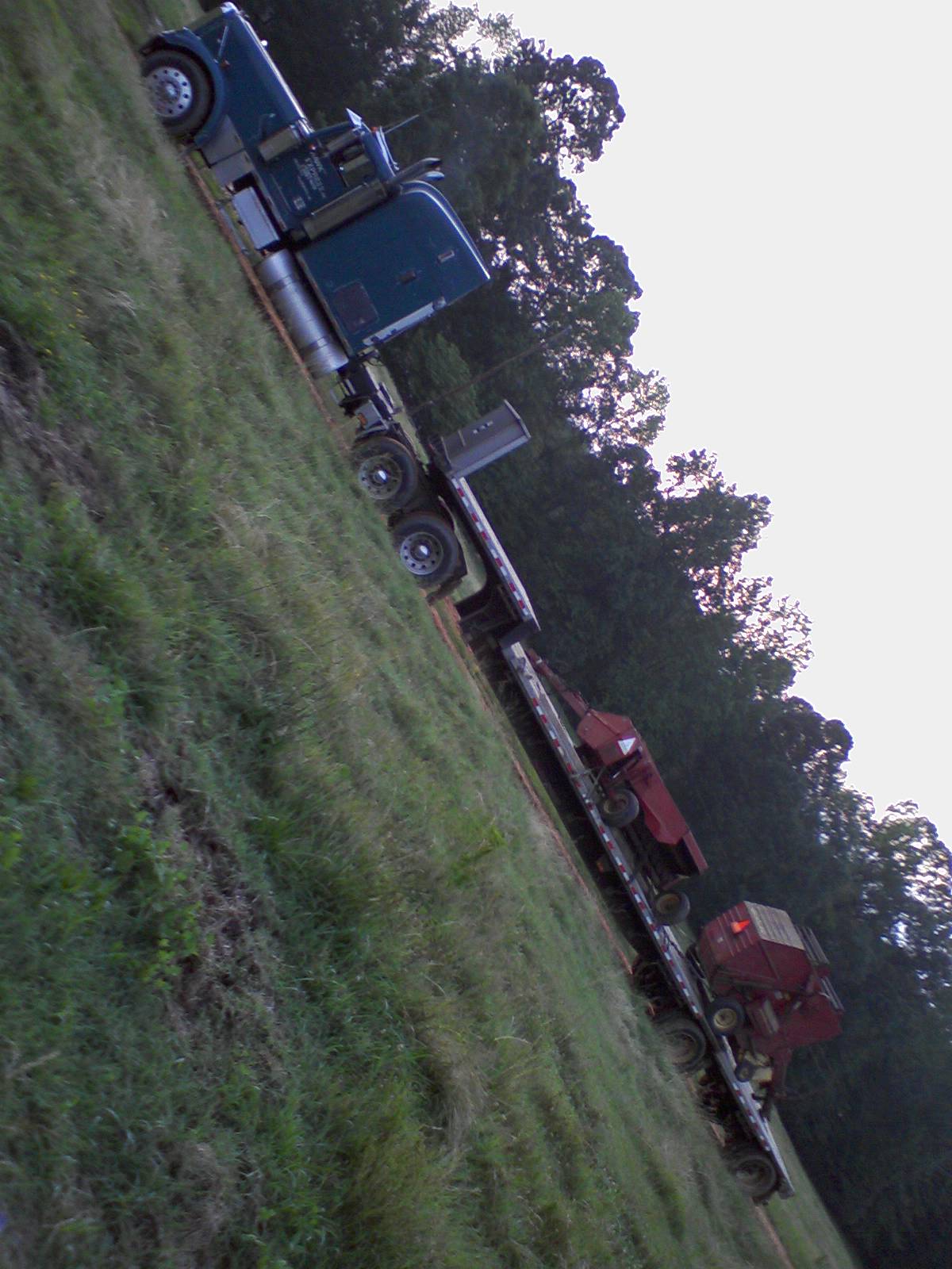

What size trailer do you have? It does indeed sounds like an easy job to remove the tongue. However, after several hours of trying to remove the tongue off of my NH492 when I moved it from my uncle's farm to mine, we finally decided to just angle it on the trailer and get on down the road. It was a little over a hundred miles. There was some over-hang. Though close, we did not exceed 10' and definitely were well within 12'. We hung a red flag on the tongue and were homeward bound. The 489 should have a few inches on the 492, so it should actually fit better with less over-hang. We brought this load off the farm through a goat trail, down some back country roads (1-lane), through town, over state roads, and up I-95 without any issues. One thing I didn't realize is just how heavy this piece of equipment was until we tried to get it up on the trailer. But, that is another story...:confused2:
Good luck!
Hawk

That could be. I was just making an assumption. Like you, I did not have a manual at the time. Is your trailer a deck over? If so, load from the side. The drop deck we were using definitely came in handy. To load and unload, we just placed some boards off the side and backed it onto the trailer, anchored one wheel in place, and swung the haybine around until we positioned as much of it as possible on the trailer as we could. That sounds a whole lot easier than it actually is (you can never have too many chains, straps, and load binders :laughing:). And, it is definitely a 2-3 person job. Fortunately, there are banks on both my uncle's farm and my place high enough to be almost level with the trailer.
I'd be interested in hearing how it goes for you.
Hawk
